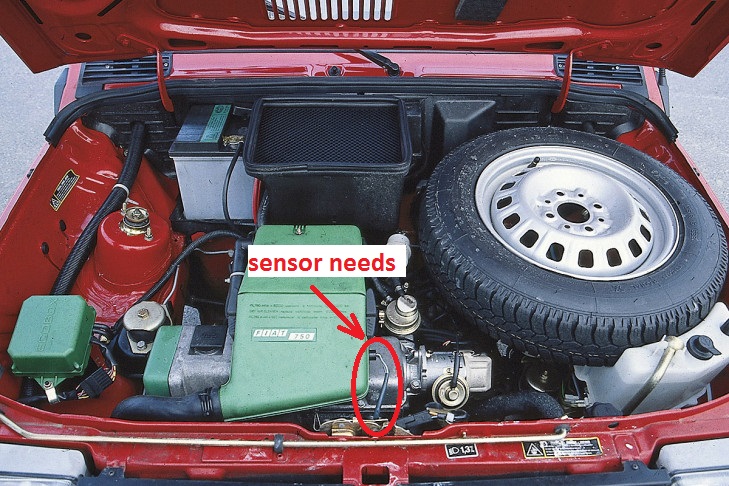

Thank you for the answers Both of you! :) I replaced all the seals, all the mebrans and cleaned up all the carburator, but nothing :( I replaced the ignition cap, the ignition coils, the plugs, the rotor and the transformator too, but the problem is the same. :( My intake air temperature sensor needs to be changed, but can't find anywhere :S And I have some Vacuum connections and some electric connetction I don't know :S Could you please help with them? :S

We never had the EcoBox in the UK as far as I know so I think most of us will be a little lost with that. If it's causing the problems and parts are not obtainable I would say to remove it completely if possible.
Block up any vacuum pipes left by it and disconnect any electrical connectors, then with any luck the carb will work as if the EcoBox has never been there.

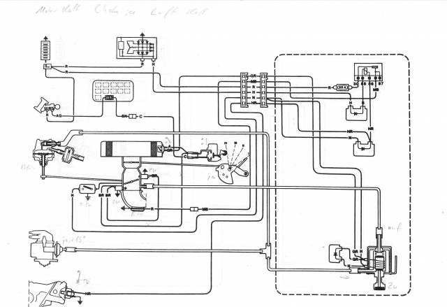

ecobox is shown on right half of the drawing
Table below gives you all info of how individual functions and parts works

I can not help Iam afraid. Though I had ecobox with 1.0 engine I didn't make it work right and finally I had removed it{ ecobox carb and ecobox box :)} and replaced with 1.0 carb from the car without ecobox. Only removing the ecobox and pluggng all the vacuum lines is not going to cure the problem, the ecobox carb itself is designed/jeted as a part of the system, and without the rest of the ecobox the car will probably work reasonably only with hot engine{ mne did}. Cold will run rough{ to lean, not enough fuel through advance pump etc}.
MHO the only good thing about ecobox was the cut off fuel switch when decelerating, saved fuel like injected pandas, the rest of the ecobox was crappy crap crap.
i was about to say.. it looks just like a system designed to cut the fuel off when the vacuum goes under a given negative pressure.
my guess is that your 750 has a CAT converter in the exhaust pipe?
this is a lot like the system that is on the Marbella's 903cc engine.. only not ECU controlled.
you have to be careful with the carb swap mod on a car with a cat converter as over ran fuel will poison the cat and cause emission problems in the future.
my guess as to what has happened with yours is the little "switch" that detects when you are coasting, has failed in some way. the only way i can see how it would work is some kind of switch that detects when the throttle is closed, then something to detect when the vacuum pulls a given amount.
without actually getting my hands on it, i cant really think of a way to fix it. other than just swap the carb over as said.. then worry about the emissions when the time comes.
you may also be able to wire it up to a manual switch you could.. say put on the gear stick.. when you coast you can just press the switch in, then that will cut fuel to the engine.
