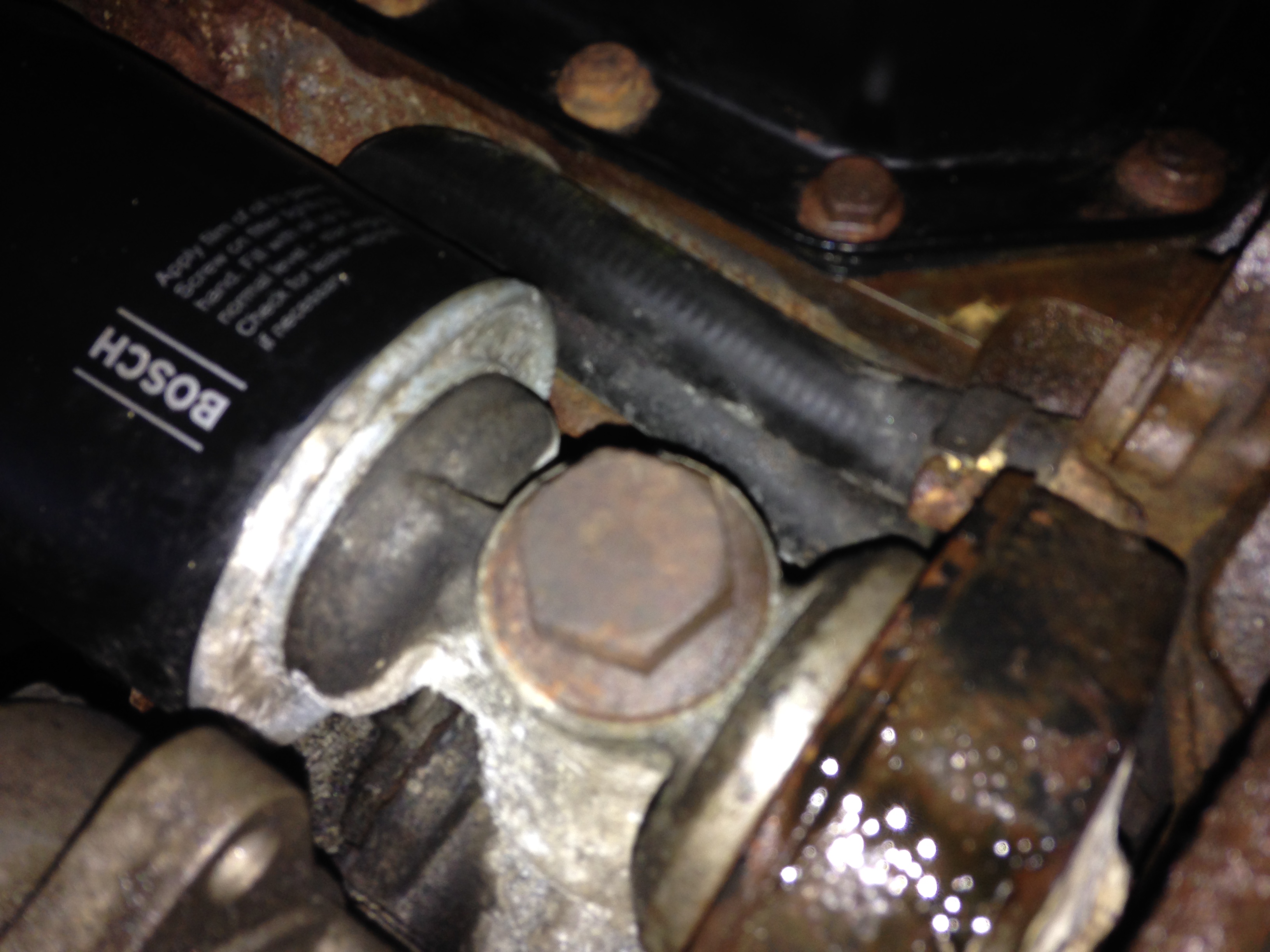

I have a 2.8JTD (with Aircon) 244 Fiat Ducato Hymer 2003.
I have developed a bad oil leak when the engine is running through a very corroded Oil System part/Cover. It may be classed as part of the Oil Filter Housing or Oil Filter Mounting Cover but i am not sure.
I am trying to find out the correct Name for the Part and source a replacement.

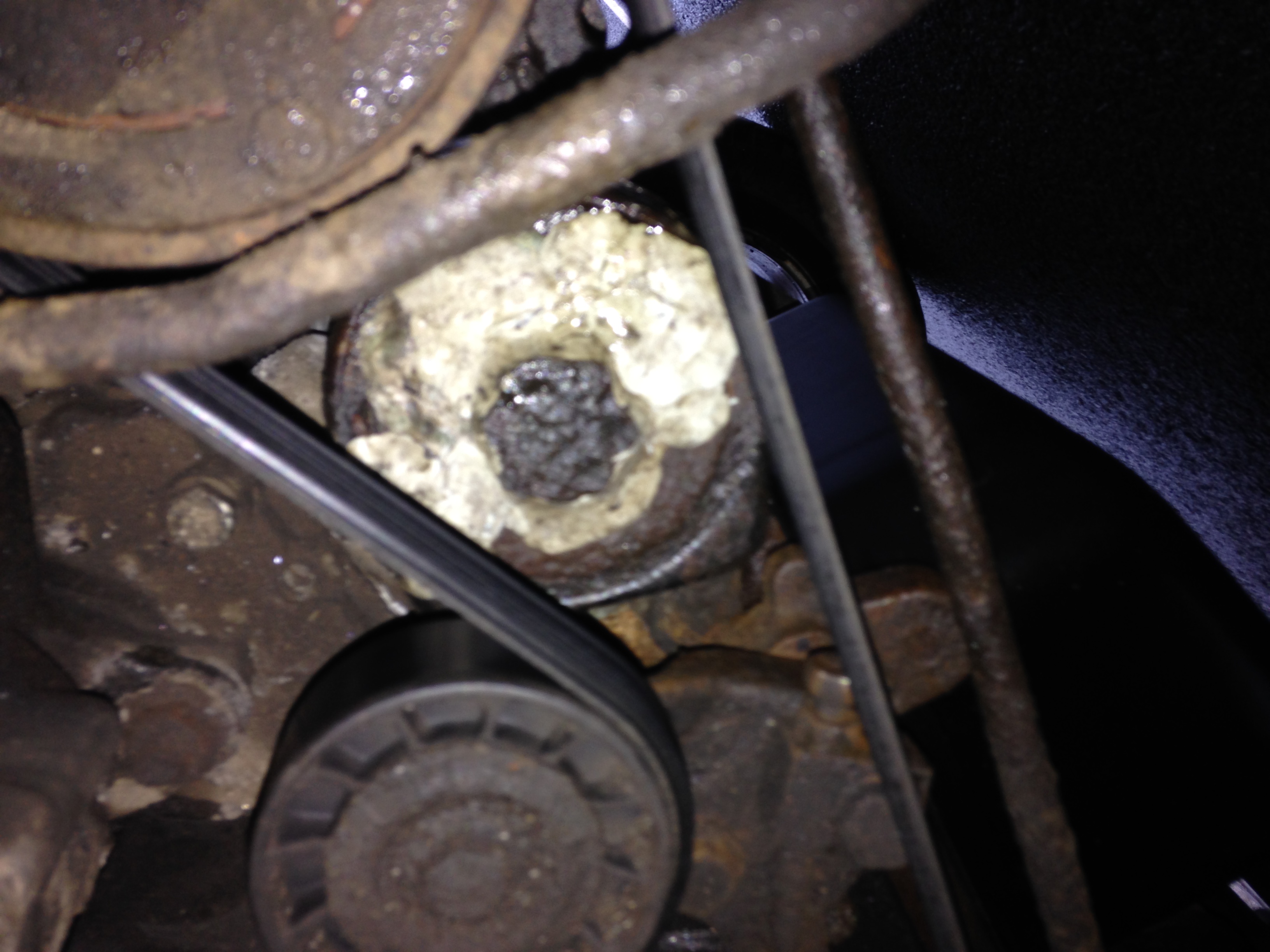

The leak is on the opposite side/face to where the Oil Filter attaches. The leak is next to a big bolt head that I presume might be the bolt that holds the oil filter in place.
I made an emergency repair with Pro Weld Cold Welding Compound to finish my journey (as seen in the Photo) but it is still leaking.
Any informed / sensible answers are appreciated.

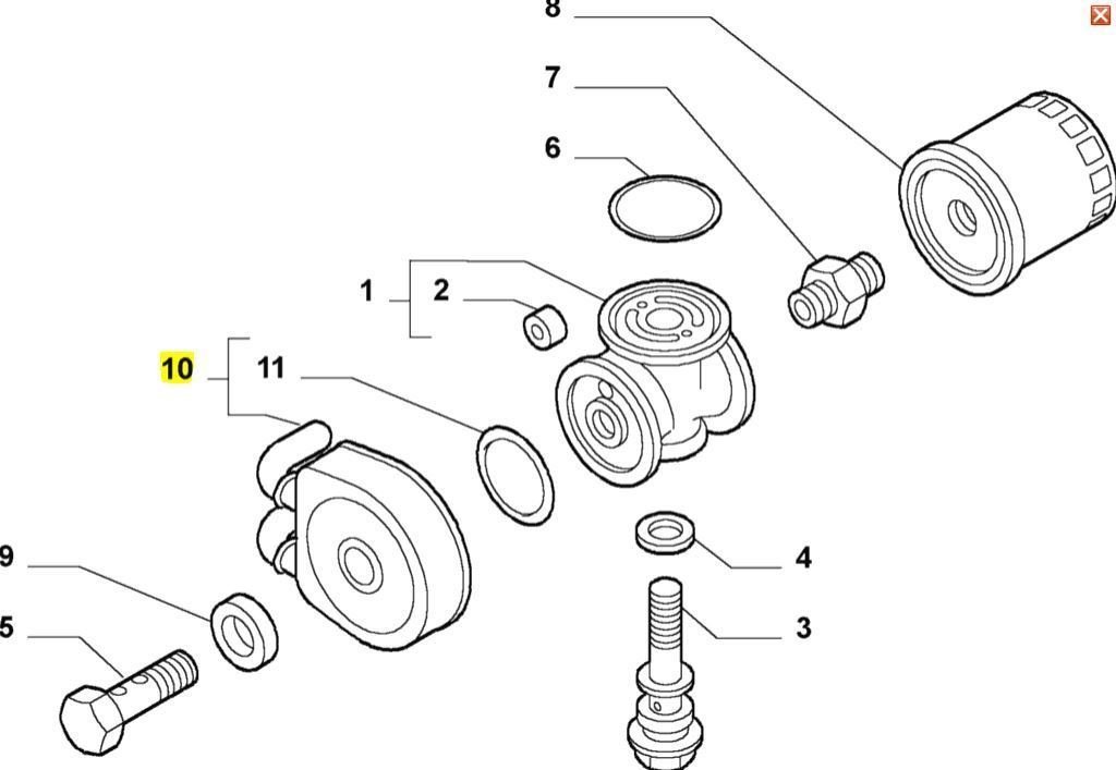

RayC Sir you are a star, even if i nearly spat my coffee out at the price !!!
£80 on amazon free delivery also worth checking price with iveco / citroen as tgey can be very cheap for some parts
