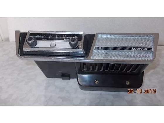

The period radio setup had a bracket under the dash with the speaker mounted in it behind a cover - mono only
lovely....

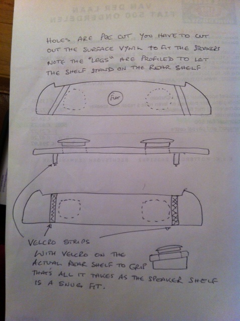

Hi Tim
I have attached some details on the shelf, I have it fitted on the rear metal shelf with nothing more than velcro on the stands which are part of the shelf. There is no cutting or drilling required as the shelf unit is quite snug. The shelf also has the speaker hoes cut, you just trim out the vinyl surface and slot the speakers in. These are secured to the board with four screws. The shelf is made of wood. Hope my drawing helps?

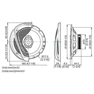

I'll have to get the speaker model later as the only document I have in the file is the warranty which doesn't give the model details, (generic form). The shelf came from Van der laan and it is shown under the Abarth section 'Tuning' interior. I am not sure the speakers are still available but the model number will give me a spec sheet which you can use to find similar dimension items, I'll send that when I get the details.
Hi Tim
The strap is still in situ and connects up fine, there's plenty of space between the shelf and the strap mount. The shelf does not sit on the seat back and it will pull down with no problem.

Hi Tim
Here's a a drawing of the speakers, this is representative of the shallow depth of them. I am not sure this model is still available but the depth dimension is the main factor. Once you get the speaker shelf you can get the overall diameter of the cut out for the speaker dimensions ok?
