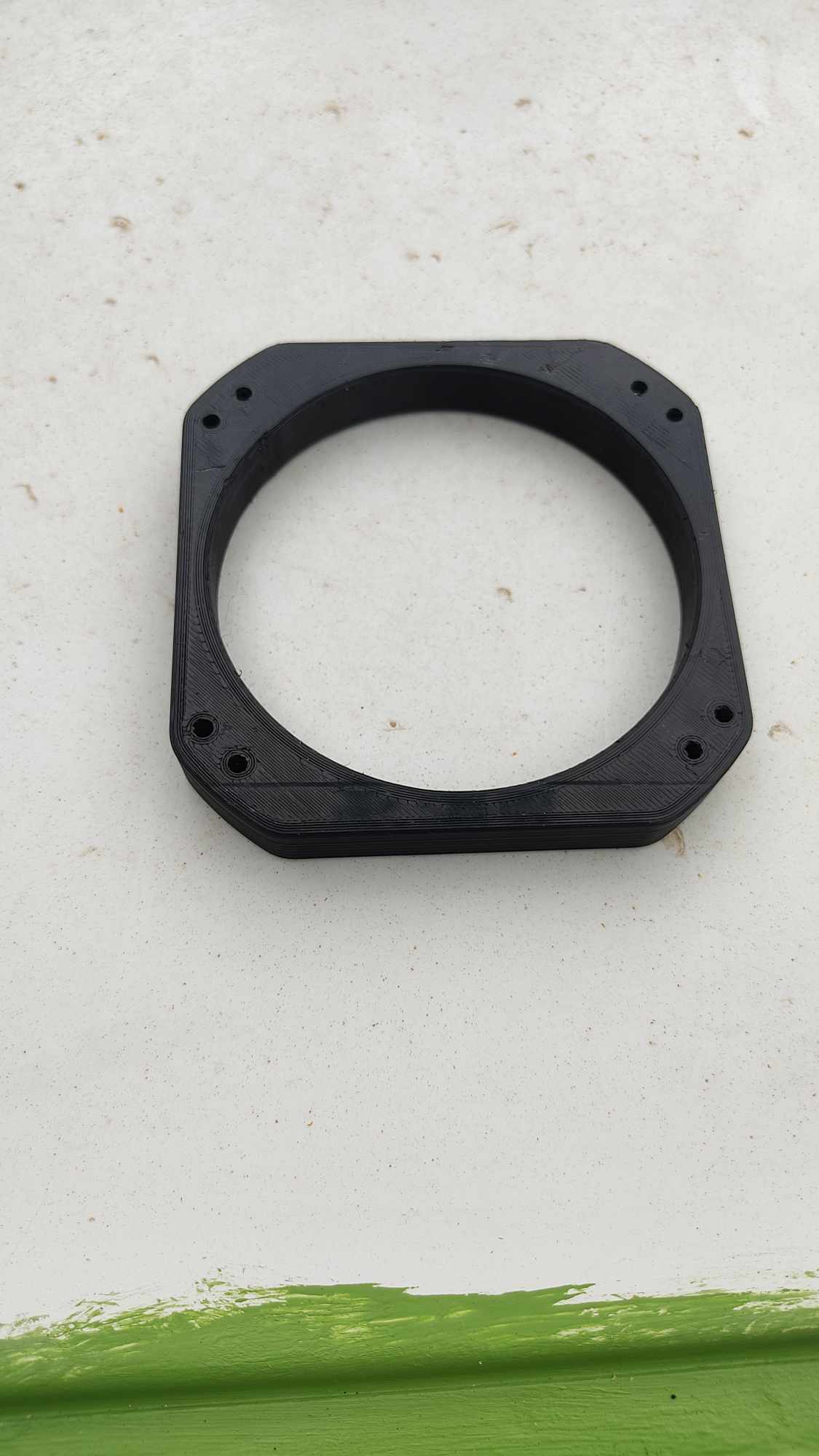

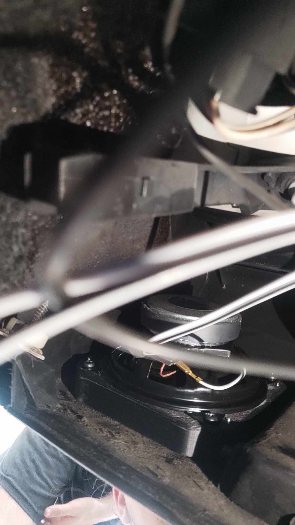

So I bought a pair of new Pioneer TS-G1030F speakers for the Uno, but the tweeter section stuck out by around 12mm, which made mounting to the dashboard impossible. The bolt pattern on the dashboard was also incompatible with my speakers.
Also, some time ago I experienced a broken lever that controls the heater matrix valve, so I asked my mate to design and print me both a pair of spacers for the speakers, and some replacement levers.
I'm uploading the STL files so that everyone can 3D print these parts as per google drive link below. We recommend printing with temperature resistant ABS plastic.
