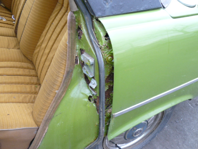

Oh & I had a P6 as well, a 1975 2200 in burgandy. Not fast, but felt very nice to be in. I also had an 86 2600 Vanden Plas auto in moonraker blue which I loved.
P6`s rust rather well too dont they... (no, its not mine!)
