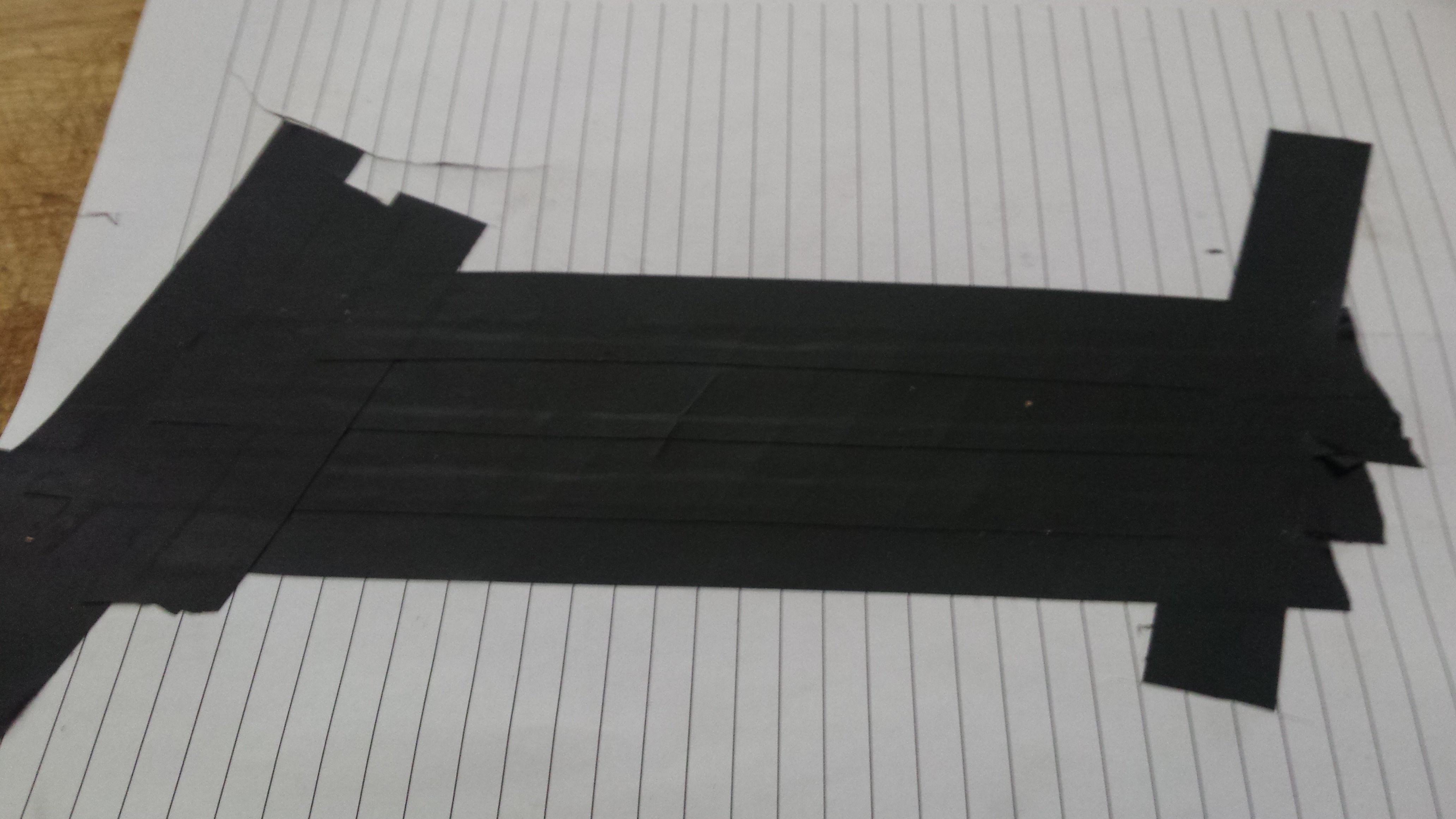

Start by sketching the design, remember that any text should be done in mirror view.
Flip the design over and cover the design with electrical tape.

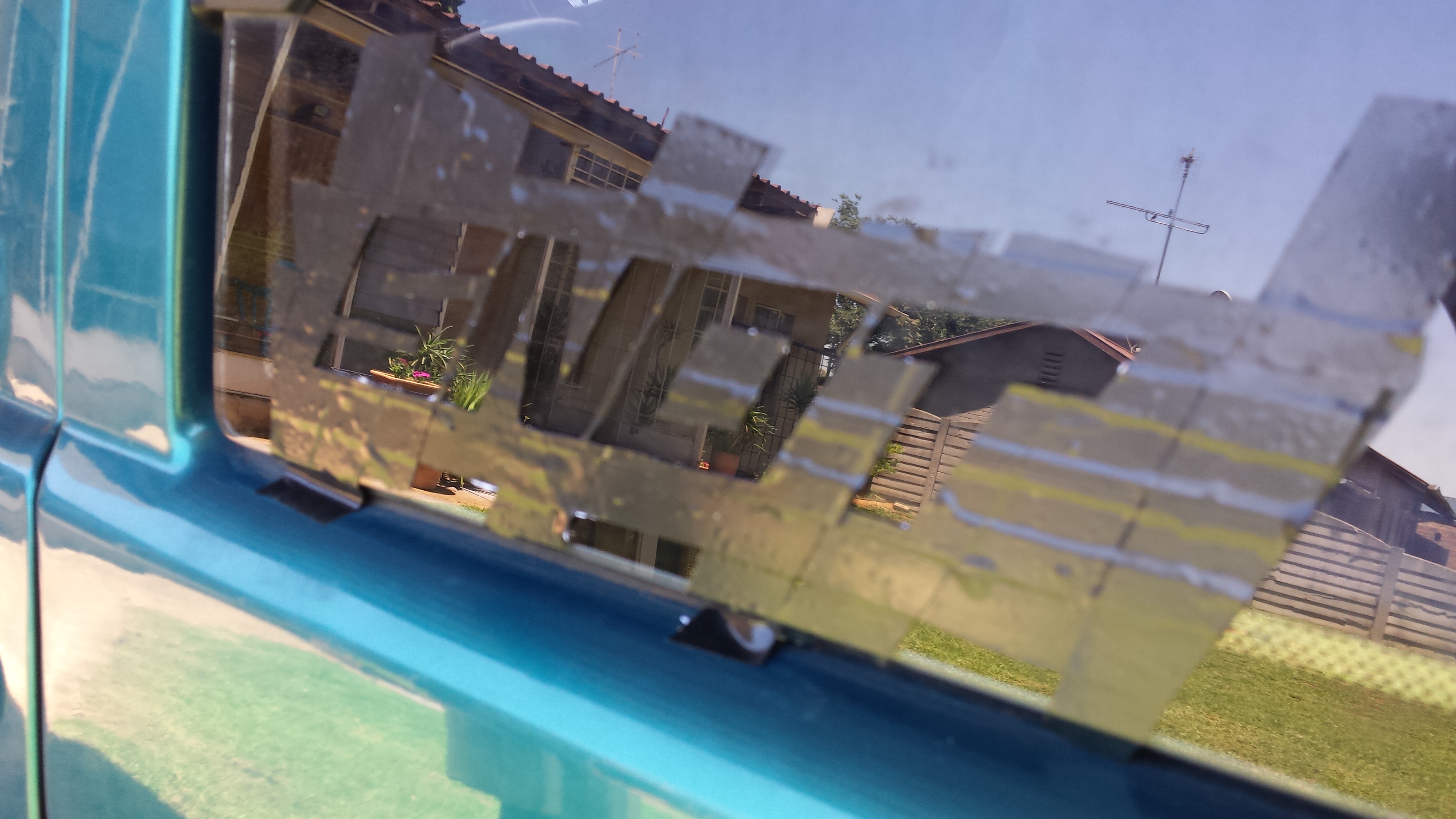

I used a hobby knife to make a cut-out of my design. Remove the paper and position and stick the design on the window of your choice

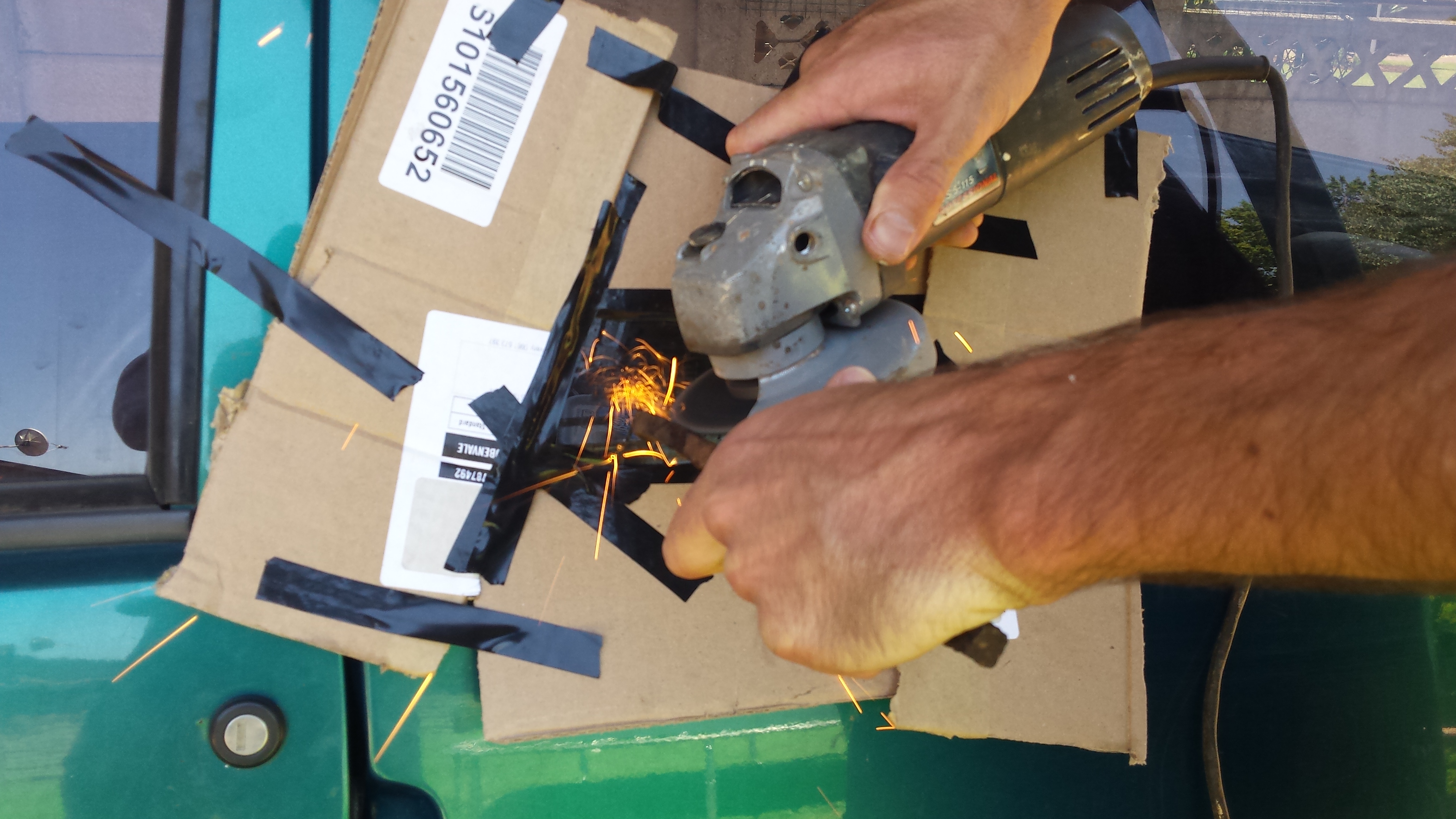

Mask off the area. I used more tape and cardboard
Now for the dangerous part, gloves might be a good idea. Use a grinder and a piece of scrap iron and blast your design with sparks. I don't know why the sparks stick to the window, could someone explain? Continue until the exposed glass looks like fine sandpaper

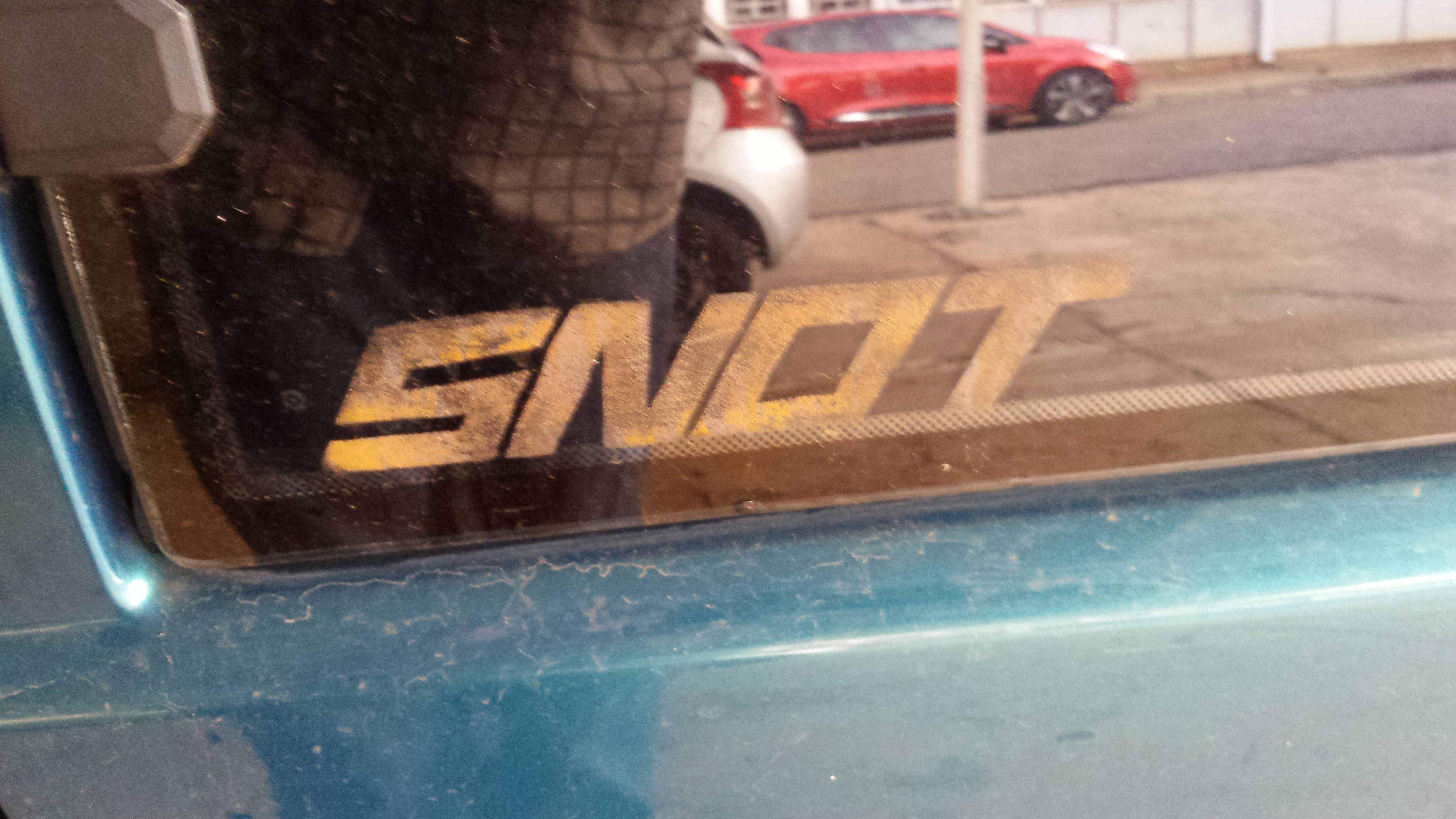

I removed the tape from the window... oops.... I wanted the brown look from the tv show... this is grey...
But metal RUST, even little metal sparks
. Nice One!!
.Now for the dangerous part, gloves might be a good idea. Use a grinder and a piece of scrap iron and blast your design with sparks. I don't know why the sparks stick to the window, could someone explain? Continue until the exposed glass looks like fine sandpaper
