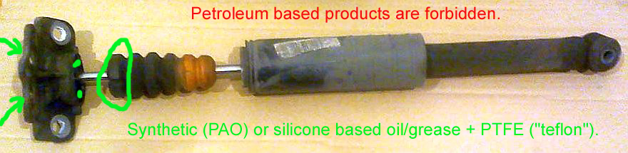

One mentioned in the eLearn service news (and workshop software like AutoData) about 15 years ago...
https://aftersales.fiat.com/elearnsections/main.aspx?nodeID=199001965&languageID=2&markID=1&modelID=199000000&valID=199000001&prodID=199000000&modelName=Fiat - 199 - Grande Punto&langDesc=English&sectionName=Service News&validityName=1.4 8v
You don't have to remove the mounts, just lift the rear, slide down the boot and spray some silicone/teflon there.
Dry/wet version of the lube, doesn't matter much.
That is a good one. I will do this.

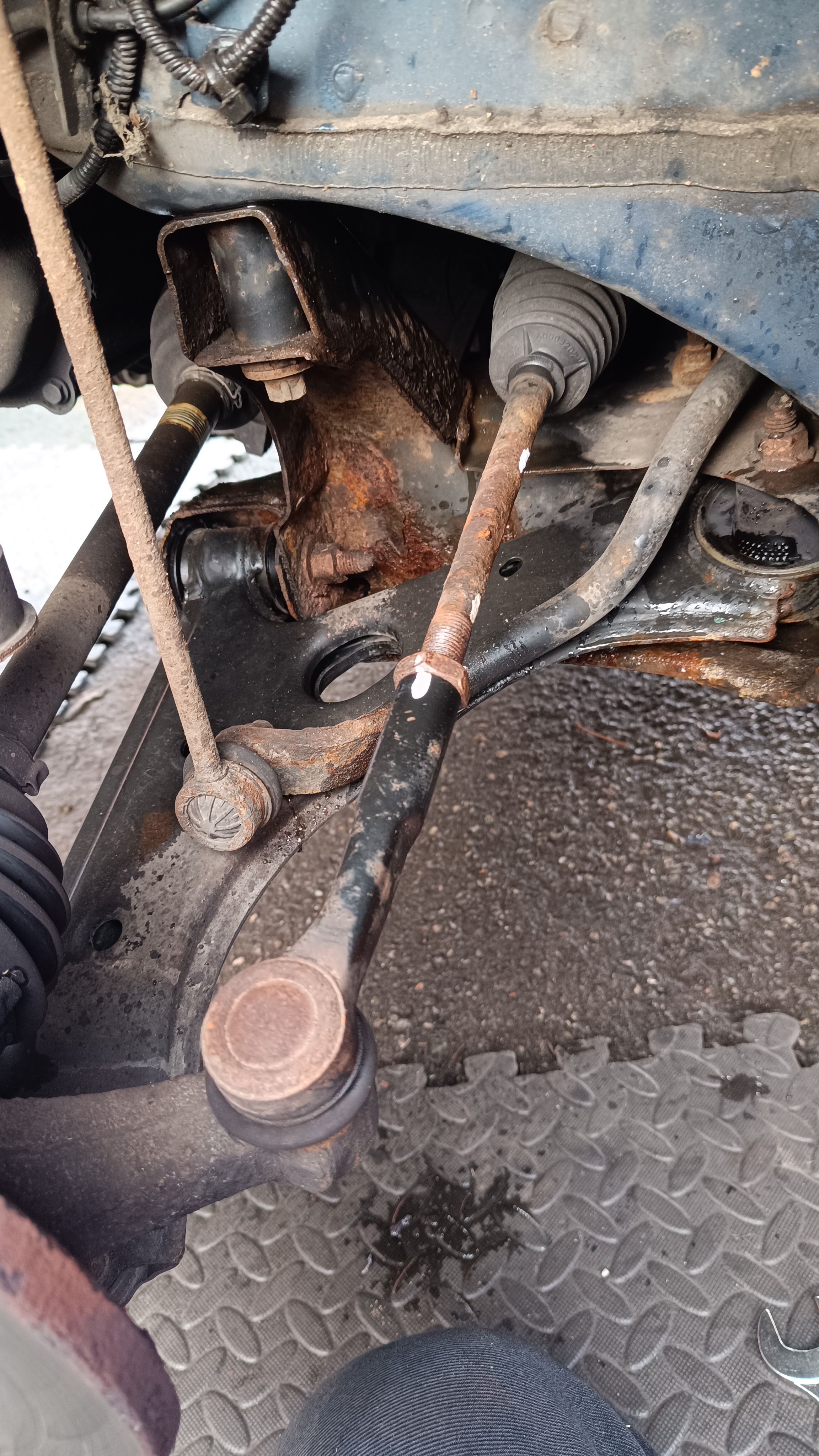

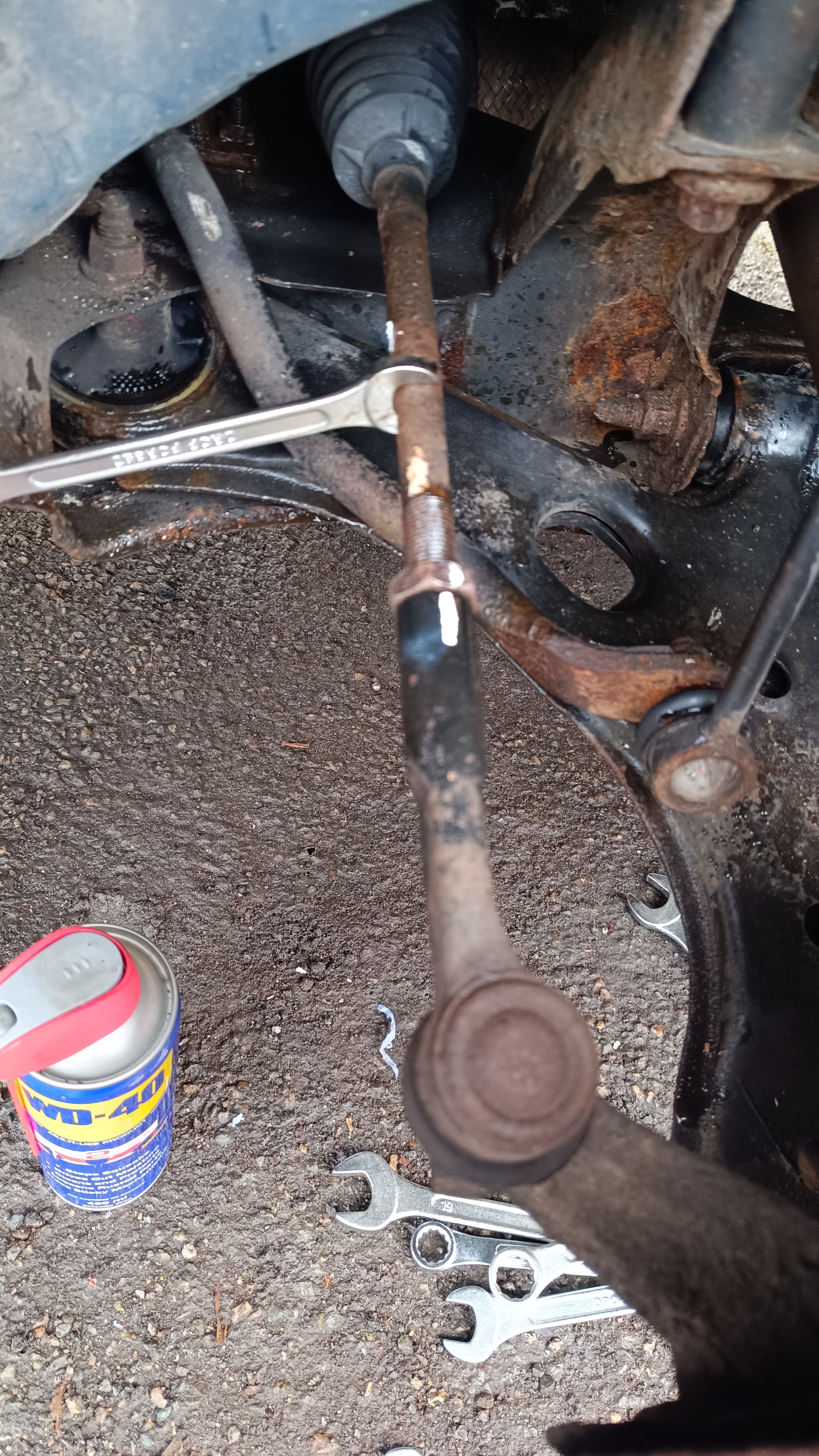

I took a look at the tyre wear on the front and there is a little more on the outside than the inside, its nothing major, but i'll need to tweak that. I've been checking the tyres regularly but hadn't compared the inside to the outside with the gauge i recently bought. Just thinking now...it started raining so i went to buy a can of Monster and waiting for that to kick in :)
I've just adjusted the tie rod ends to try to get the steering straight. I think as the wheel tugged to the right then i needed to turn the steering to the right.
I took some pictures so i can put it back if that happens to be wrong.
This is the nearside, i marked it with tippex and turned it one quarter to the back of the car, which should turn the steering right.
This is the offside, i turned it one quarter to the back of the car, which should be turning the steering right.
I've decided not to address the toe out at this time, its complicating matters too much!
I'll get this on the ground and take it for a drive now...:)

Greased the bump stops on the rear shocks, but its still creaking. I could try new bump stops.

I decided to try some silicone grease on the rear shocks and it worked! Happy days :)
