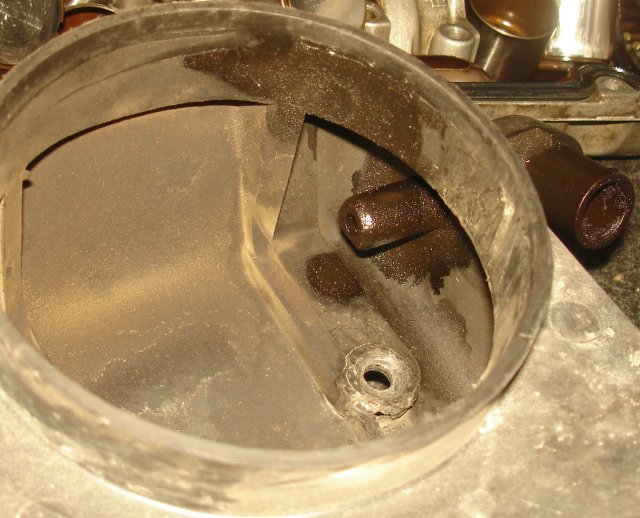

Here's how it looks with air box off (before I took it apart again).

When I took it apart the first time inner side of the airbox was quite oily, so I cleaned it up. I checked it's current state and it's oily again as you can see in the pic. And that's after few test runs of the engine. Also inlet manifold walls are all oily (n). Also lately I noticed increased oil consumption which is another sign of worn rings :bang:.
