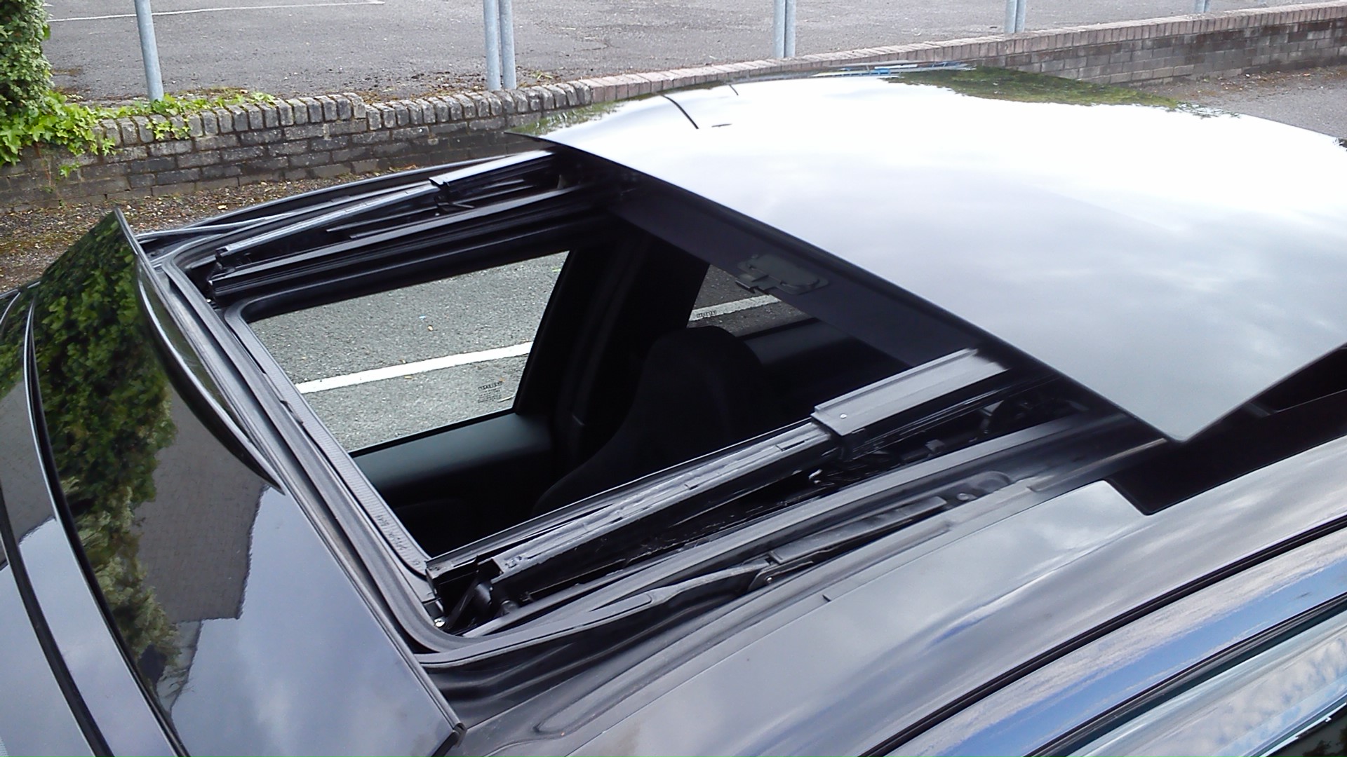

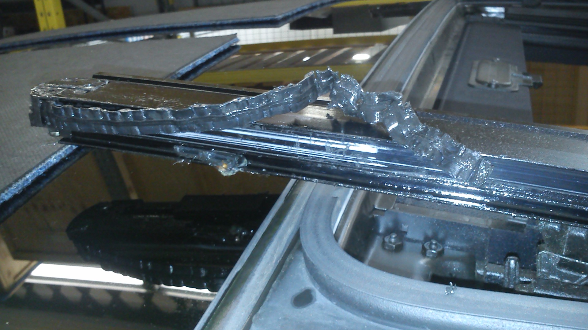

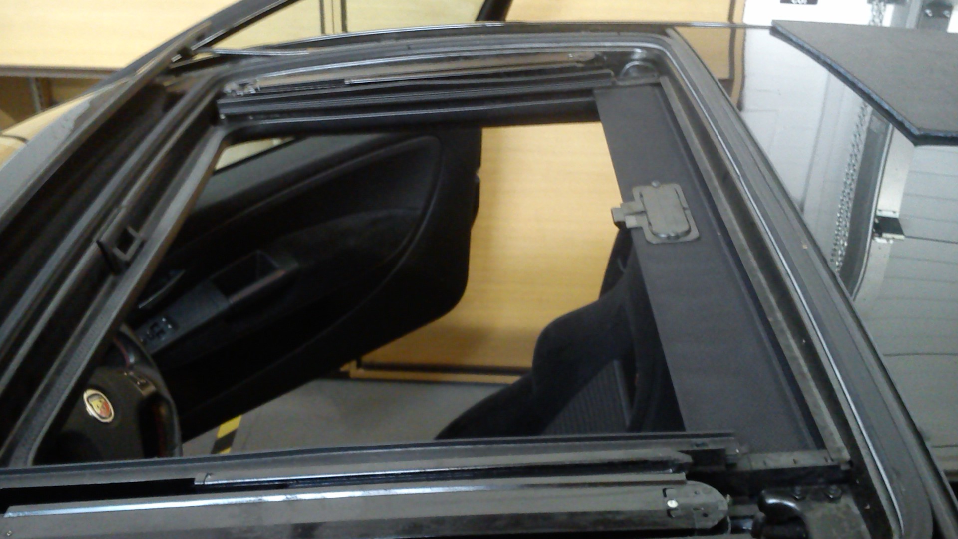

Ok, sourced some replacement sunroof mechanisms from a breakers up North.
£80 - damn site better than £350 per mech + fitting from Fiat!
So it took me all day and i dont have much skin left on my knuckles but it was worth it, the sunroof works like a dream now.
I did intend to takes lots of pics and do a guide, but to be honest once things got complicated and i had the inside of my car in pieces, all thoughts of that went out the window!:D

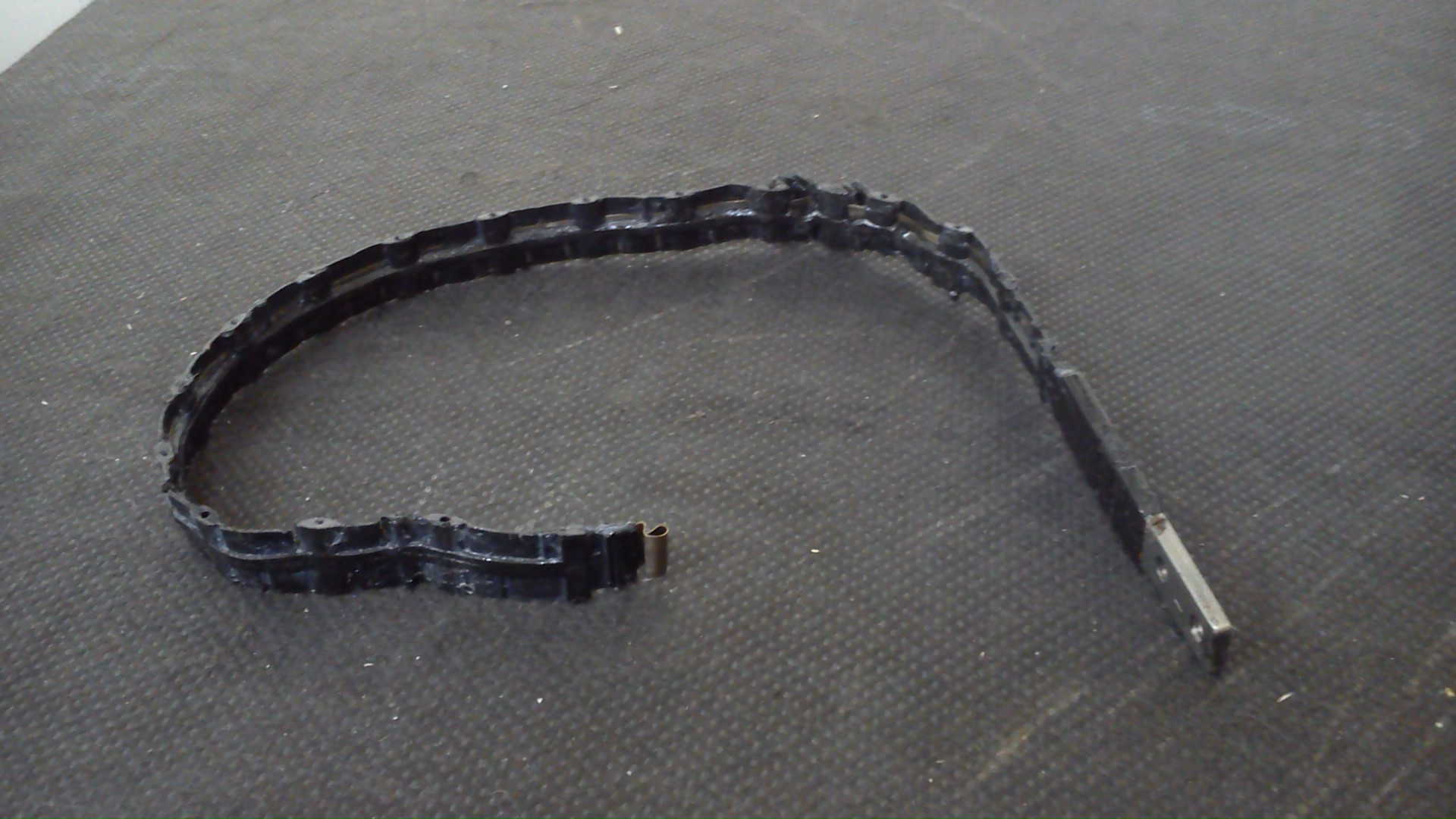

The ribbons that drive it are ridiculous, mine were mangled and one was snapped right off.

Nice work mate! My ribbons had just snapped straight off and weren't nearly as mangled, though I'm sure given time they'd have ended up the same way... or worse just let the roof sail into the car behind! If I were Fiat I'd be giving Webasto a good kicking over the shoddy quality prone-to-breakages roof... although maybe that was the plan all along :rolleyes:
