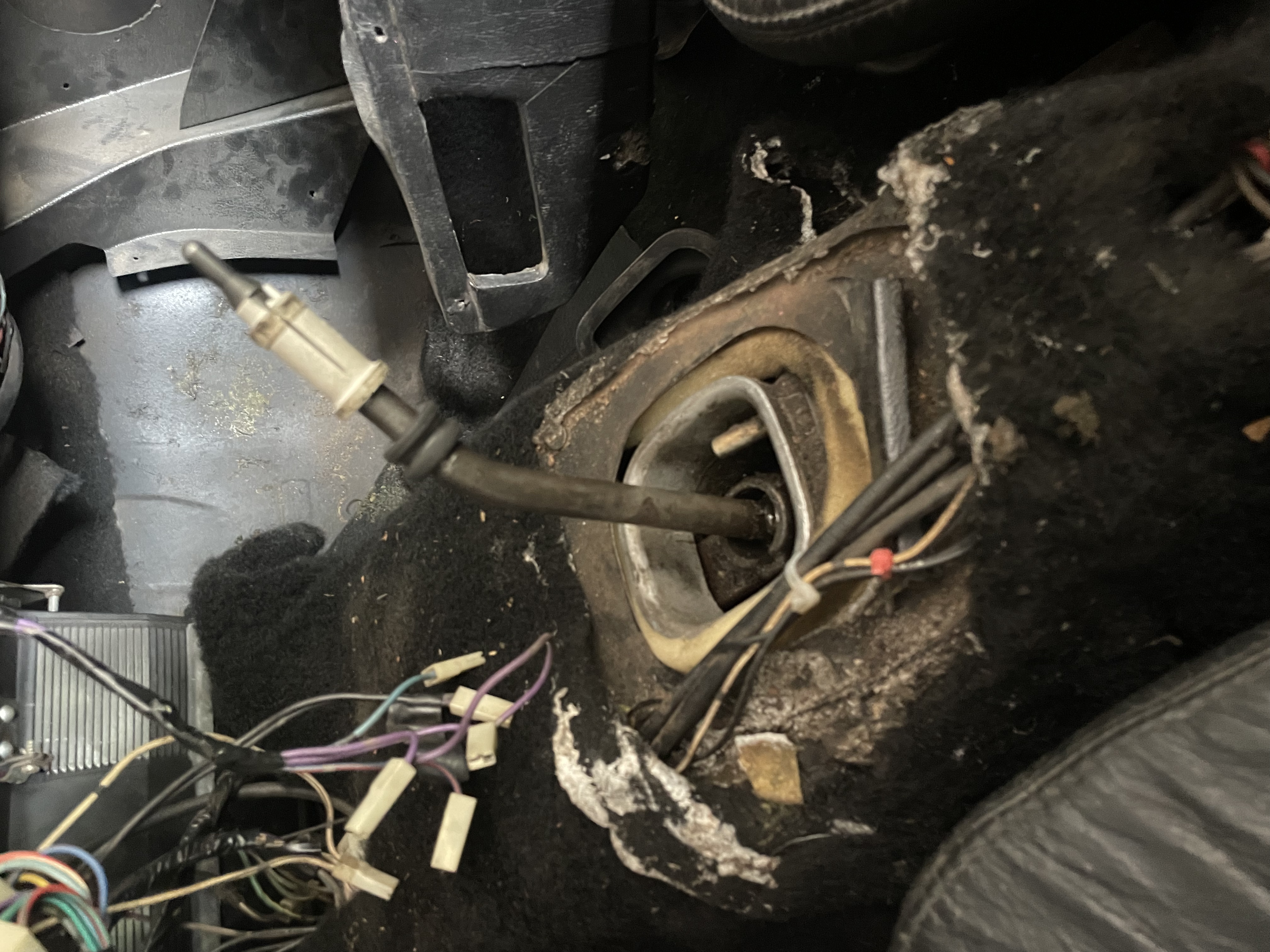

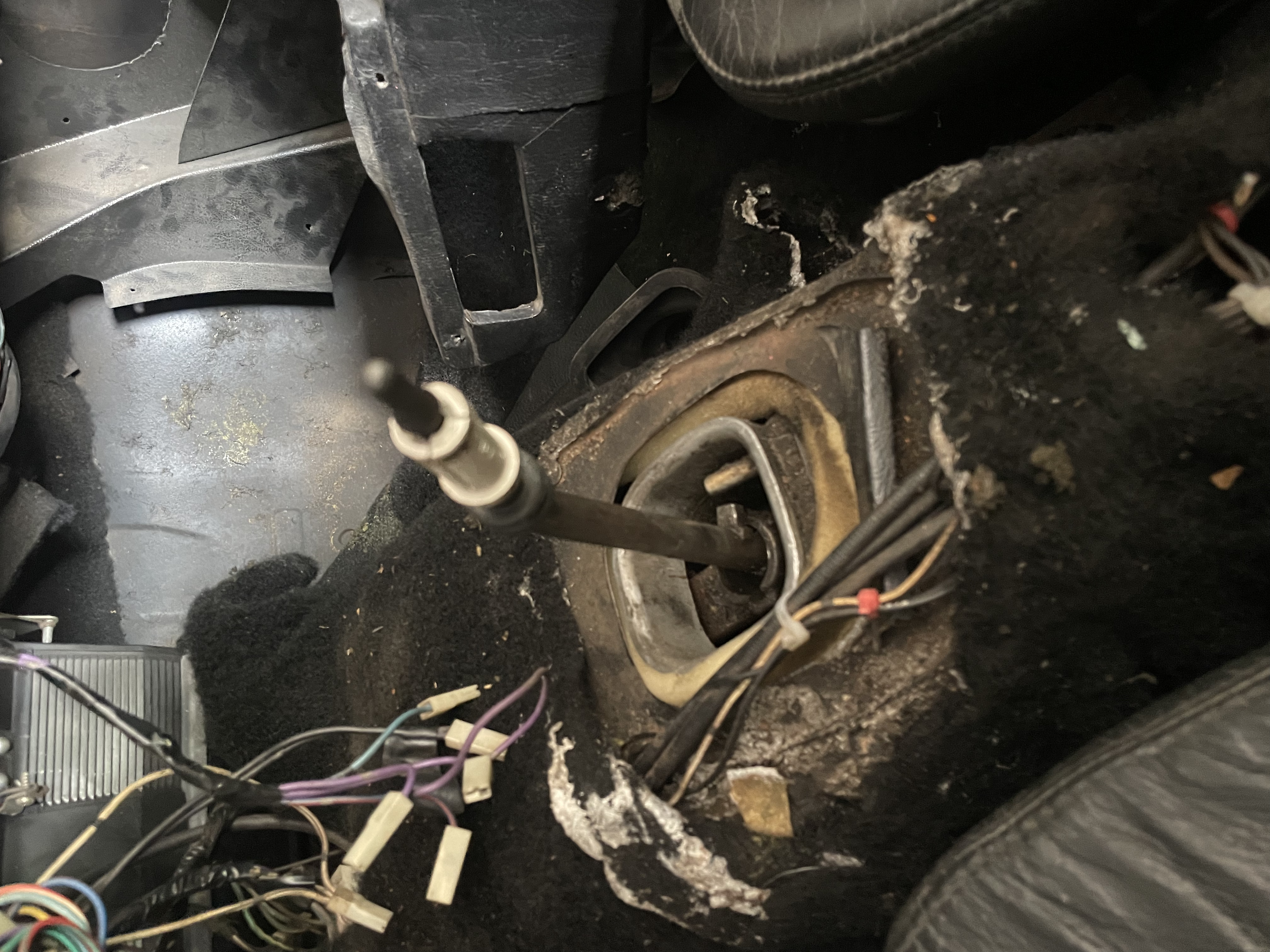

Hello, I am new to the community and just picked up a 1978 124 sport 1800. The shifter was working okay and then out of no where I was able to rotate it. Not the top part, the bottom. I'll attach photos, any help is appreciated. Maybe just a bushing?

SOLVED: So the shifter that was installed in the car had broken the circular "sphere" that goes around the shifter. This meant that there was much play in between the shifter and the linkage, as well as making it near impossible for the spring to tension the shifter. I will post some pictures so that anyone experiencing the same issues can learn from my troubles. I had purchased a new shifter for $60, so not too expensive of a repair, took me about 20 minutes to replace it. Hope this helps!!
