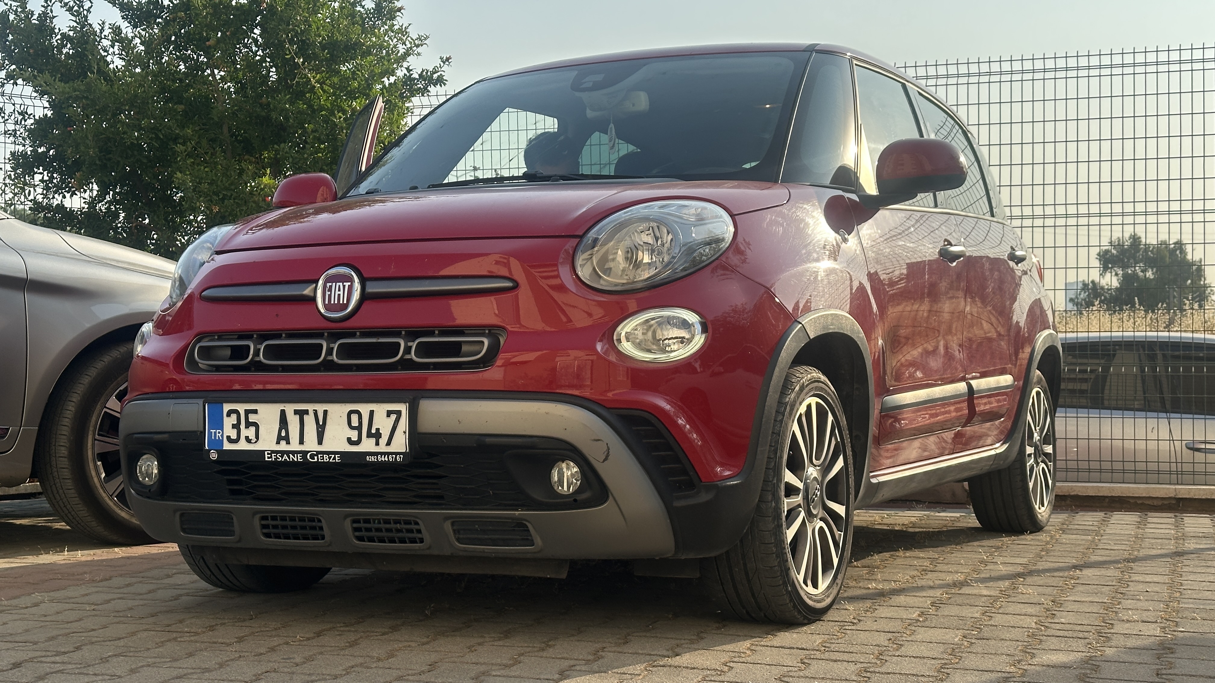

Hello everyone. I’m Berkcan from Türkiye and this is my new 500L. ‘ve buy it this week. The car is shaking sometimes while first acceleration and especially when the steering wheel is turned. The other and the major problem sometimes car stalling when I slow down almost to a stop and want to move again, or in similar situations. It happened 2 or 3 times. I tried the disable startnstop and car does not work, I had to turn the car off and start it again.
The car on 49.500 KM odo. Just i know the robot changed by Fiat offically service near 3 months ago. It still has mechanic warranty about 1.5 year But I wonder what causes the problem and I don't trust the services very much.
Model
500L Cross
Year
2020
Mileage
49500
