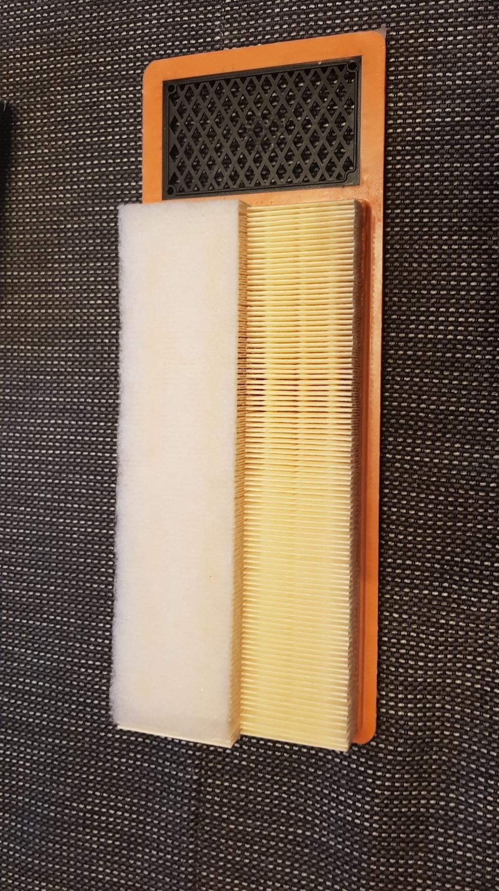

The air filter I am talking about is the Mann C 36 006/1.
Notice how there is a black plastic grill at the top.

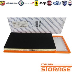

Now look at the original OEM spec (made in Italy).
Similar but different intake material in the top outlet where the air goes into the system after filtration.
