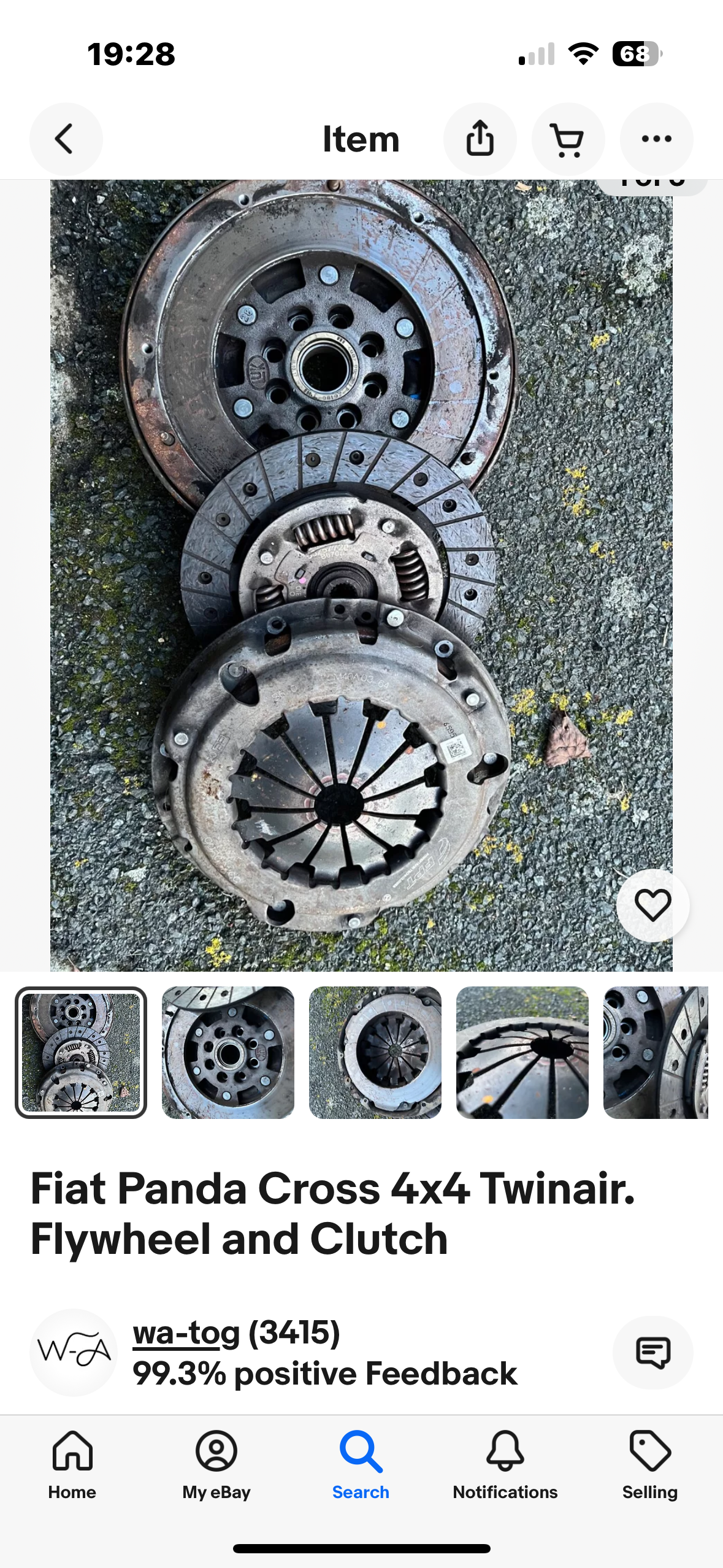

B Big gerry Member Parked in the garage Joined Mar 1, 2023 Messages 227 Points 137 Location Northern Ireland Nov 28, 2024 #1 Seen this on eBay for sale just in case anyone out there is in need of one Attachments IMG_2716.png 4.1 MB · Views: 354
J jackwhoo Distinguished member Joined Apr 8, 2017 Messages 7,489 Points 1,746 Nov 28, 2024 #2 Pressure plate fingers very worn , stay away
P Panda IIs Established member Written a review Joined Sep 21, 2017 Messages 976 Points 315 Nov 29, 2024 #3 jackwhoo said: Pressure plate fingers very worn , stay away Click to expand... I agree, looks horrible plus the flywheel (DMF?) is a different brand from the pressure plate so someone has been in there before...
