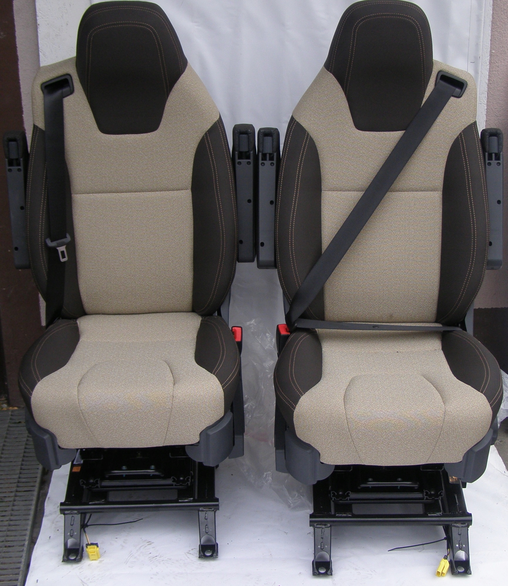

I know there are very comfortable (comparing to the original seats) original FIAT camper seats available on the market. They fit perfectly and work perfectly with the van security systems ;) They are out of my budget though :(
There are also pneumatic bases available for the original seats :)
