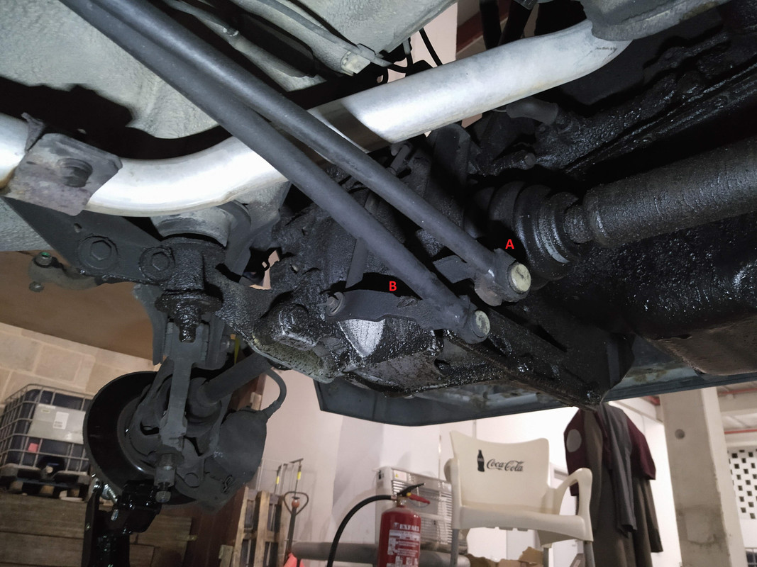

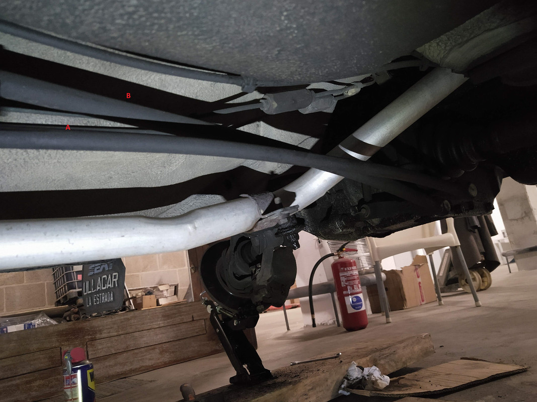

I am sorry to go back to the old thread but I have some doubts about it since I am in a reconversion phase.
I start from a Panda Mk1 40 with 4 speed transmission and 903cc engine.
I have a fire 1.2 60hp engine with all the supports of a panda 4x4, 4x4 141 box, 4x4 transmission and 4x4 rear axle.
I understand from what little I have been reading that more or less everything fits well except what you say, adapt new holes for the engine and box supports (I do not know if the support that goes under the feet of the pilot (eu spec) or co-pilot (uk spec) is valid for the 4x4 box or I have to adapt.
Is the original gearbox linkage of my panda suitable for the 4x4 gearbox?
Any other tips you can think of for the conversion?
