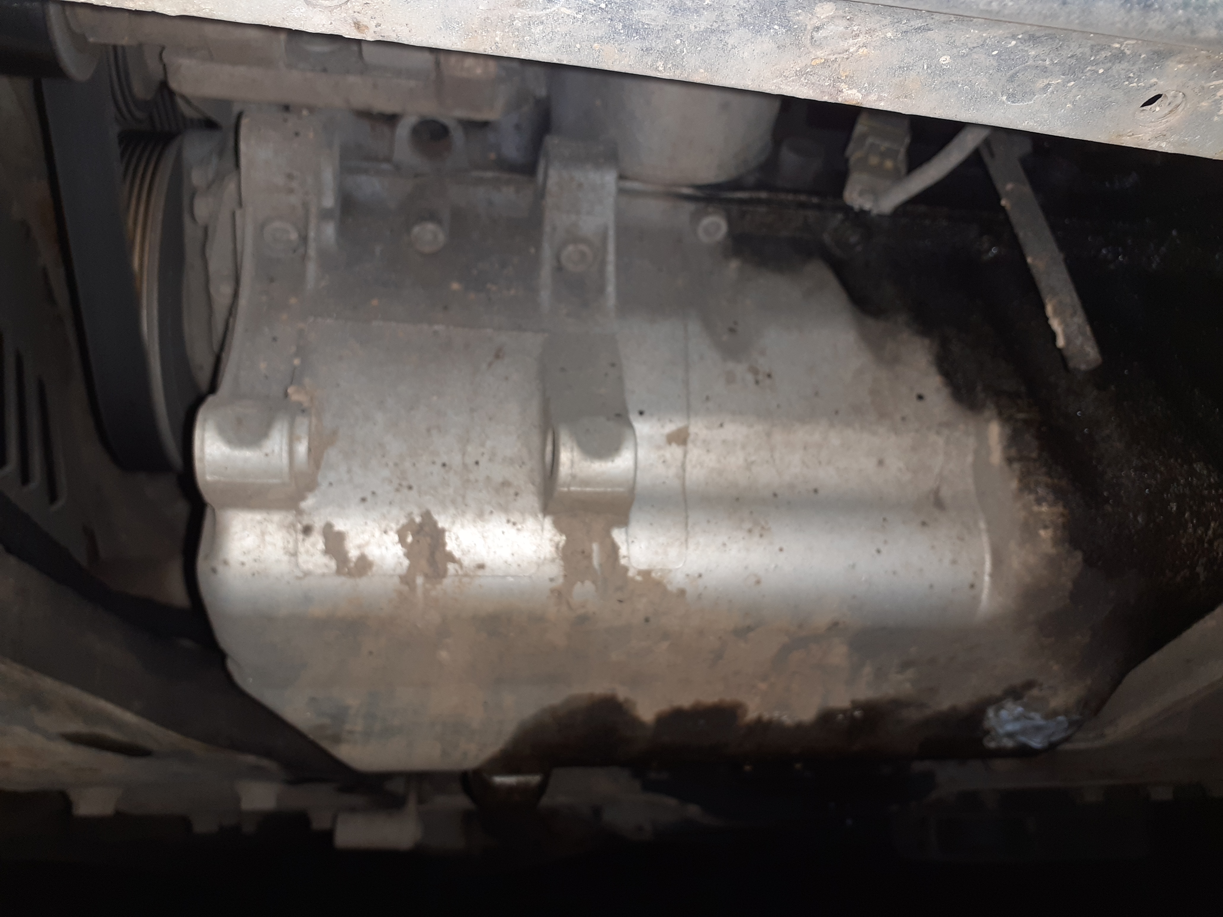

Hi everyone I wonder if you can help me please, I have a scudo 2006 2.0 jtd 109hp 220 Dynamic SX van and I am having real trouble getting a sump replacement, all the sumps advertised to fit are not deep enough. The pickup for the oil pump stops it from fitting and it seems to need a deeper sump. Is this something anyone is familiar with, any suggestions would be appreciated.

Don't know, sorry. However, what's the matter with the one that came off?
Thank you for answering, I have had it welded but being alloy there are hairline cracks all over it and I just want to make sure I have a replacement as I need the van constantly.
Have you tried an online breaker via a middleman (e.g. "1stchoice"? With those pics, and not too much of a tone of desperation, it might be good. Mind you, just the sump might be more difficult that the whole engine... ow!
Can you get someone to cut out a particular cracked area and weld in a plate?
I have the van back on the road so I will start ringing around the breakers for a seized engine and see if I can find one, thanks for the input.
fleabay item num 154287704175 CHECK the numbers on the pics of the sum first, to make sure they match your old tired sump before a possible purchase.
Thank you, very much appreciated. That one is the shallow sump, they say its fits but it doesnt, I dont understand why the deeper sump was used, I can only assume it was to give more oil capacity. It is the oil pump pickup that stops the shallower sump from fitting.
