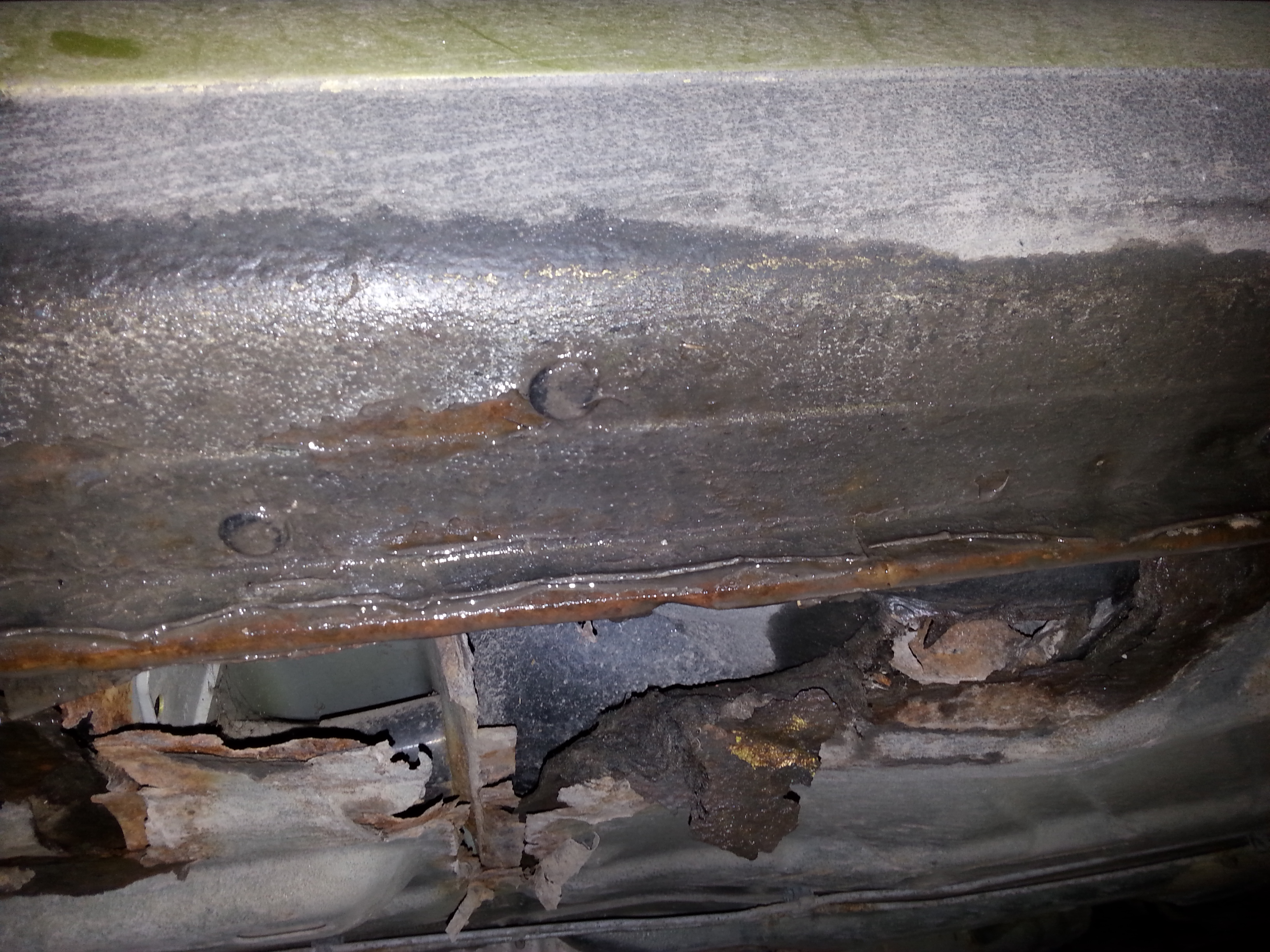

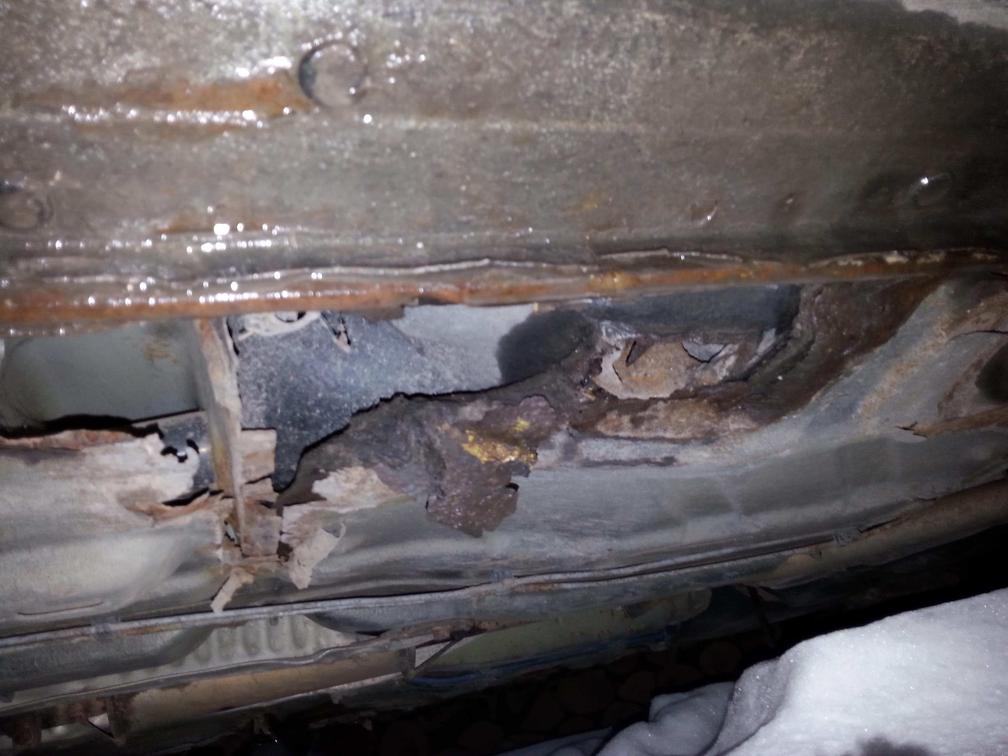

Hi guys, I'm new to this forum.
I am Mario, from Macedonia. So, my dad owns a Punto mk1 SX 75 1.3 8v. It's a family car, but it's 20 years old. It has a lot of rust and holes underneath, if you're sitting in the left back seat and looking in the front seat holders, you can see the road. I have some photos, I think that they would help. So I need help, how can this be fixed? It also has a stratch on the right back side(caused of another car), So I'd want to get those things fixed but my dad doesn't want to spend too much money on it, because he thinks that fixing this car doesn't worth it (you can buy an used punto for about 600-700 euros). Any help would be apperciated.
I just uploaded a video of the holes underneath on YouTube, but I cant post it there because I still don't have enough posts on this forum.
Thanks,
Mario

had similar holes on my mk1, just not that big, shame i didnt take pictures before and after, a guy i know welded everything charged 60 eur, but your job could easily take like 200 eur or more if you take it to someone who you dont know

yea you got some big holes, but they will fail you here if you got only one little hole, which is absurd

That's not so bad. All you need to do is cut an inch wider than the hole to stop rust creeping further back. Make a plate half an inch wider than the hole and lap weld from inside first before lap welding from under the car.
Stripping the interior out will take longer than the job but it's worth doing right.

Actually, it is bad, I can't even lift the car up if I need to change a flat tire. I must find a place that's not rusted and put a piece of wood there, and then I can lift it up. Maybe I can lift it up on the recommended places but it's a 50:50 chance to ruin the chasis.. How much does it cost to buy a whole new chasis? And how much does it cost to give the car to a mechanic and weld the current one? I can't do that myself because I live in a flat and I can't do that in a shared parking..

The lifting is not really a problem but I can't use the factory made places for lifting.. But how can I weld the holes? The whole underneath is rotten (not with holes, but it is just soft if you try to lift the car or weld there) so I can't find a strong place to weld..
