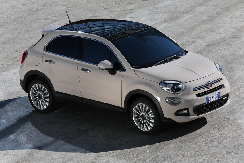

Every body shell is the same on the 500x regardless of whether it has roof rails fitted or not.
Is this true? I see in the manual they discuss the sunroof. I'd have LOVED a sunroof - more light in the cab, tilt and slide etc. Once upon a time, every (Vauxhall) Cavalier had one from the base model upwards so every roof panel had the hole stamped out, must have been better economy that way, the only differences were manual vs electric and the electric option was easily retro-fitted (cos I did it :) )
R-V-M
Well yeah except models with a sunroof as it’s impossible to fit roof rails to a car with a sunroof
Is that right too? The rails are quite at the sides of the roof - I'd have thought the sunroof would be some 4-6" inboard of the rails..
I'll look out for a sunroofed model now and see if it has rails.
R-V-M
See how the glass goes right to the end of the pillars- there is no place to bolt the bars onto
