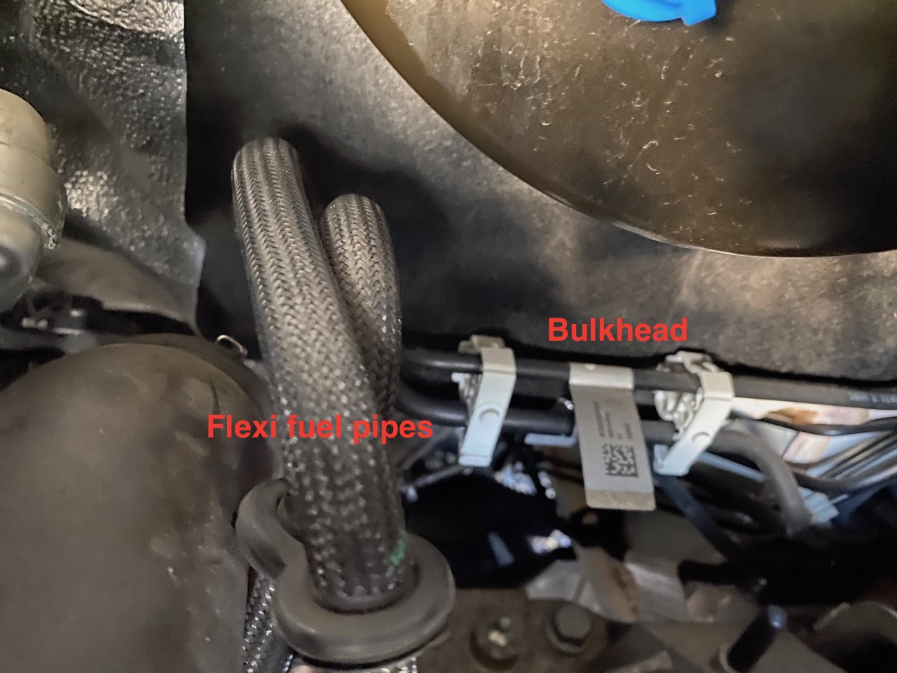

My Hymer motorhome is in a storage yard about 15 miles from home.
Last drove it a few weeks ago but went to start it yesterday and it just spurted diesel over the ground.
Has a look and found damage to the flexi pipes which connect the metal fuel lines to the pump.
Damage is shown as item 1 & 2 on the pictures. Looks like could possibly rodent damage - see item 3 on picture.
The engine is:
DUCATO 150 MULTIJET (290) [2016-...], ENGINE: F1AGL411C
The pipes appear to be a push fit as there are no obvious jubilee type clips on the connecting ends.
Anyone know if this a job that could be done in situ without needing recovery to a workshop ? Is it a case of just swapping out the two damaged pipes and how hard is that to do?
Thanks for any advice.

I'm not 100% certain without looking at an identical van, but are you sure that they aren't push-fit quick release couplings? There are a few different types in use, one of which is pictured in this thread:
https://www.fiatforum.com/ducato/347864-plastic-fuel-filter-housing-disconnecting-fuel-lines.html
If so, they will be complete replacement pipe sections with the relevant connectors pre-fitted. You should be able to replace them at home, but you'll need to obtain the correct pipes first.

Very useful info - really appreciated ! (y)

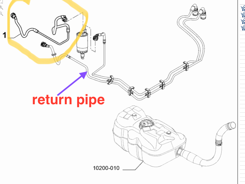

I've worked out the part numbers and the part looks like the attached (not my) picture. So it's got connectors both ends.
I'll go back and photo the part number tags just to double check and then get some on order.

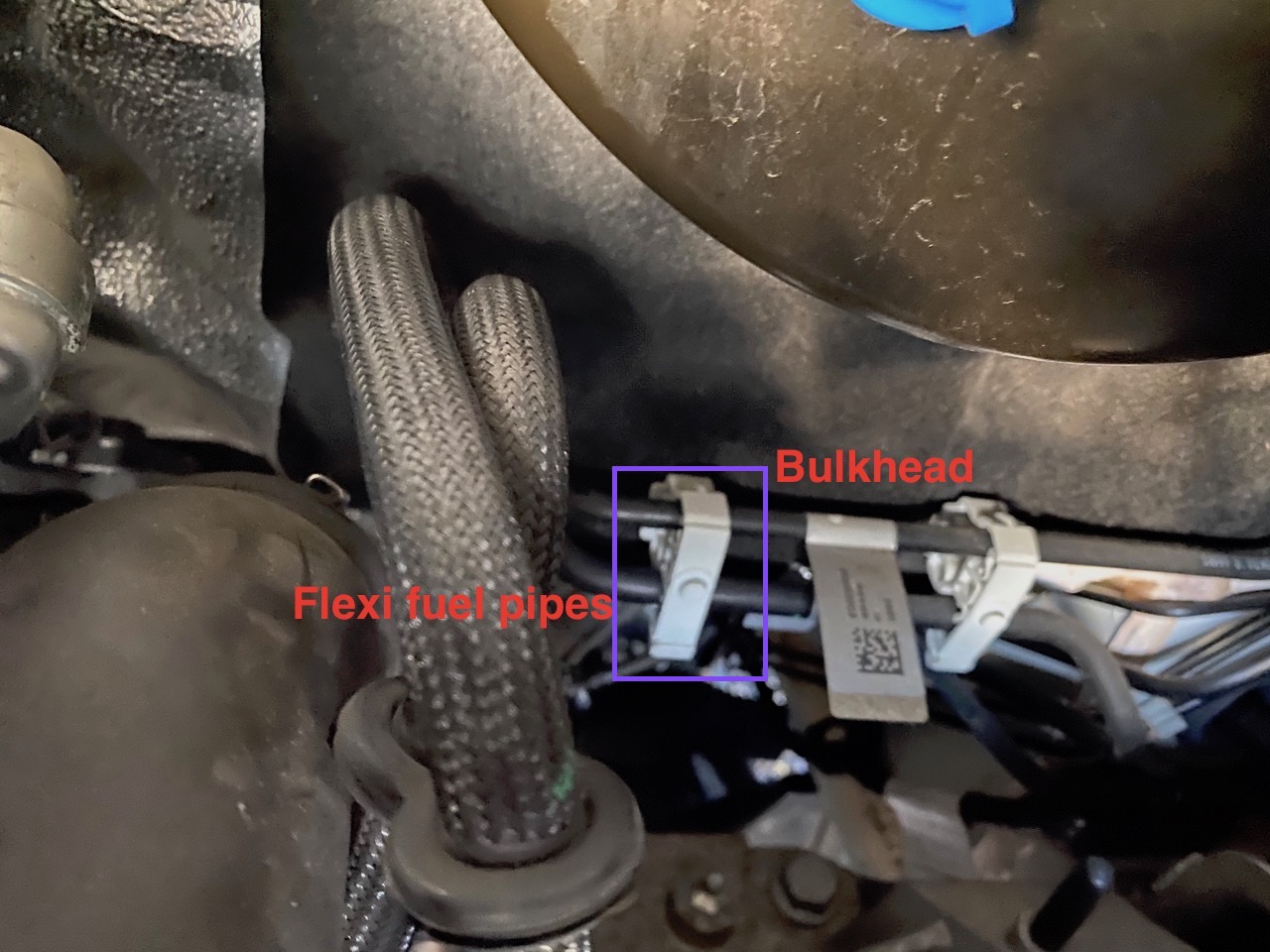

I haven't had a chance to get back to the Motorhome storage yard to fit the new pipe but should be able to in the next few days.
Question re the white clips that hold the pipes to the bulkhead - is there a knack to opening these - ?

The clips are often a bit of a pain. They clip together easily, but separating them can hurt the fingers.
Study them to see how the outer part clips on. Then try to slide that outer sideways, rather than pulling it off. As long as the clips are still flexible they'll let go OK. If they break, you can often tether the pipes with cable ties. New clips can be bought, but can take a bit of time identifying the correct part number.
Are you then going to relocate the van? As the rodents will still be there. They like to nibble rubber for some reason, until they get a face full of fuel, but they have short memories, so will attack again. I used to have a lot of problems with this in the mid-eighties with stored new cars, despite cat paw prints all over the vehicles. I've no idea what rodent repellant might be available to attach to the van or pipes.
In addition to portland_bill's advice, when you've identified how the clip mechanism works, careful and judicious use of a small flat bladed screwdriver as well as slipping one part sideways can also help to release them!

I can confirm sliding away from the tab with a flat screwdriver opens them quite easily.

Attached is the fuel pipe diagram incase that's useful to anyone.

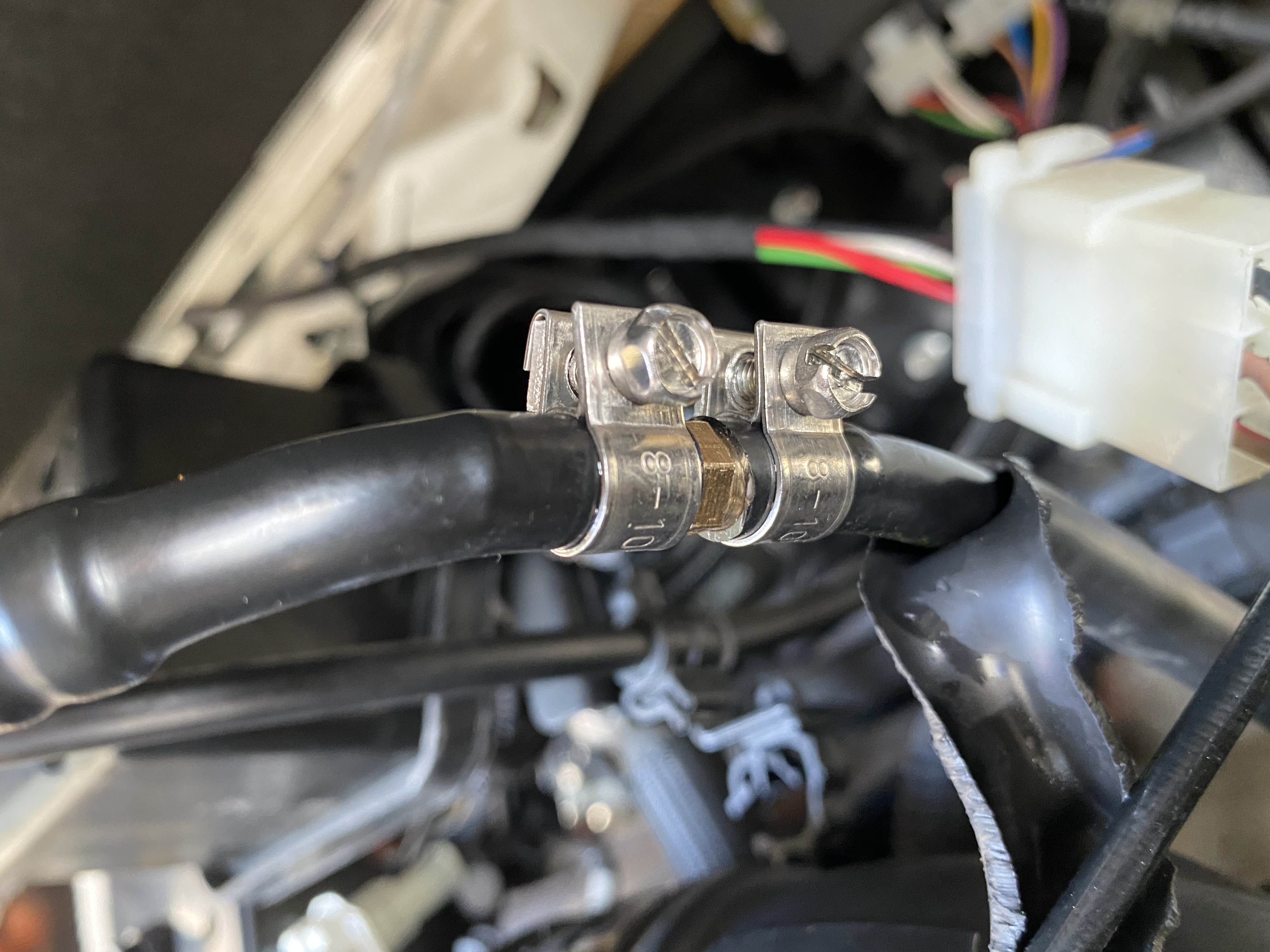

Yeay !! Its running again.
Just in case its useful info for anyone....
The fuel send line / pipe is 6mm internal diameter The return pipe is 8mm.
I used brass Barbs from Amazon to connect the pipes, about a quid each, and hose clips.
You need to heat pipes to make them pliable enough to push the barbs in, I used hot water.
