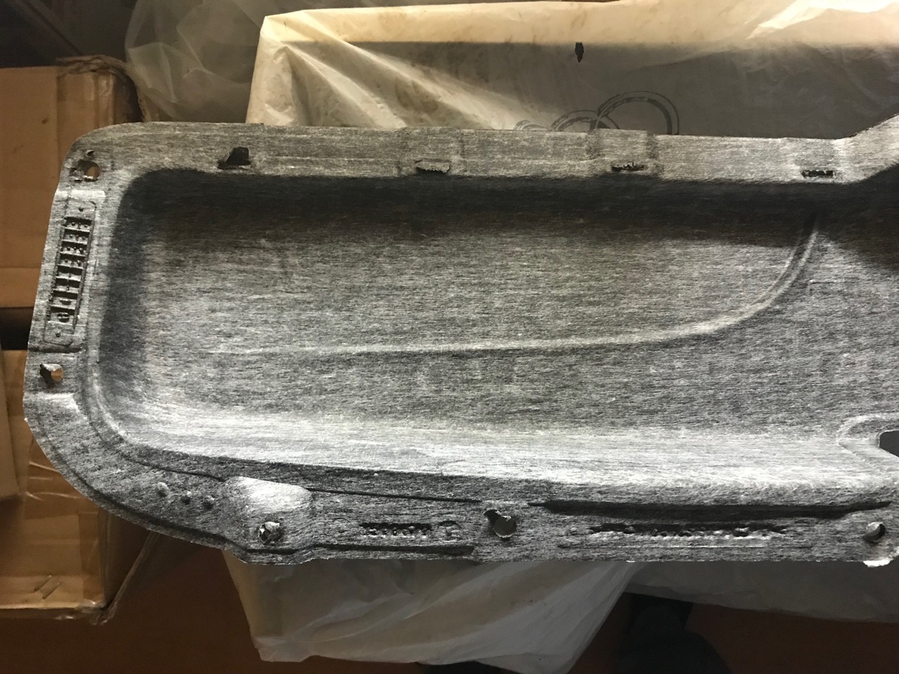

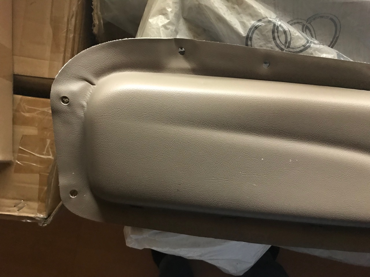

I’ve got several of them in my loft but I briefly looked at the back of one on eBay today. It appears from that picture that it may have lots of plastic rivets of some sort. I’ll have to investigate this further.
This is what they look like separately. So whatever fixes them is in the door cards.
