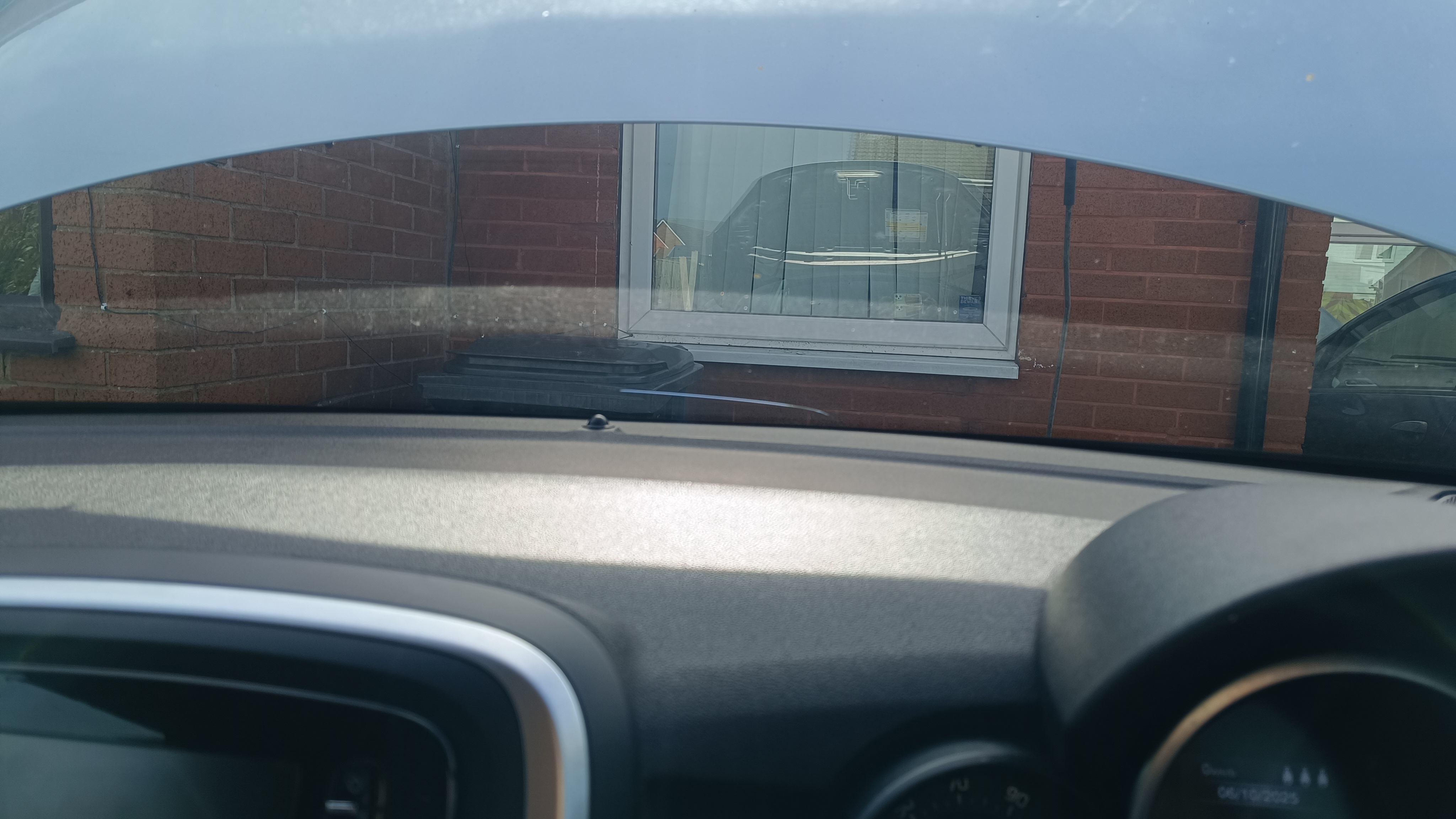

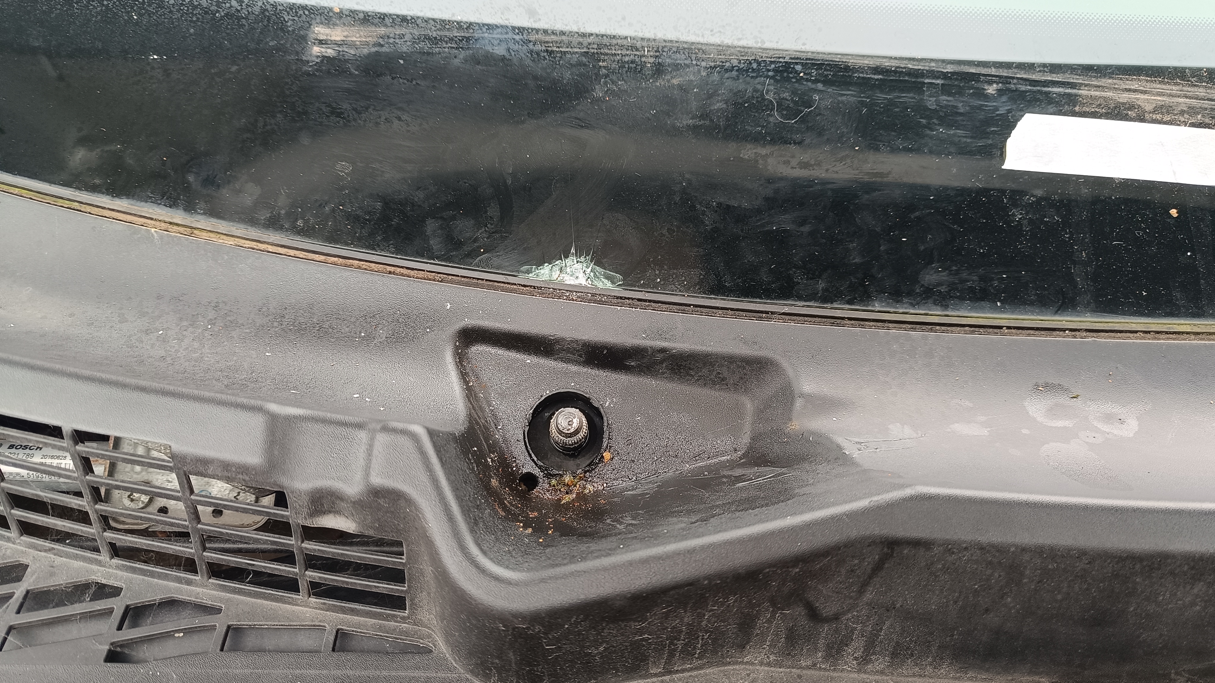

So its gone a lot worse than i'd hoped...i dropped one of the tools onto the windscreen and cracked it. There's a somewhat large stone chip visible from the outside and a crack lower down visible from the inside.
I presume this is repairable, (not by me), how much? Any good companies you know of?

Windscreen repairs are usually for stone chips and consist of applying a suction cup over the chip, vacuuming out as much air as possible which then lets the glue get sucked deep into the cracked/chipped area. That's going to be very difficult from what I see in you picture, because it's right at the edge. Maybe a specialist can though?

I don't think i can do it, so i'm not going to try! At least it can be done at home, i reckon anyway.
Yes that’s £100 through insurance, probably double or triple that then. Can’t really think of a way around it as you don’t normally get second hand screens anymore as they’re near on impossible to remove without damaging due to the excellent bonding properties of modern screens
That's a bit of bad luck. I recently tried a DIY on a crack using a syringe kit from AliE.... Waste of money & time.
There are some videos on youtube that make it look so easy. But of course its only easy on youtube or if you have experience. I'd have little chance of fixing this, perhaps none!
