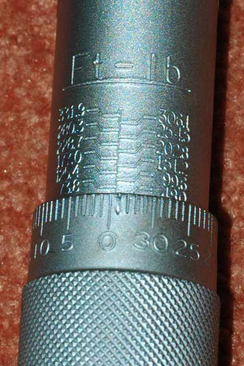

Surely it should be done up to the correct torque as stated in the manual![]()
no one got a torque wrench that goes up that high though
As the image shows 48-331.9lbft or 65 to 450Nm, it's 3/4" drive and 1100mm long.What's the range on that one? (I desperately need a 4th torque wrench!)
