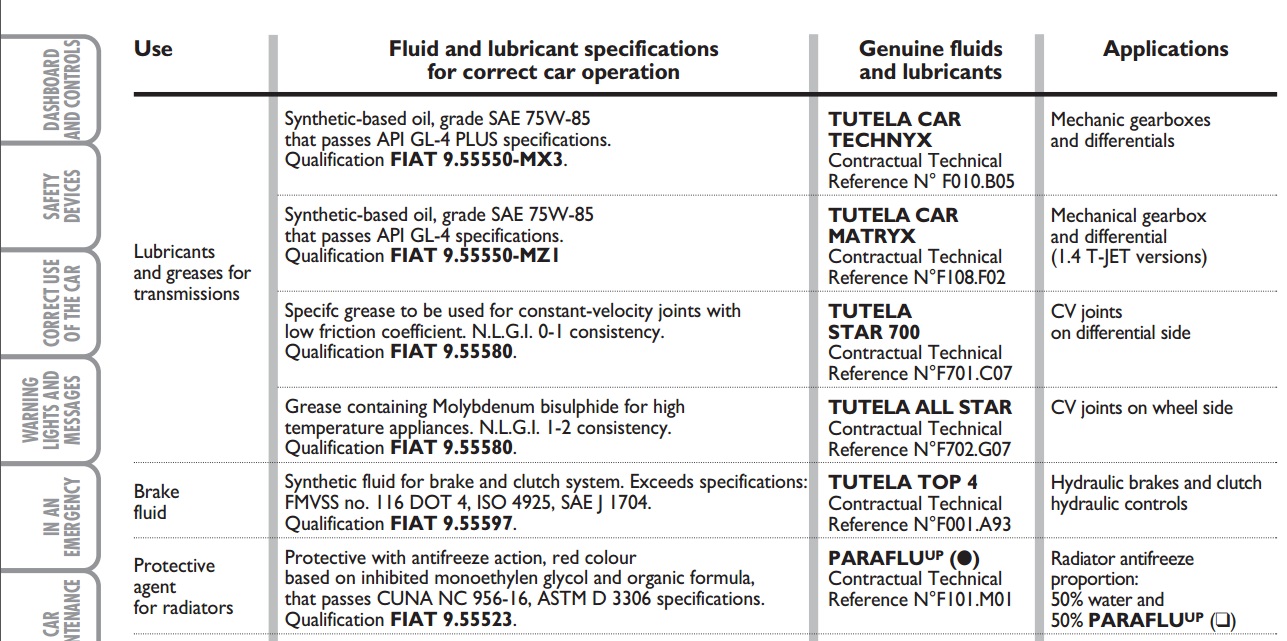

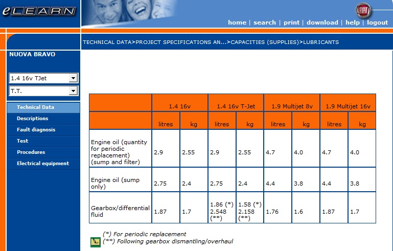

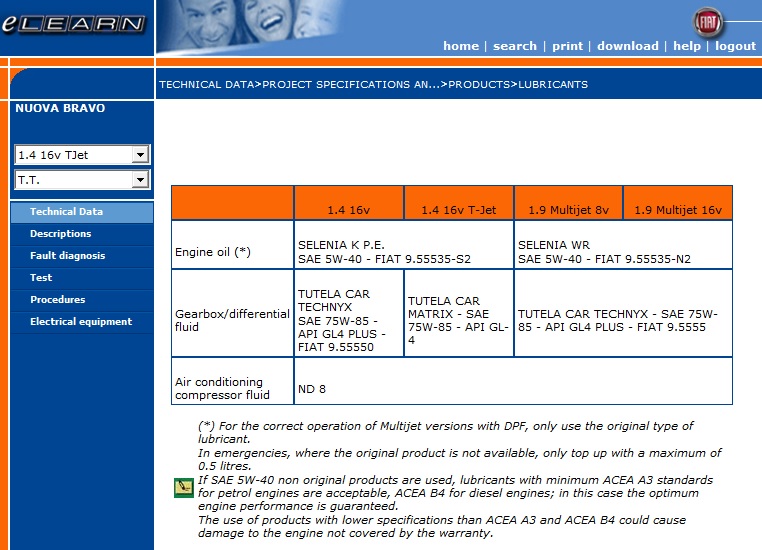

According to Fiat's eLEARN the 1.4 16v TJet uses Tutela Car Technyx oil
grade SAE 75W-85, API GL4 Plus - Fiat 9.55550. Quantity is shown as 1.58 kgs.
So, Brand of oil : Tutela
Type : Car Technyx
Grade : SAE 75W-85
Standard : API GL4 Plus
Quantity : 1.58 kg Oil is usually sold per litre or 0.5 litre(500ml)
( 1 litre of oil weighs approx. 1 kg, afaik)
You would need to buy a good quality gear oil of 75w85 viscosity, meeting API GL4 Plus standard, quantity approx 3-4 x 500ml bottles, i.e. 3 bottles might fill it or you might need to start on a 4th bottle)
Good luck with your first? gearbox oil change!
Al.
