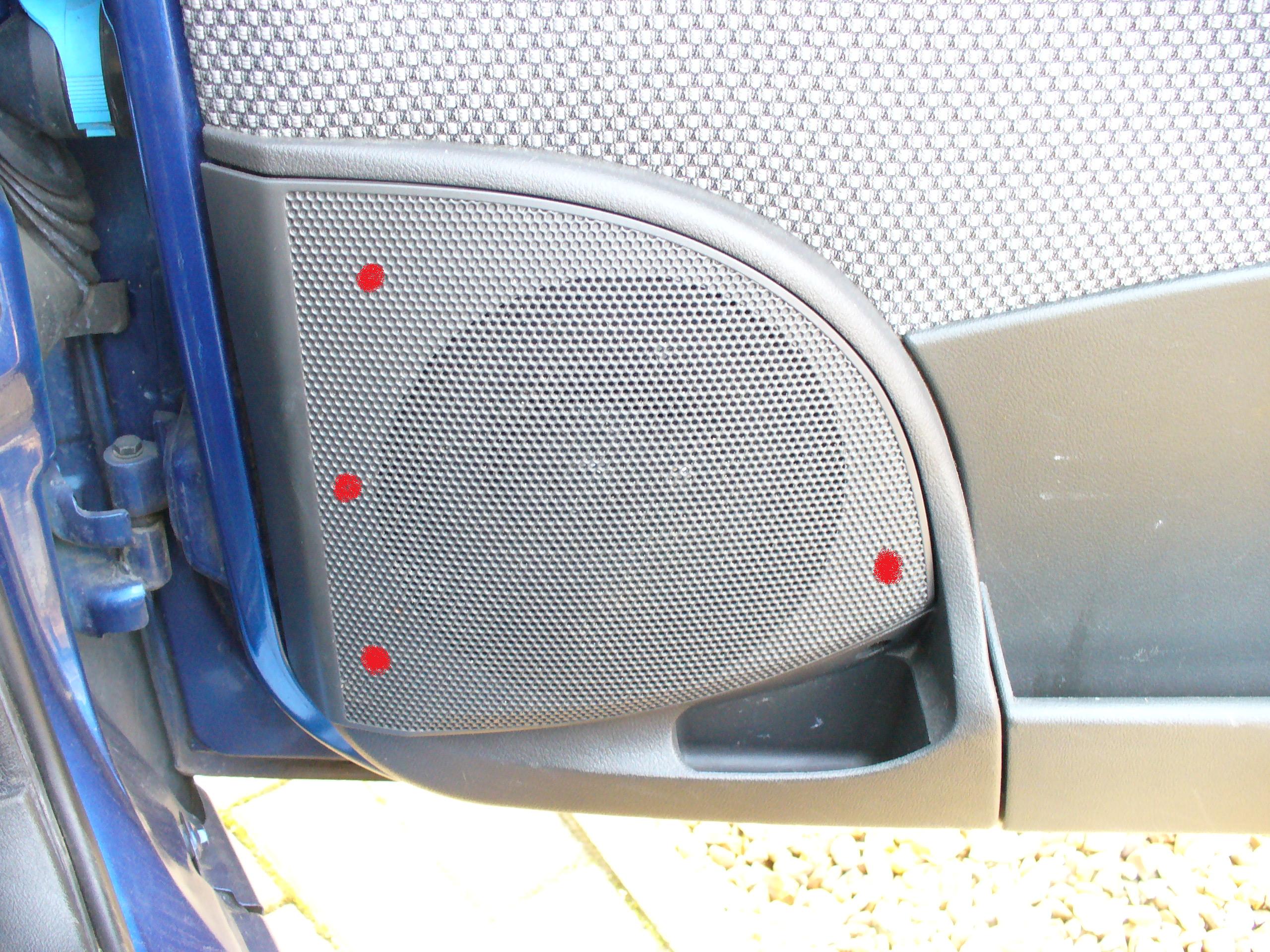

heres how i done mine,
carefully prise off the cover. (i labelled in red blobs where the locking pins are, there are clips all around it tho.

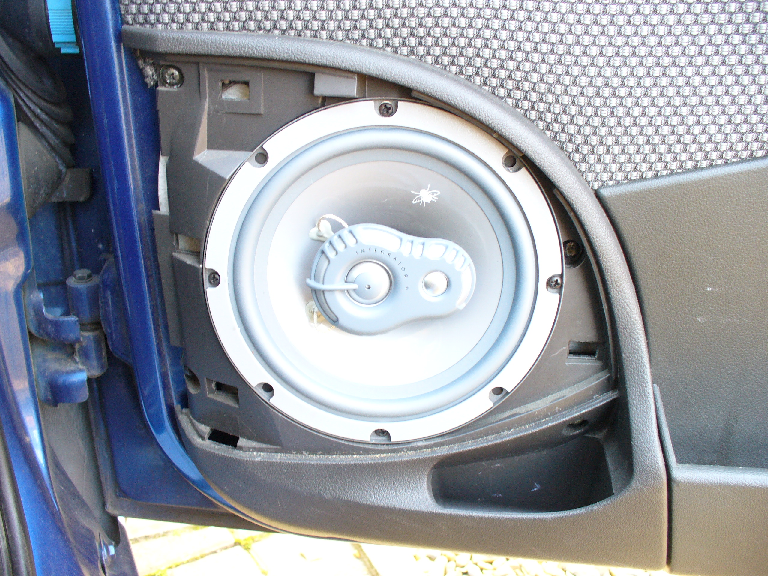

then i undone three standard screws, the old speaker cam out with a clip going into the back. i then identified the +ve and -ve put on new connectors and plugged it into my new speaker.
screwed it in place and wired it to headunit. All i bought to do this was Fli integrator 6.5".i didnt need any extras to fit them.

Cheers Matt, the cover popped off just like you said. It looks like any new speakers should just fit in easily. I don't know if the adaptor was just Halfords trying to make some extra cash or what.

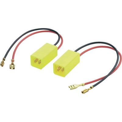

There's an adapter for that. However, the driver side in mine had two plugs attachted to the speaker, one yellow and one red, with different keying.
Does someone know what the red plug is for?
