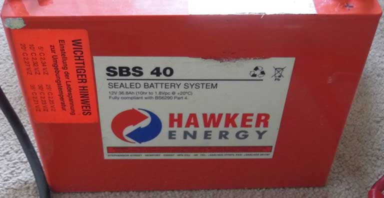

Would that be a GEL battery by any chance. Gels have an incredible life span if not abused.
Hi,
The one with 20 years and a supersonic record isn't a gel, it's a absorbed glass mat (AGM), Hawker SBS40 designed for aircraft use. The Duracell is an enhanced wet acid type with a porous plastic pocket over the plates to control shedding. This gives longer life.
Robert G8RPi.
20 year old battery? how
also you can get more than 3 squid for your old battery if you sell it, croma got quite heavy battery, dunno prices per kg there for car batteries but more than 3 squid for sure
Hi,

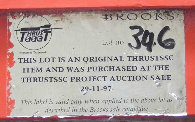

Well the battery was supplied new sometime in 1995, I fitted it in the car early 1996. Car was run in UK and Jordan in 1996, Jordan and Black Rock USA in 1997 this included a number of complete discharges, and 5 supersonic runs. I removed the battery from the car early 1998 and purchased it (and the other "emergency" battery) at auction in 1998. Since then it has been used as a jump start pack, start my small jet engines, run emergency radios and has also sat unused for long periods. It's still going strong. Will happily start a big commercial vehicle diesel. cranking current is over 2000A
Scrap battery prices are around 40p a kilo at the moment so would probably get about £6 from the scrappy but it's a lot of hassle for one item these days.
got pic of that battery?
Yes indeed,
I was wrong on the removal and auction dates, it was late '97 not '98. Even as a team member who supplied lots of kit FOC I still had to bid for it at auction. I did keep one of the keys (Andy has the other one) and the Machmeter is mine but is kept in the car. The grey "AA" bag was for a mobile phone that only called the AA or 999. needless to they didn't catch on and I'd bought some of the bags as new surplus years before. Just happened the battery fits perfectly.
Robert G8RPI.
how the hell this battery still works, they must be expensive
Hi,
Quality materials and construction. I have a couple that are even older but have not been supersonic. Current price (non-aircraft approved from Farnell) is £260.95 plus VAT = £313. They are used by a lot of race teams and there is a cheaper variant branded Odyessy, about 1/2 the price but I don't think they are the same quality.
