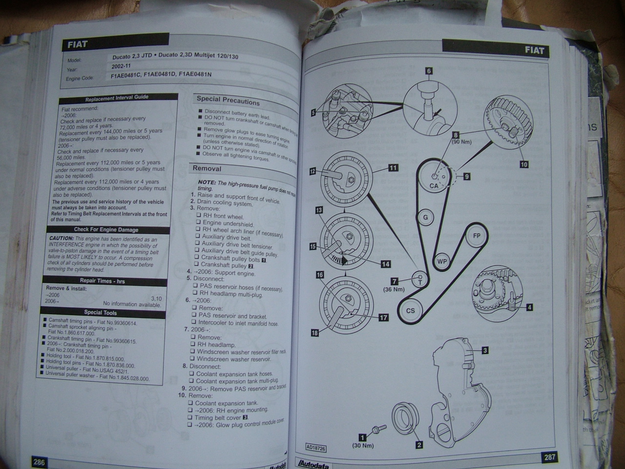

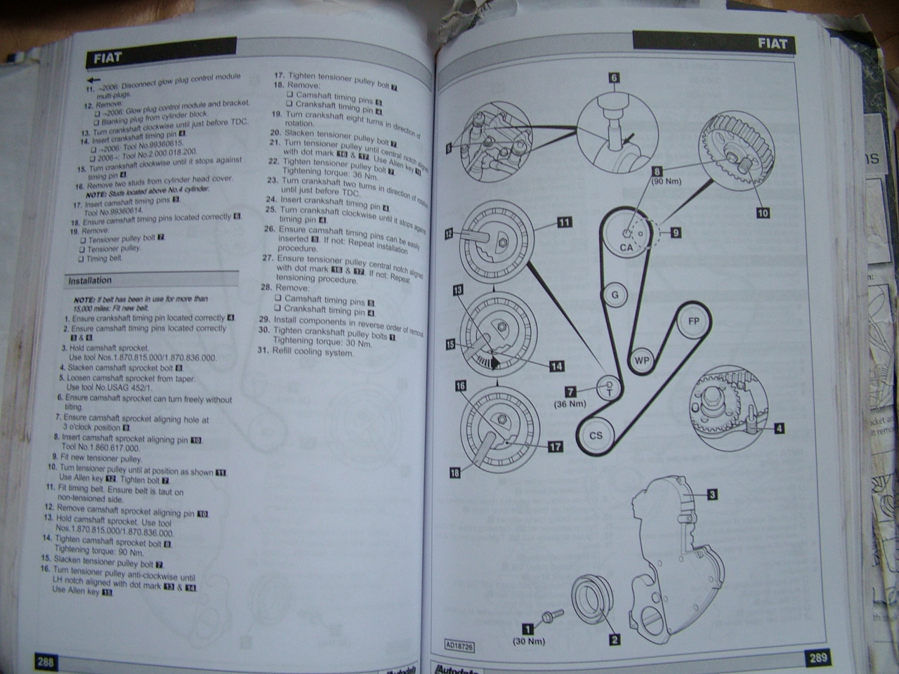

Is this any good if you want to recheck cambelt side? Assuming same engine series.
