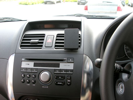

Hi All;
I've recently purchased a Sedici and am now looking at replacing the factory standard radio (mainly because I want to install a snazzy Bluetooth one!).
I can't see any obvious way of removing the outter trim. So before I try to prise it off; I wanted to know if there was an obvious trick that I'm missing? i.e. if I take out the change trays, etc. will I find a very easy way of removing the header trim?
Secondly - once this is off; I know I will need to buy a double din caddle for the new radio. I've read elsewhere to buy the Suzuki sx4 version; but has anyone previously bought one they can recommend (obviously the cheaper the better).
I've attached a picture of what the header unit looks like
Many thanks in advance.
CD.
Hi and welcom
The silver trims at each side have to be pulled forwards think there are 4 clips be carefull as the trims are a little weak then you will see screws holding radio / heater controls etc just undo which bit you need to and remove.
Regards Stephen.
I think something like a credit card can also be used, although you may damage the card.
