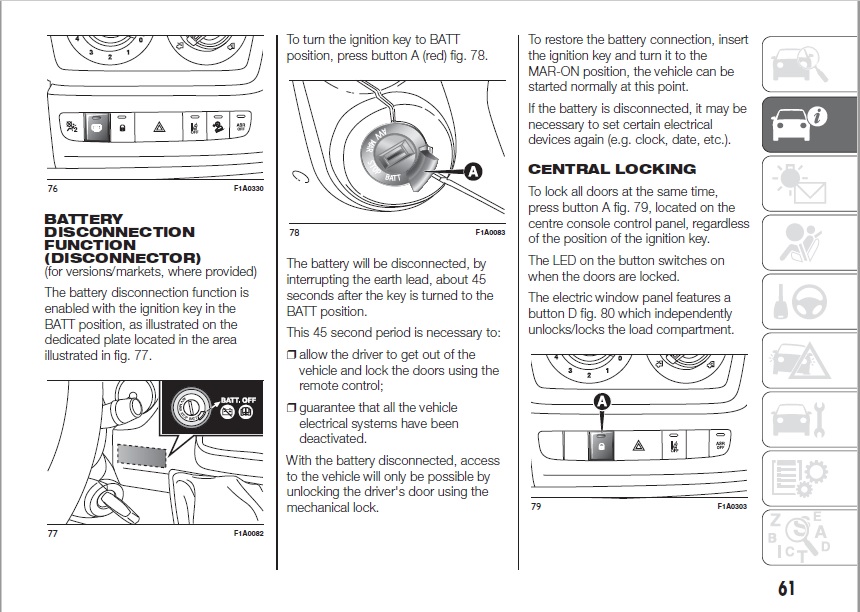

The label on the fascia suggests that it is explained in the handbook.
If you do not have a handbook, download one here: https://www.fiatforum.com/downloads.php?do=download&downloadid=491
See page 61 for the function of the red tab.
Thanks Bill
It doesn't say how it should be used........the guy at the Fiat dealers recons I should be using it all the time. I was under the impression that it should only be used for longer periods of lay-up?
It does turn everything off on the vehicle.
Given what needs to be reset after use, I would suggest it is designed for use in periods of extended storage (no use of vehicle for a matter of weeks) to avoid "parasitic" drain exhausting the vehicle battery. I certainly wouldn't use it on a day-to-day basis (except in the unlikely situation that the battery dies very quickly if you don't).
