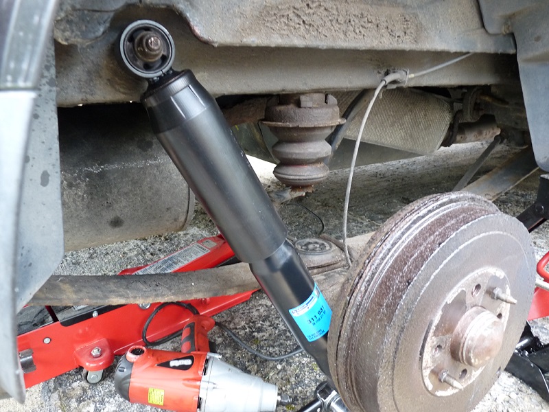

The ones I got for mine were the 311931 (2007 1.9 105hp Doblo). The supplier's website listed multiple part numbers for Doblos, but these were the ones they sold me based on reg. no. They seem fine, no more knocking and banging as per the other thread.
Picture attached.

Glad you got it done.
The bottom nut/bolt was only really tight on one side with mine (note the electric impact wrench in the photo).
