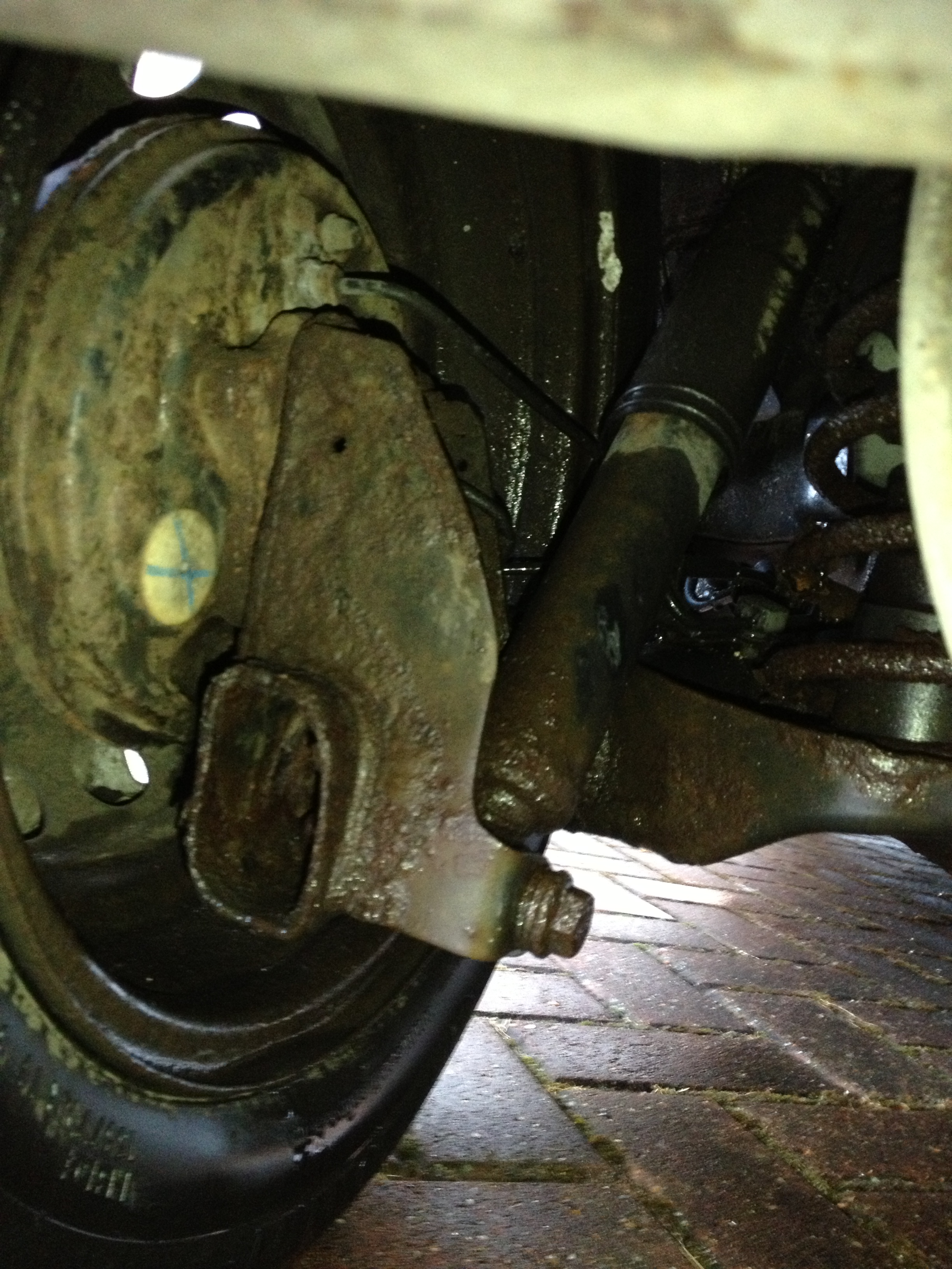

1) I'm not too sure what the "bush" is referring to - Google throws up images of a rubber end/a physical shock absorber/mixed images in other words.
I understand the shock absorber is the long cylinder.
Is the bush the upper part of it/the bottom part is it or where it bolts in on the top/bottom?
I've attached images of my car.

£160!
I got a second hand one at scrapyard for £5, ten minutes to replace, really simple.
Bush is rubber part, integral to shock absorber at either end, can't replace separately.
It's fairly unusual for those bushes to go, more often shock itself goes.
You don't have to worry about springs on back, just take wheel off, undo nuts, remove. But bottom bolt can be a nightmare.

The bottom bolts can often seize in due to rust, so with an impact gun and oil possibly heat you may be able to work the buggers out
if the snap, the hole is big enough for you to nut and bolt it instead, but its 10x easier if the bolt survives

As for the £160 - he's probably looking at the lower screws on the shocks and remembers all to well the pig of a job the last ones were. They look nasty.
