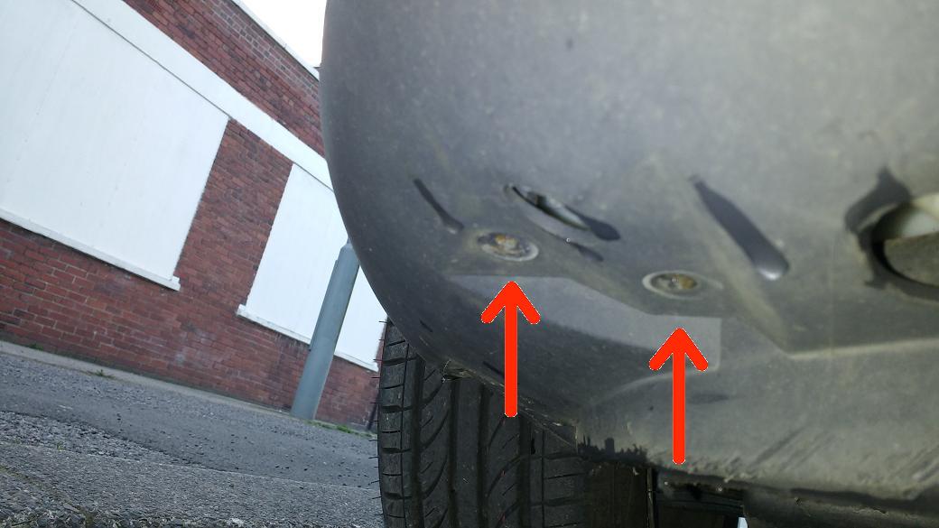

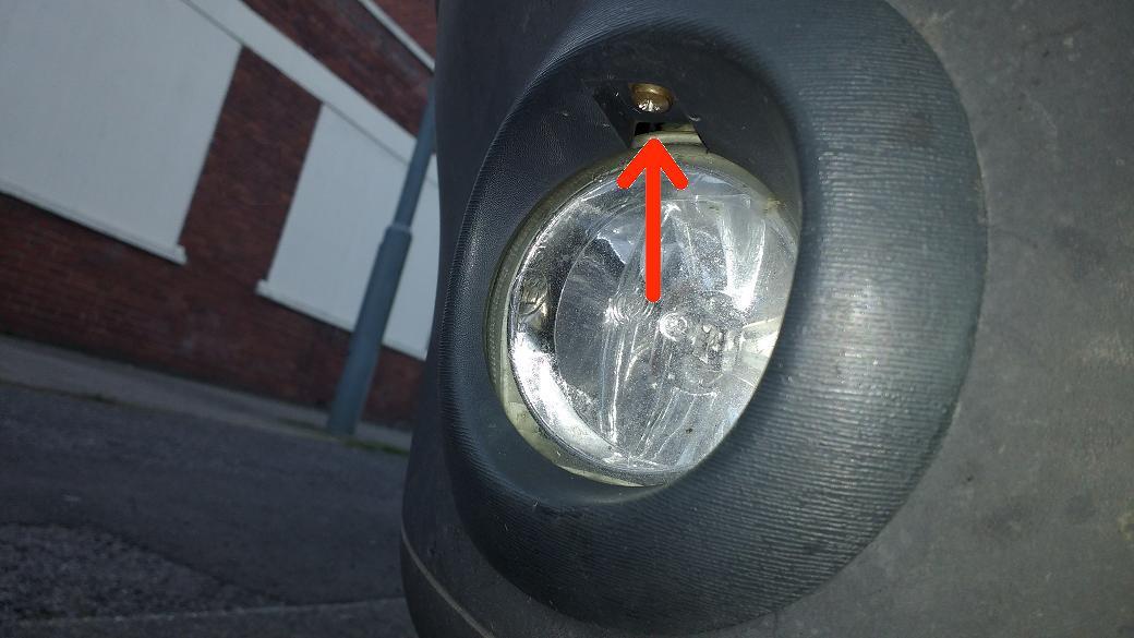

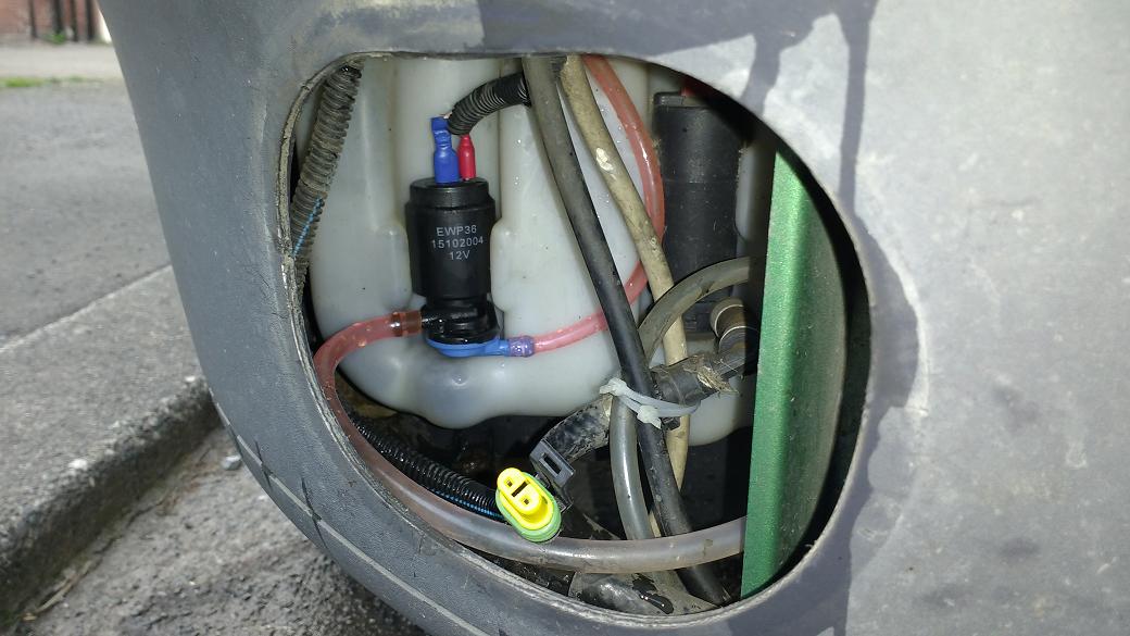

Hi Mike, no idea what the route of the washer pipe is to rear washer, but I've just replaced the washer pump on my '01 Multi, and this is how you access it via the driver's side (UK) fog light (see photos below)...
Couple of points which might help in resolving the problem:
- One pipe off the pump goes to front washers jets, the other pipe goes to rear washer jet.
- I believe there is a non-return valve which can get blocked. To bypass the potential blockage (no idea where the valve is/was), I routed new pipe directly from the pump to the front jets. I wasn't bothered about the rear washer, so I just chopped and plugged the pipe up.
- After 4 years since the last pump replacement, the electrical connections onto my old pump were rusted to hell, so problem could be a bad electrical connection? I chopped off the female spade connectors on the wires to the washer pump and replaced with new, as you can see.
- Also, poor flow could be caused by blocked jets full of cr*p. I have just cleaned my front jets with very hot 50/50 vinegar and water (twice) plus agitation, then left overnight in water and washing up liquid. A lot of cr*p came out of them and they're squirting well again.
- You could try swapping the pipes round out of the pump, this would confirm/eliminate whether it is the pump that is the problem ie. it's only pumping out of one side to the front jets... Or stick a short piece of spare pipe on each pump outlet in turn and check it's pumping out of each side...
Why not just detach the old rear washer pipe from the washer pump, and route a *new* pipe from the pump to the rear washer jet by whatever route you find best? That's what I did with my front washer jets 4 years ago...
Mark
PS. From the photo, I think it's the left pump pipe that goes to the rear washer jet (in the photo on mine the left pipe is just a dummy piece of pipe plugged at the end). The right pipe is the new pipe I installed to go directly from the pump to the front jets (via the engine bay).

- Fog light top screw
- Fog light bottom 2 screws (already removed)
- Washer pump and connections
