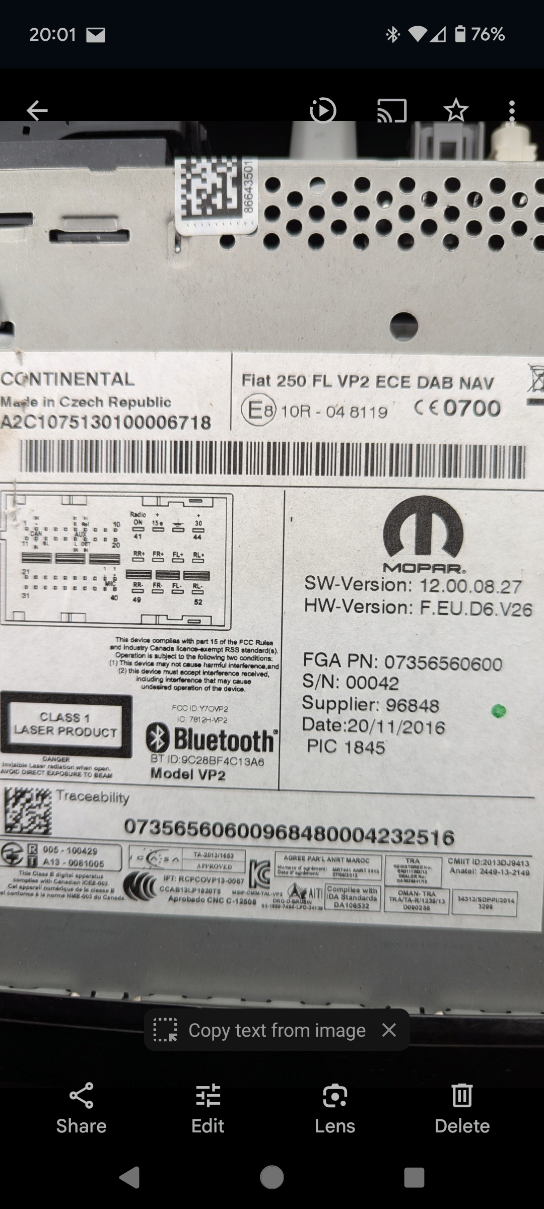

Purchased this radio last week and bought a code from here, all working except for rear camera, it seems identical to the unit Ive
replaced, does any know why This unit is not compatible with a 2019 plate ducato with factory fitted rear camera

Looking at both stickers above and connection diagrams on them, it seems to me that neither of them has a connection to the reverse camera. Or it is not clearly described.

On mine the camera was in the area of pins 21-40 and is specifically built into the loom, but you need the correct firmware in the head unit for it to be recognised. If I can find it I'll post up the document I had when I had my new Alpine head unit installed, which lists all the necessary info on the camera setup
