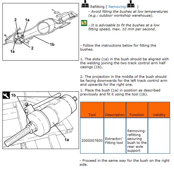

Mind the "clocking" of the bushings (pay attention on how old ones were oriented or check the attachment picture) and position of the beam relative to the car body (angle) while you torque the bushing bolts (again, copy the original position/angle of the bushing bracket, how it relates to the axle or chassis - there is no data for Grande, but there is an example for Stilo I guess, second attachment).
Improvised install tool will be helpful (custom cups/washers with threaded rod, but don't pull the central part of the bush, push/pull only on OD - outer diameter). That's it.
