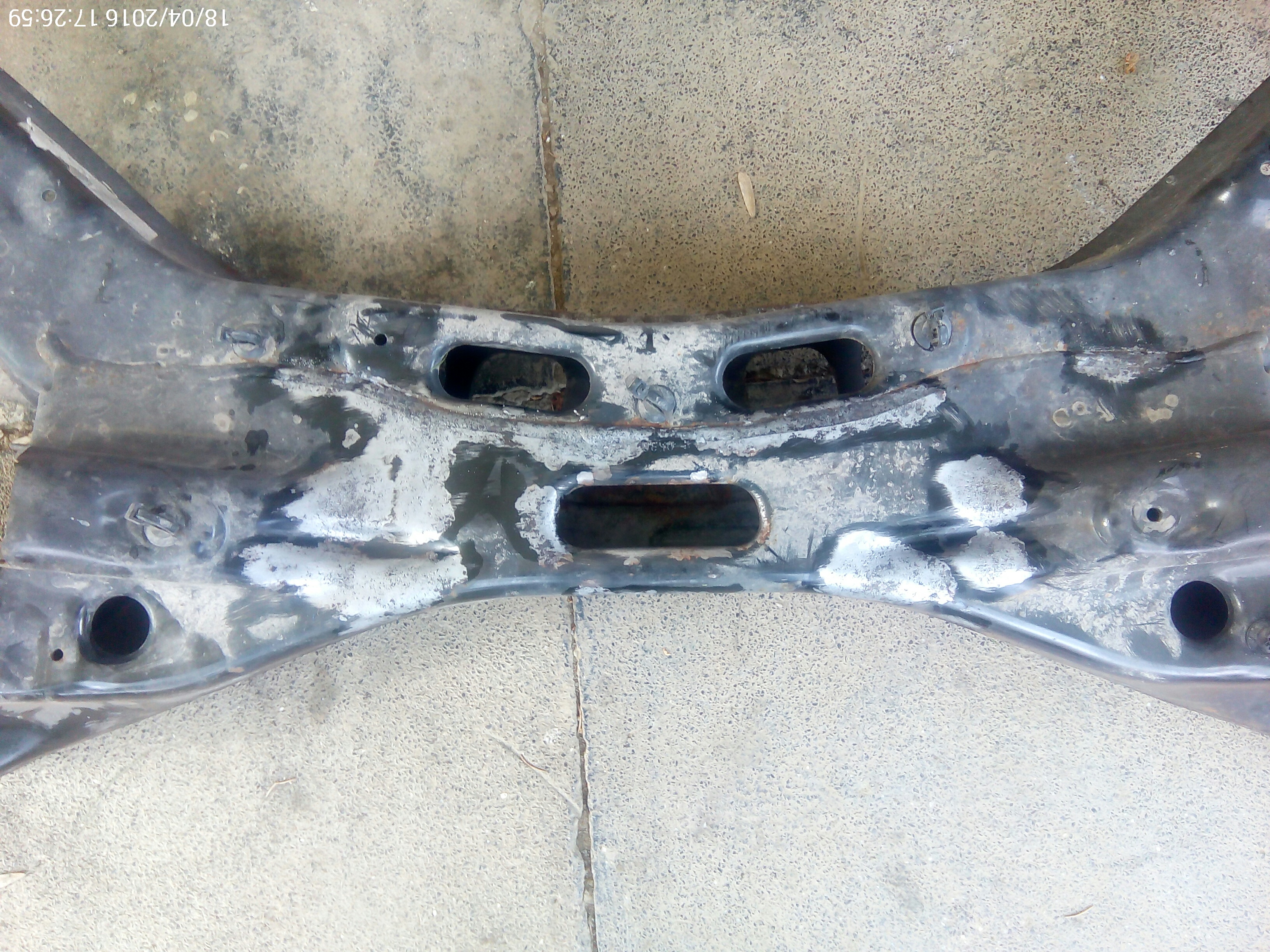

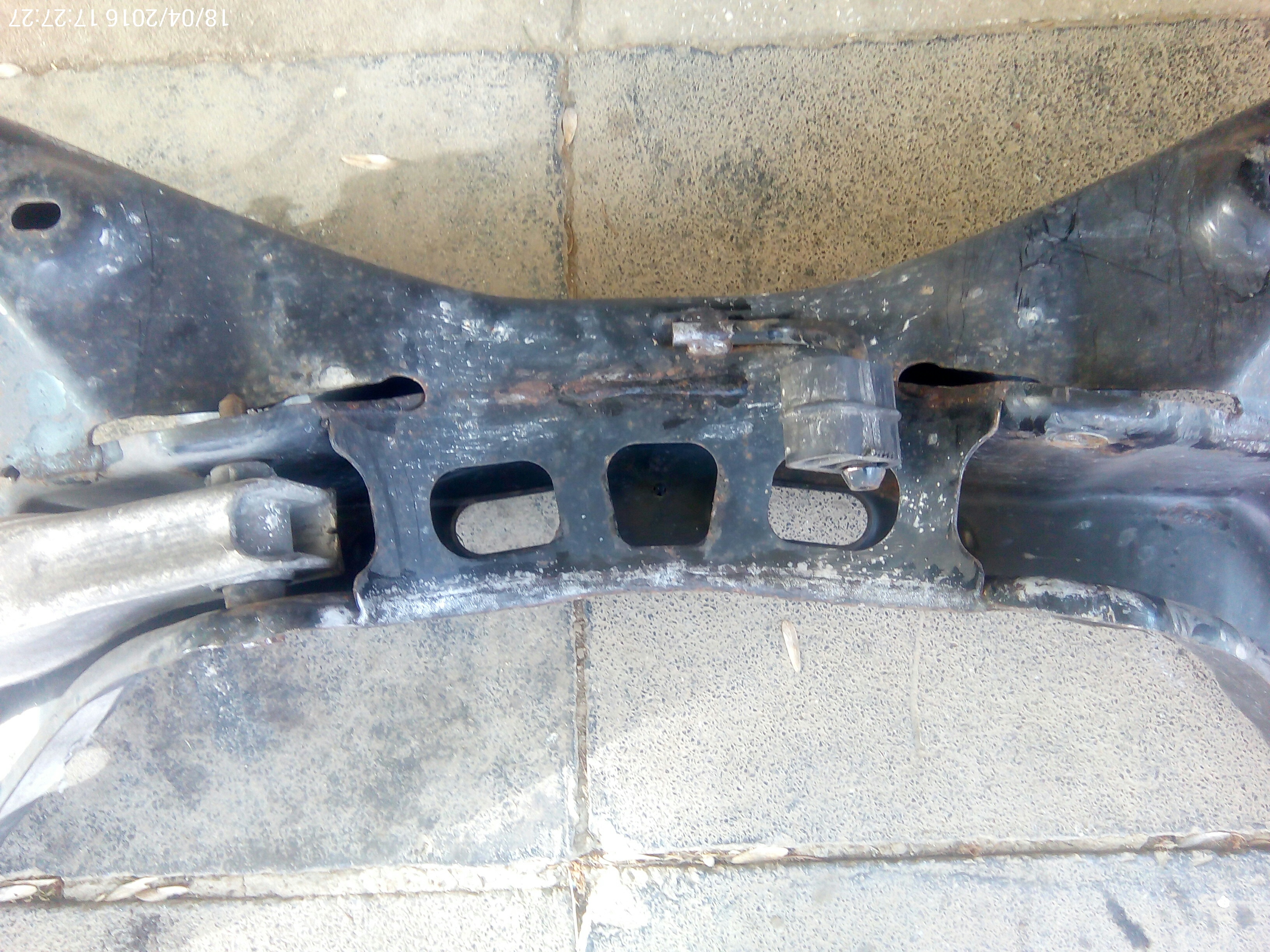

is it inverted torx socket for that bolt?
dunno if these pictures will help but still

Flisko , thanks for the pics of the sub-frame, wish mine looked like that.:)
