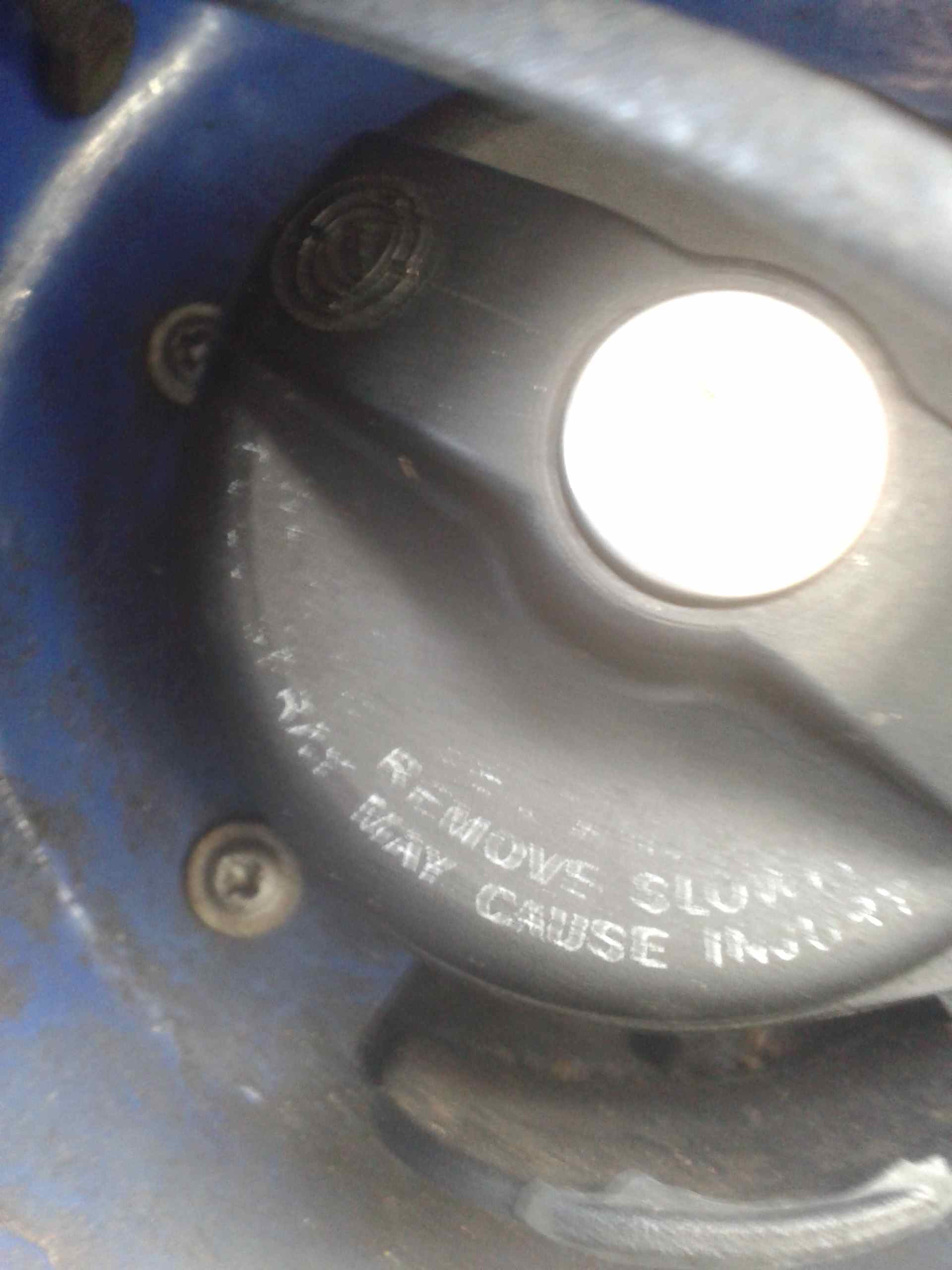

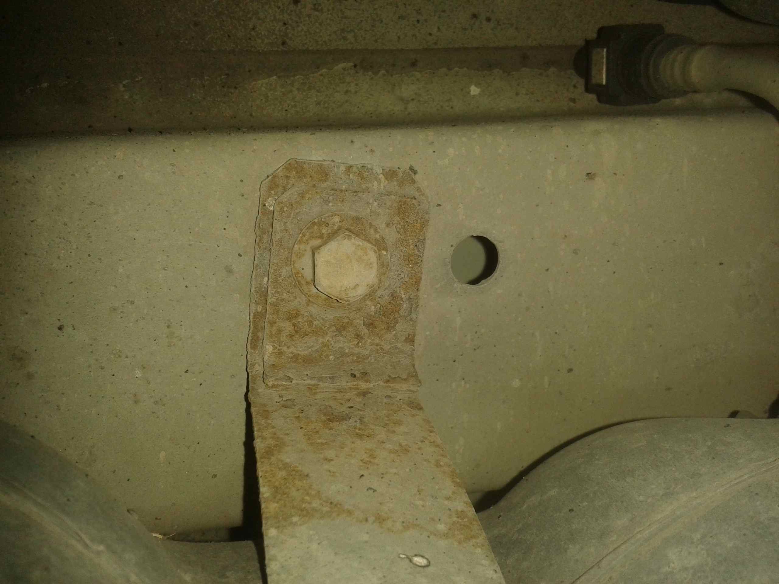

20140913_115055.jpg5. Remove bolts to brackets that hold bushes and anti roll bar to car.

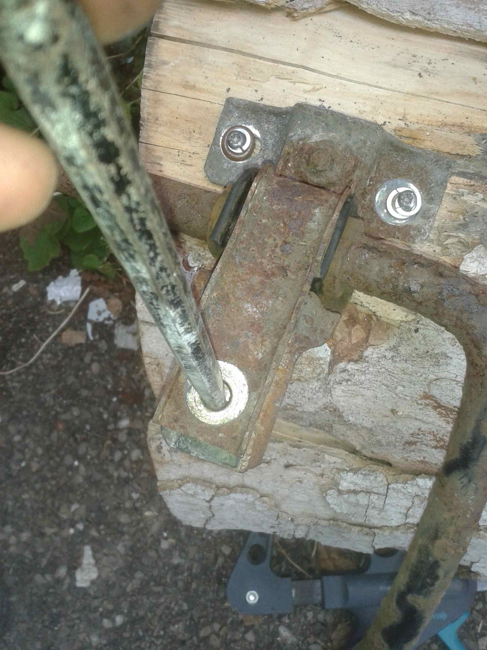

7. The bracket holding the bushes to the bar are pressed together. You will need to find a suitable thin chisel to split the two parts at one end[/ATTACH]
8. Note i have screwed the anti roll bar bracket to a large piece of tree to hold everything steady. Bend the bracket just wide enough to get the anti roll bar bush off and to replace the new one.
9. The tricky bit is getting the bracket to close tight around the new anti roll bar bush. I used a chisel in the hole to lever the two pieces back into position and then two g clamps to close the pieces together. I then drilled a small hole through both pieces close to the bush a used a nut and bolt to tighten the two pieces together.
10. To ensure the bracket gripped the anti roll bar bush tightly I then used a blunt chisel to bash the bracket all the way round.
11. Put everything back together and rear end of car now silent when going over bumps. Horray. Hope this helps someone as I've got loads of help from this forum.20140913_104018.jpg
