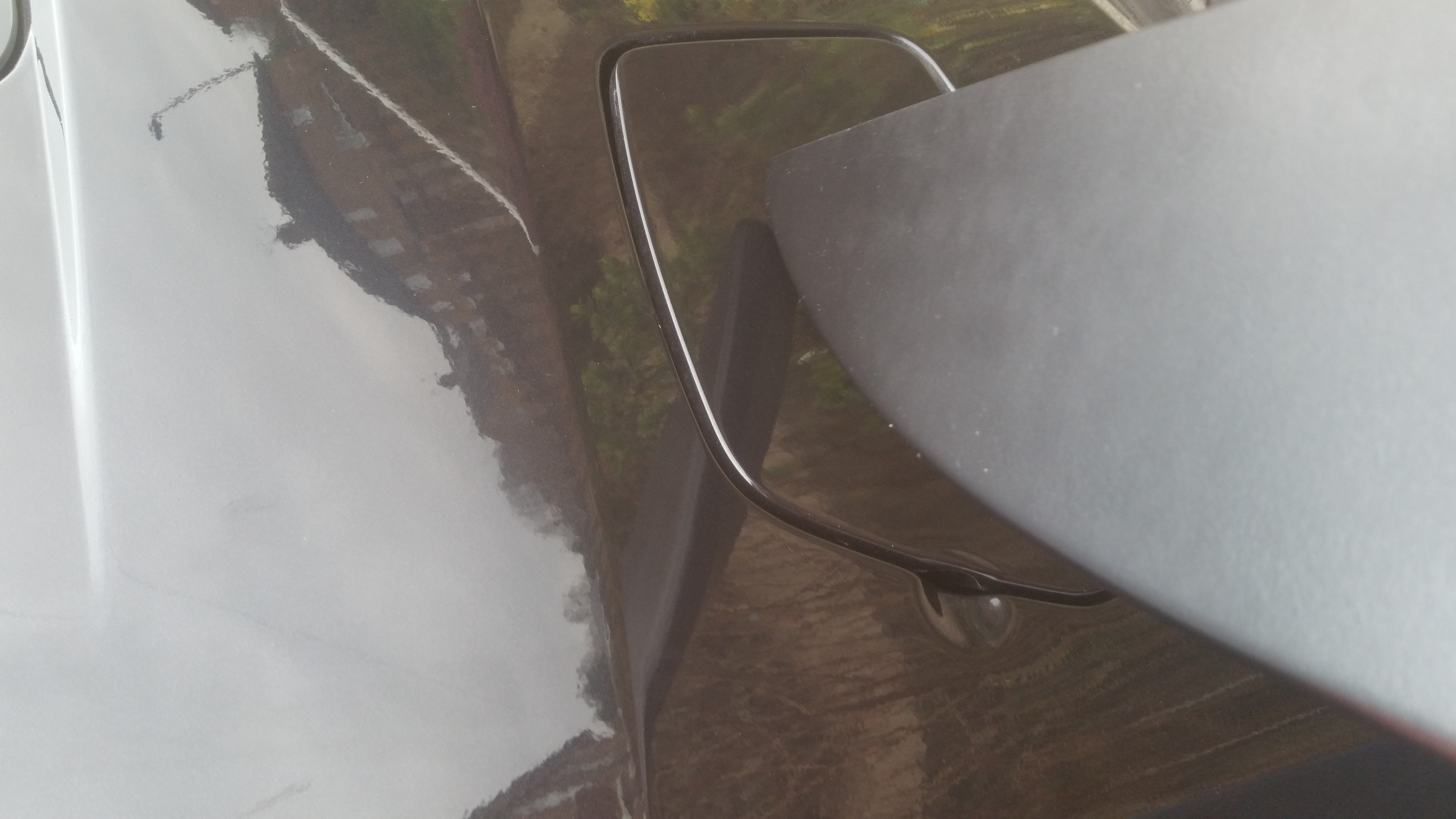

Thank you very much for that it was very helpful, that being the case I think I have done something wrong:confused:
Nothing drastic, flash a quick coat over the top side (just a light one - only needs something for the flake to adhere to), then couple of mins later run the met coat over the top from further away and let it fall.
Thank you again mate for your help yesterday was very warm so I tried to lacquer it so that is not just the top coat I don't know if it has bloomed and if it has weather I could get away with rubbing it down then a t-cut and polish ? I am sorry I should have pointed this out in my last post:shakehead:
Try to cut and either a compound or metal polish to act as the compound, then t t cut, then polish. You want to get rid of the top lacquer. Won't take much on a can job.
Failing, that, it is a runb down and start again.
The temperature needs to be around 20 ideally, around half that and the moisture will effect the paint giving it the milky film. That or thereabouts is probably what the temp has been recently.
  • Like
Reactions: tlo
I was tempted to have a go but I just sanded it down for now:D will have another go when its warmer one daft question can I t-cut it then lacquer it when its warmer ? I am hoping the t-cut might make it darker it seems a bit light to me
