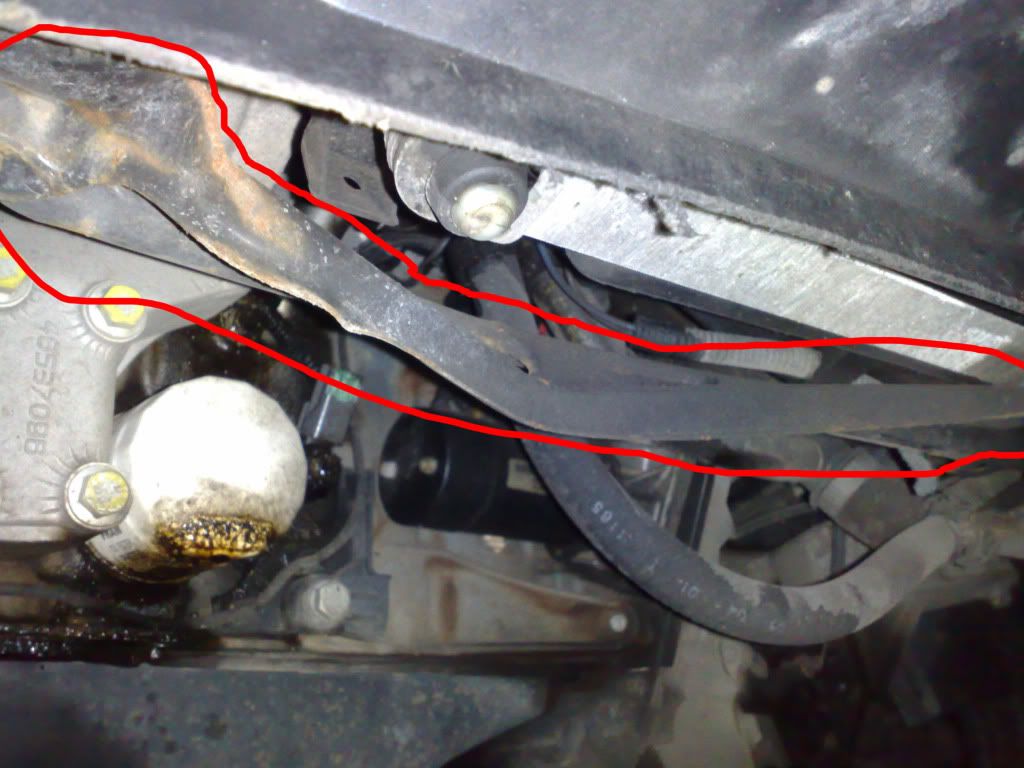

Heres a pic of the part:
Its the bit circled in red! :)

Did you catch the oil filter as well?
Just thinking it looks a right mess - in as much as its leaking.

Umm, Im not sure. I guess i could have done. The guy at my local garage who looked at it didnt mention anything about it though.

yep it was the bit i was thinking about. i have got one £20 and its yours but ur have to wait for a nice day for me to take it off for you.

Any idea about that oil filter, (im guessing that the round silver/grey thing soaked in oil) Is it a simple take the old one off put the new one on?

Do an oil change while you ar at it.Filter will need a filter wrench to take off, If you have not got one just knock a screwdriver into it and unscrew it. Messy job that way though. Replace hand tight only. As said, It is worth doing an oil change at the same time
