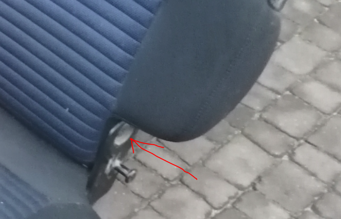

That's how the upper mounting point looks like, perhaps it will give you an idea of what could be blocking:
And that's the seat itself with visible both the top lock and the bottom 'hook':

The external mounts should be symmetrical on both sides, the single + twin.
When there are 3 mount points in such seats:
the hinge in the front of the seat base,
the hook / lock at the back of the seat base and
the hook / lock at the top of the backrest (?)
usually the hinge between the seat base and the backrest is only screwed on both sides here:
The other three elements hold both parts together and in place.
Can you make a photo of the external hook on both sides (twin + single)? Just to compare. In open positions, please.
