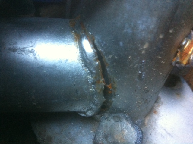

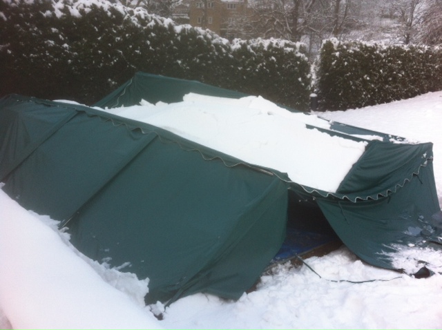

Please, don't do the same thing! After a few weeks eight of the tube joiners in the tent frame had failed (the welds hadn't penetrated into the base material to any real extent) and the tent almost collapsed. The company concerned eventually replaced the failed connectors, and I wasted my time rebuilding the tent, because a month later in the recent snow it collapsed completely. Sadly a rather nice Fiat X1/9 and an even nicer Alfa GTV were underneath it. Both have been extensively damaged.
According to the company concerned all year round doesn't mean in winter or in snow. Apparently in winter the correct procedure is to take whatever is being stored in the shelter and leave it out in the snow, to rot. Then the tent should be dismantled and stored somewhere safe. In one of their competitors shelters perhaps? This advice is in incredibly small print on the last page of the instructions. Unsurprisingly, it's not mentioned in the advertising blurb.
