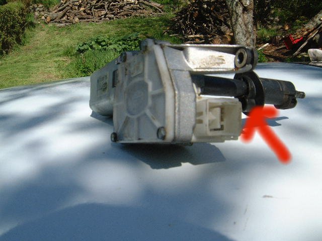

Hi, i have taken the cover off from the boot, undone 3 alen keys, but carnt see were the pipe goes!
Im gessing there is a hole on the 60s model,
Has someone got a pic, or tell me how to find, it
Thanks in advance
its located on the black spindle , hope the photo helps
all mk1's have the same crappy washer unit thing, it doesnt' really come apart.
dont' bothr trying to take the motor off, it really doesn't help and could cause more problems if you put in on wrong.

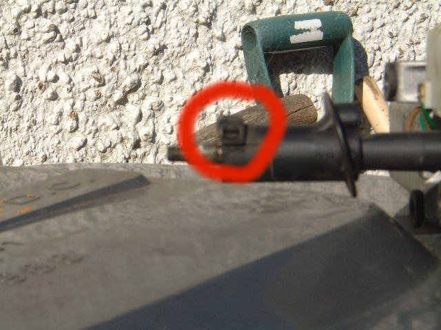

it coming out but just a driblle is likely that the little jet thing has been turned around at some point, I thought it would be a good idea to re-align mine, but messed it upcomplelty.
there is a black flat screw on the right side (think), that angles it, DO NOT turn it more than a fraction of a degree, otherwiseit will go inside itself and you'll never ever get it right again

Have you got a pic of that, not sure if i did anything when i put my private plates on
hope you can make it out from this picture, if you remove the wiper arm its easy to get at, but be careful its only a bit of plastic
