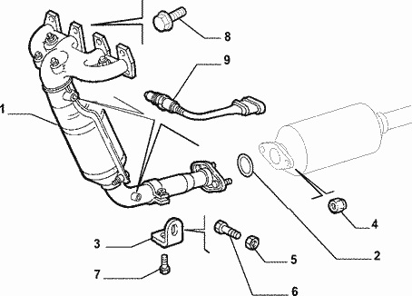

attachment.php
As you can see from above this model has two sensors, and from eper, it seems they are both the same.

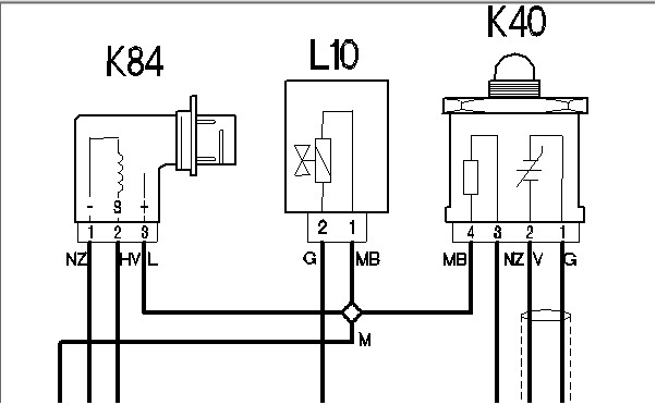

looking at the following electrical circuit:
attachment.php
where K40 is one of the sensors, it seems the sensor is made up of a resistor, which im guessing changes with temperature, and another component, which looks like a heat sensitive capacitor or thermocouple.

Ah, google and youtube are our friends!
It seems that these are heated sensors. pins 3&4 are heating elements, resistors that heat up to over 300 degrees believe it or not. Their resistance does change with temp, but this is a by product if you like. they should be around the 7 ohm mark at 20 degrees C or there abouts.
pins 1&2 are joined to a variable power source, a thermocouple that gives of an AC signal when heated, but only a few hundred millivolts, in the region of 500 to 1000mV (0.5 to 1.0V under load)
So it looks like im going to have to try and find either a really good voltmeter or an oscillioscope to check these two sensors out.
Just when i had ruled them out too!
