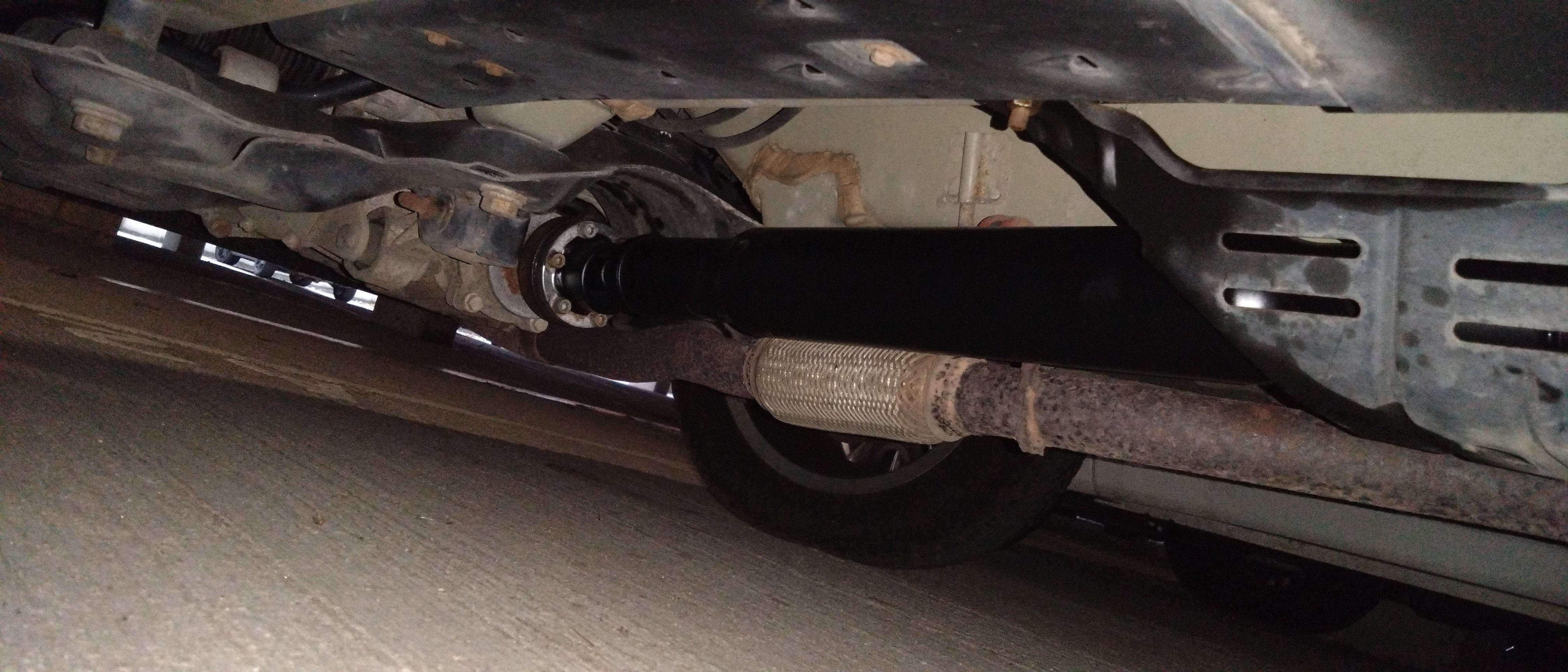

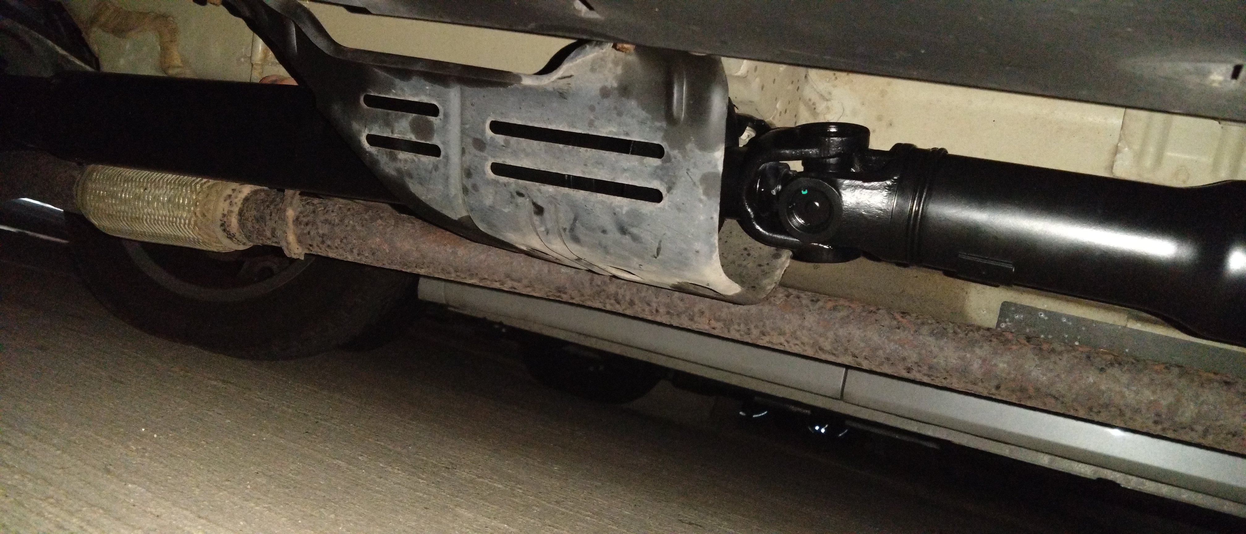

All back up and running. Ran 2wd for a week then got new propshaft from Vantastic on bay.
Thanks for all input
