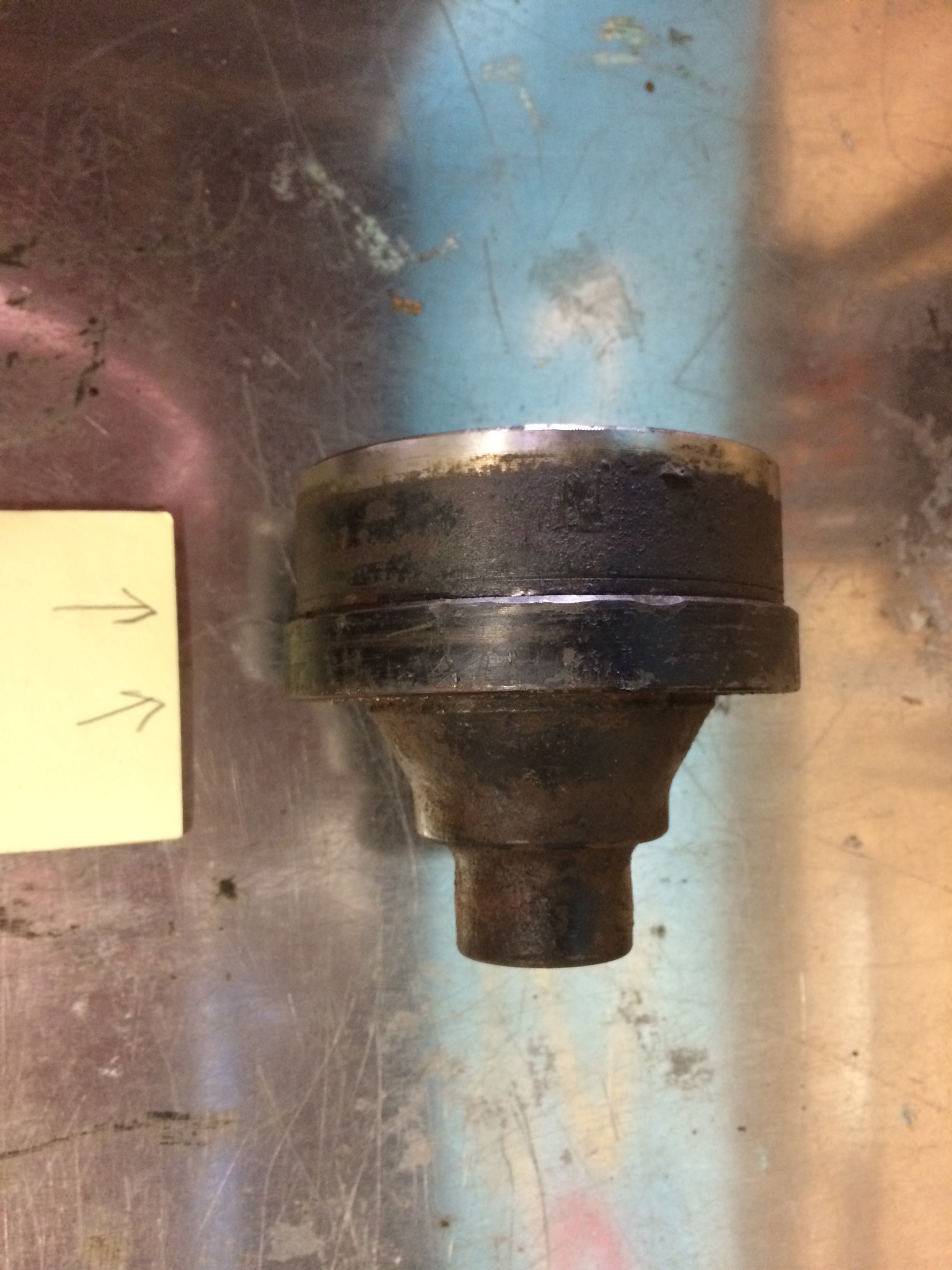

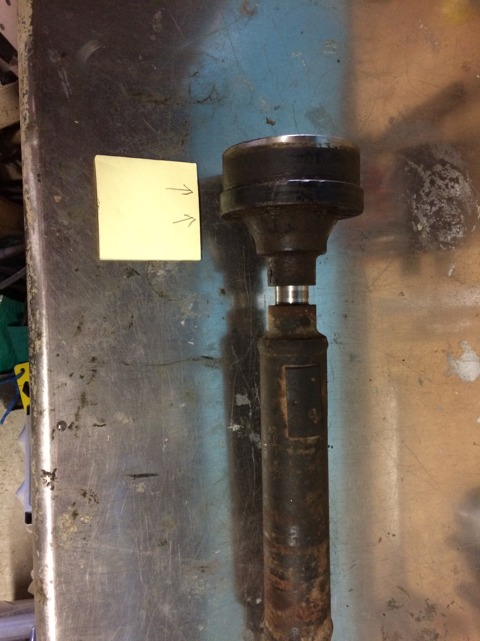

A quick question for you 4x4 experts. I'm in the process of replacing the 2 CV joints at the front of the propshaft but the rear one won't separate. Hopefully the attached pic will explain. Any ideas how to separate them? I've tried a gear puller but there's not enough purchase on the inner lip. Thanks, Chris.

A few taps to the side of the CV joint should be enough to free the two parts. Which the shaft fully assembled you can add some tension by pulling the front section away as you hit.
I have taken apart quite a few and have never needed to resort to any sort of puller or press to remove the CV joints. Also I hope you have marked all the components in relation to each other otherwise you will need to have it rebalanced when it is reassembled.
