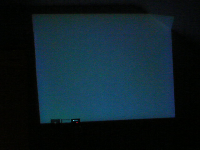

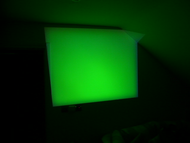

Ok here are 2 images, first is from the good projector, second from dodgy one. They're both projecting a black powerpoint slide!
The green is accentuated a little by my camera but you get the idea.
Looks like it could be a problem with the green lcd of one of the projectors!
Yep, you've got a faulty lcd panel, probably the blue or red as you are seeing green. Can be quite an expensive fix.
surely if the image should be black, then the red and blue are working ok, its just the green panel which is letting light bleed through?
not if its stuck in the "off" state... letting 100% green thru. Lcd "usualy" work backwards to the way you think... no power is 100 off (lcd screen with no power to RGB will "usualy" make a white screen)
Ah, so it could just be a dodgy connection? Although i doubt this as its a haze rather than the whole image being green (as it looks on the photo!)
