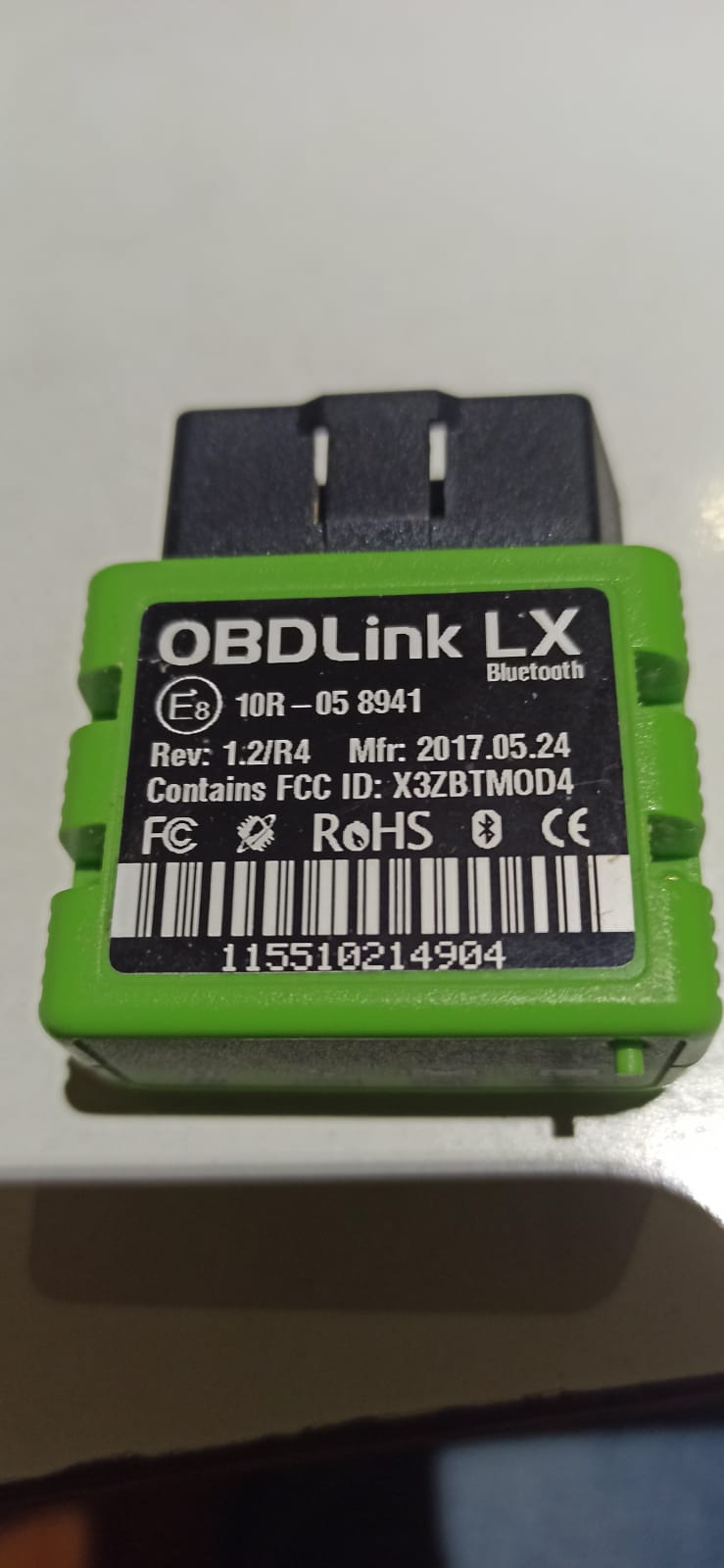

Hi everyone, I have a 2004 camper on Ducato X244 2.8Jtd.
If I put my Obd2 ObdLink Lx reader in the camper's Obd2 socket with any app I use, the data is wrong.
For example, with the engine idling it gives me 4,000 rpm and more.
Probably the pinning is different. Is there an adapter to put between the socket and the reader that solves this conflict?
Or can I do something else?
Thanks
