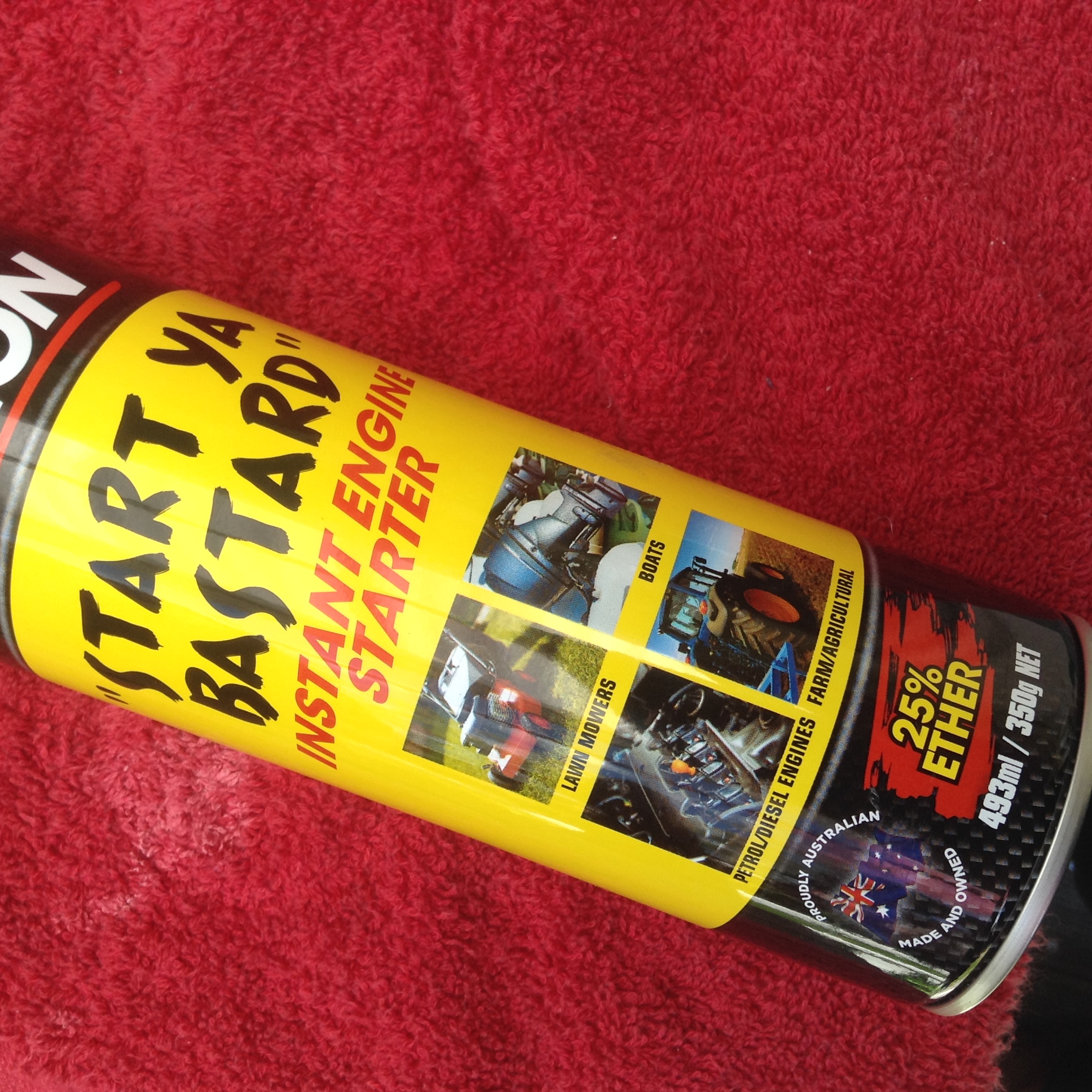

So is that running a twin spark coil? Did you remove the distributor when the engine was out? I would have thought that you would have at least got the odd pop out of the exhaust. You might need some of this !
