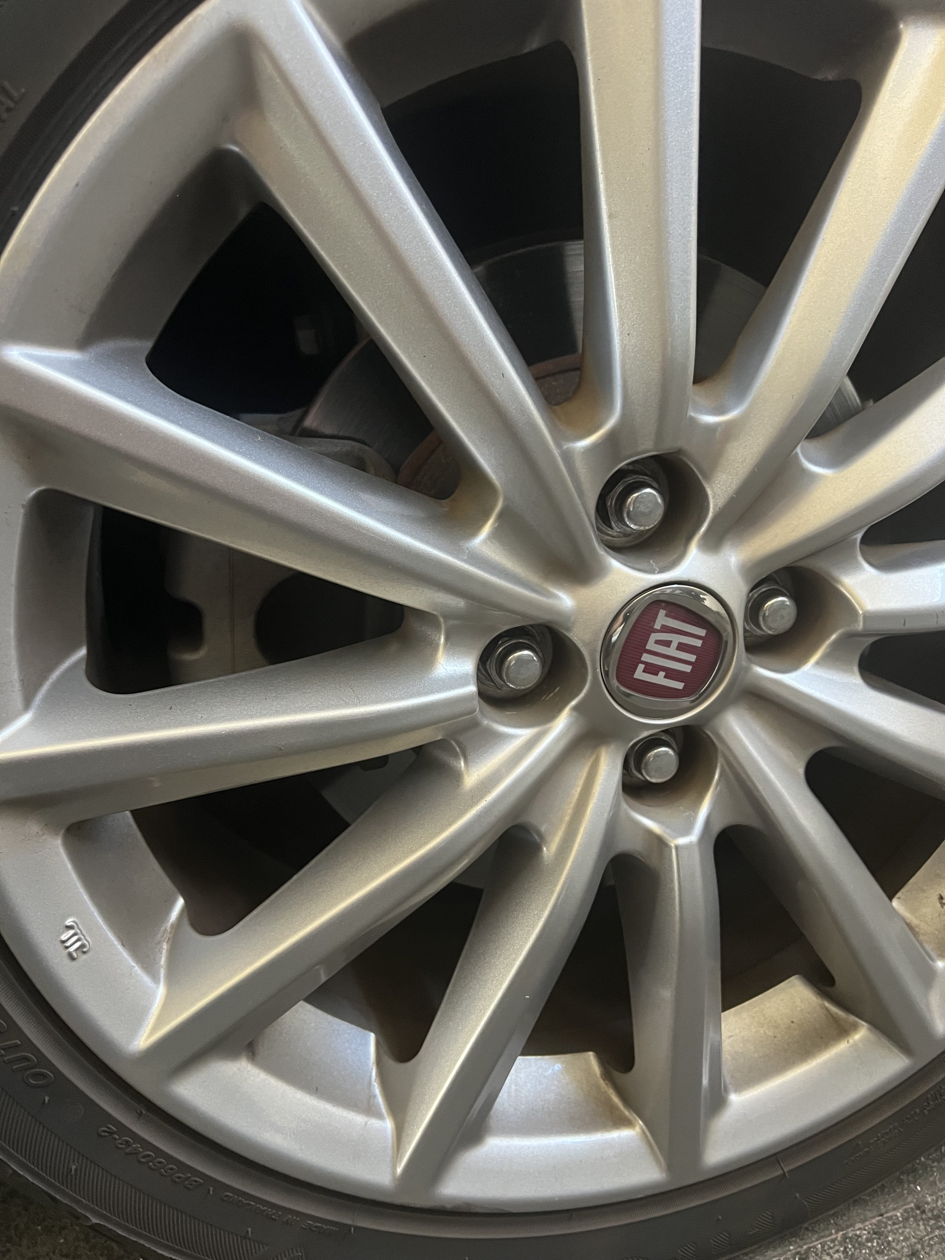

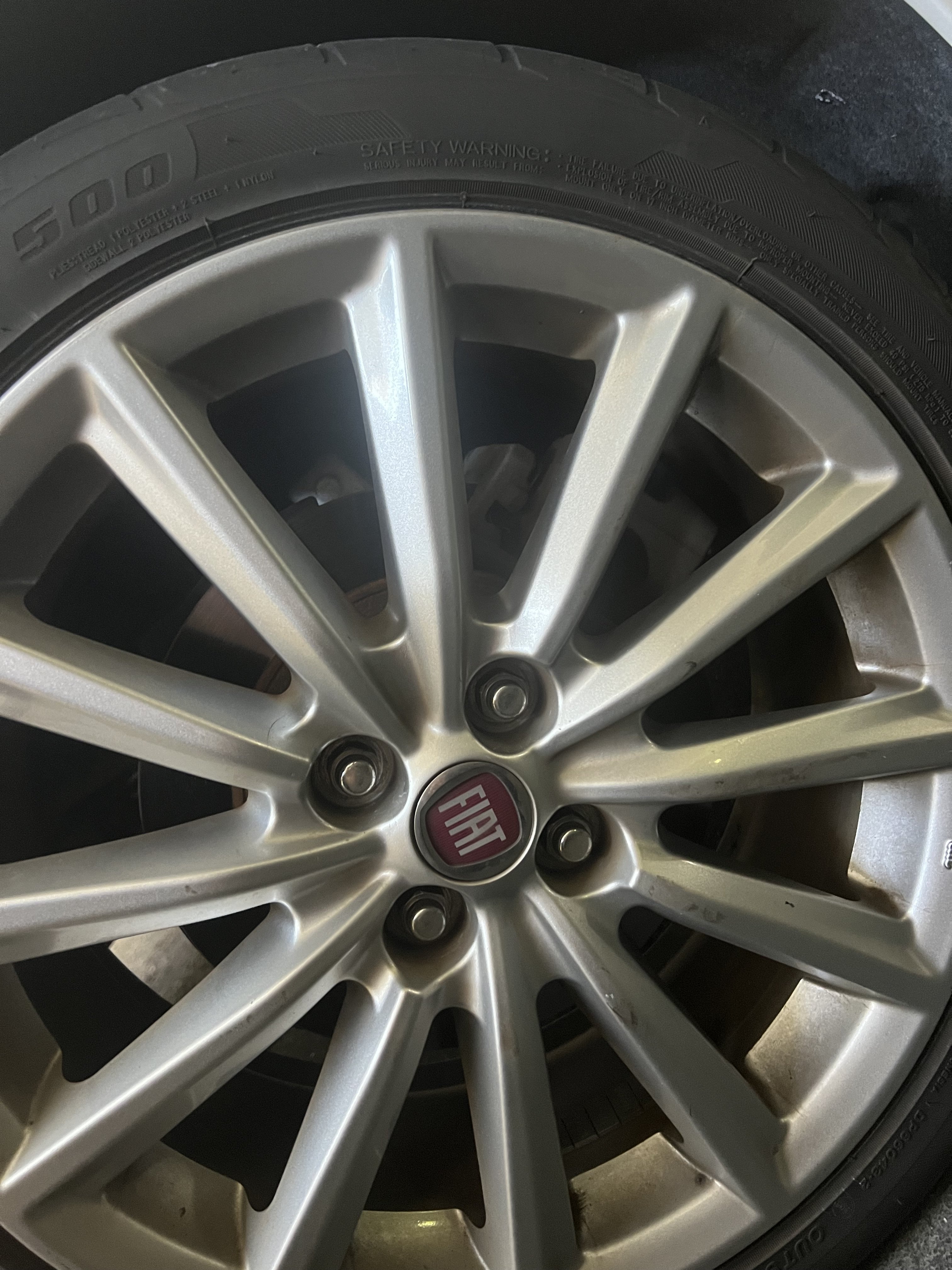

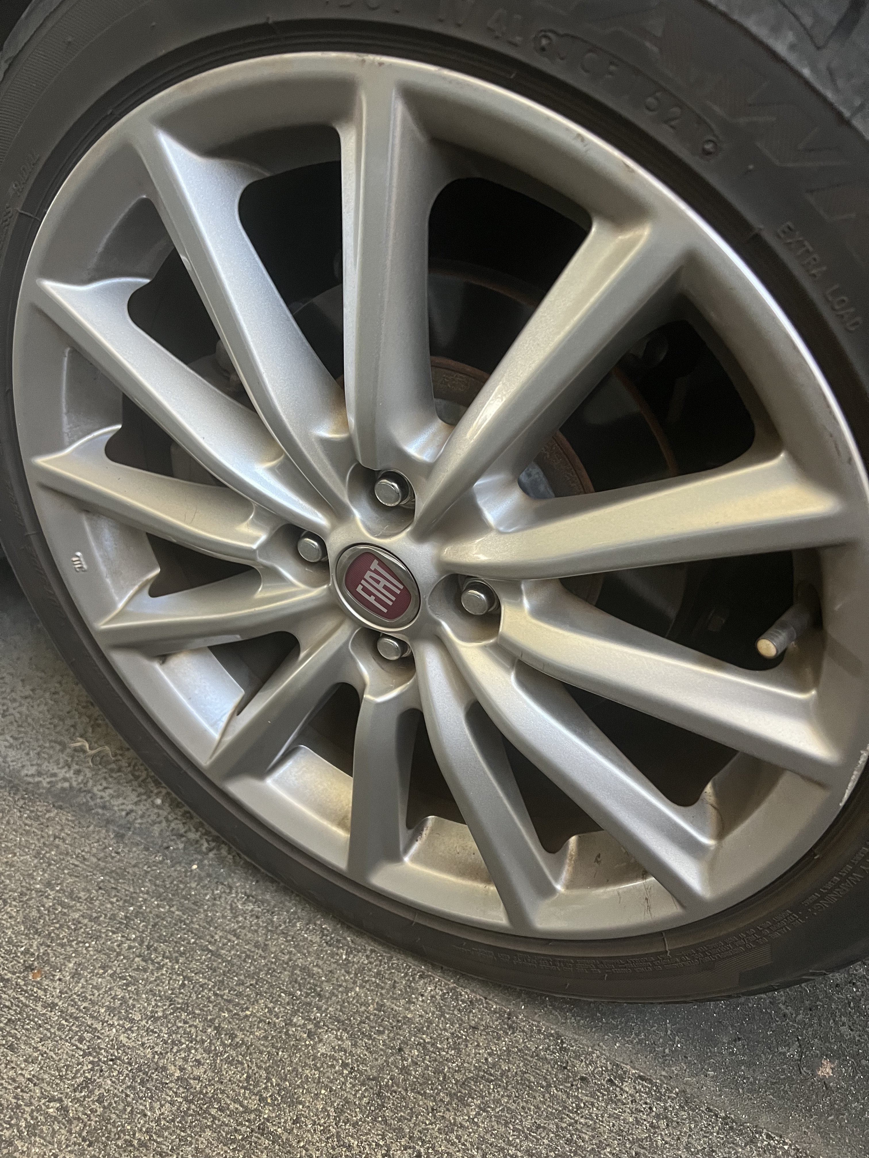

Thank you for responding! I have some videos now and it seems to only be making the noise when my foot is on the brake and under 25 mph.
I’ve never used the handbrake before. I’ll attach some pictures of my rear calipers as well. In one of the videos I attached it sounds like the noise happens every tire rotation, if that makes sense.
I will definitely go to a fast fit depot instead of a fiat dealership! Thank you for that helpful tip.
As far as I can see from the photos it looks like at least one brake disc is rusty not shiny as though in normal working order, if that is the case and when compared with the front brake discs that they are not shiny this probably means replacing both back brake discs as a pair.
The noise to me sounds like either the brake caliper is loose or the sliders badly worn or the brake pads are very loose/worn in the calipers.
I know it is not much comfort , but I suspect the car may need re brake calipers, brake pads and discs both sides.
When driving would you say the sound was definitely coming from the back, also can you get a similar noise just using the hand brake.
Another clue may be longer handbrake travel and hard to hold the car on the handbrake when parking on a steep hill.
