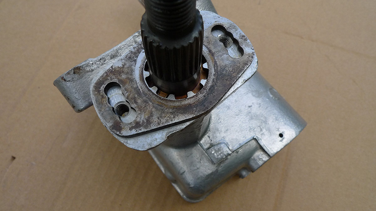

Hi folks,
There's some play in the steering wheel that I can't seem to get rid of. I recently replaced/overhauled all of the steering components including the steering box.
I've adjusted the serrated plate on the bottom of the box so as to adjust the eccentric bush to move the sector on top of the drop arm closer to the worm screw. My serrated plate has two bolt holes. If you recall, the serrated plate has 4 "settings." At one particular setting, the movement is nice and easy but results in play in the steering wheel. If I rotate the plate to the next setting, the components start binding and the wheel takes effort to turn.
I guess I could file out the notches in the serrated plate so that I could set the adjustment between the two settings but I thought I'd ask you guys first.
I've also tried turned the eccentric bush in the opposite direction but I run into the same problem.

If you are binding, put it back to the previous position and try adjusting the end screw of the worm gear. You do this by removing the split pin. You'll probably need to make up a tool to do this and it's usually very stiff at first.
If this doesn't give you enough, then you can adjust the height of the pitman arm gear with the adjustment screw on top of the box. This has limited movement, and I recall you need shims to adjust further.
Remember that if you adjust one axis it pays to go back to the other two and adjust to get a good mesh. So after you adjust the worm gear go back to your original pitman arm angle adjustment as this has likely been adjusted to it max position etc.
Also remember that there will always be a few degrees of play in these gears, especially worn ones ;)
cheers, Steve
