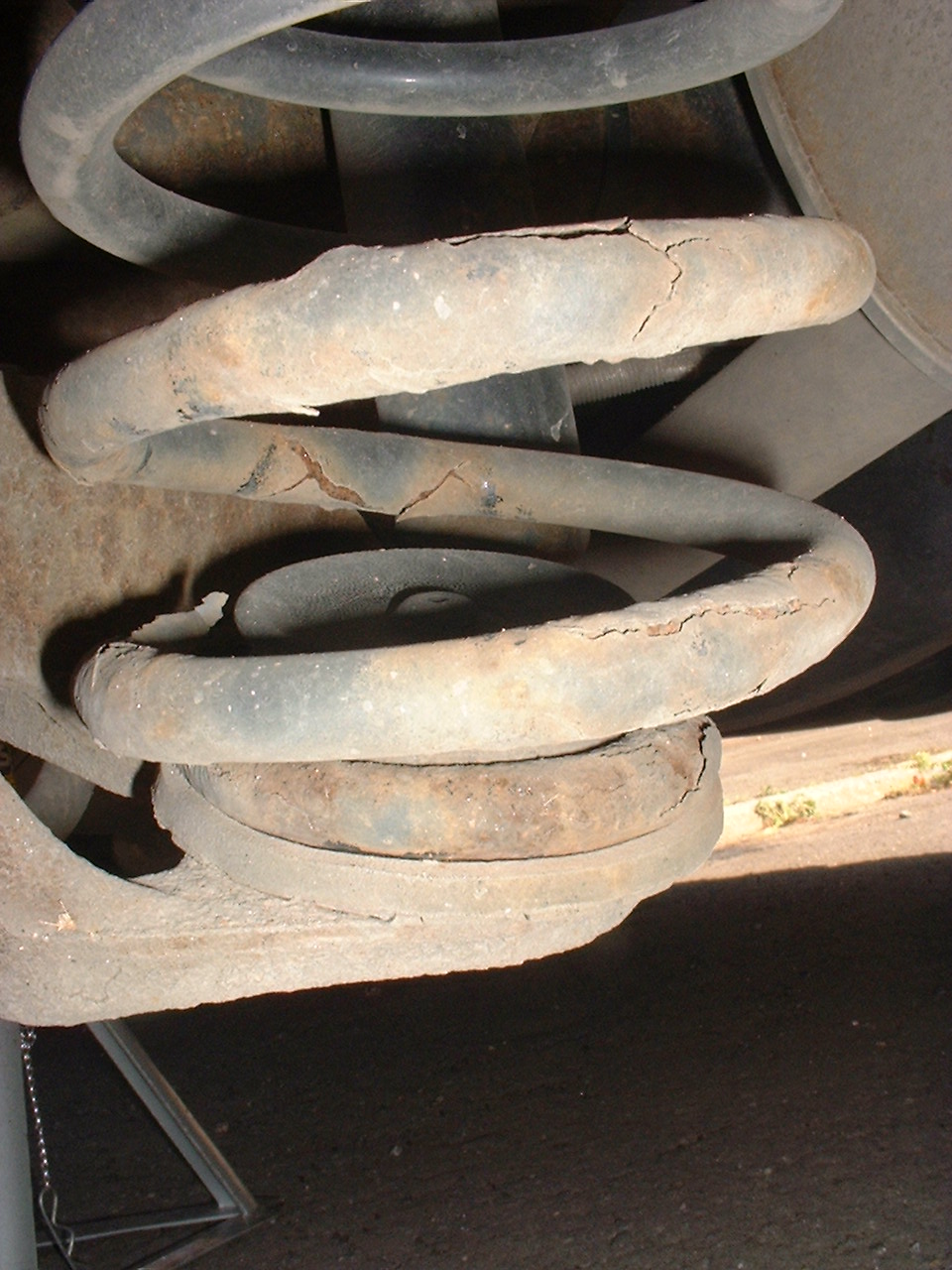

The left hand rear spring is a bit corroded too.
Does this look ok, or will it need replacing ?

The left hand rear spring is a bit corroded too. Does this look ok, or will it need replacing ?

but what about the condition of the spring ?

My frog passed it's MOT last week, and the springs were more corroded than that. It seems to be a mixture of 2 things, first is personal opinion of the tester, how he feels, past experience etc and secondly, it's a hard life for a spring, they sit in the water and salt, they move so the paint cracks and moves, and then slowly corrode. For your peace of mind you could wire brush them and put waxoyl on them to prolong their life, like I will be doing tonight.
I hope this puts your mind at slight rest.

He was happy with the spring.
