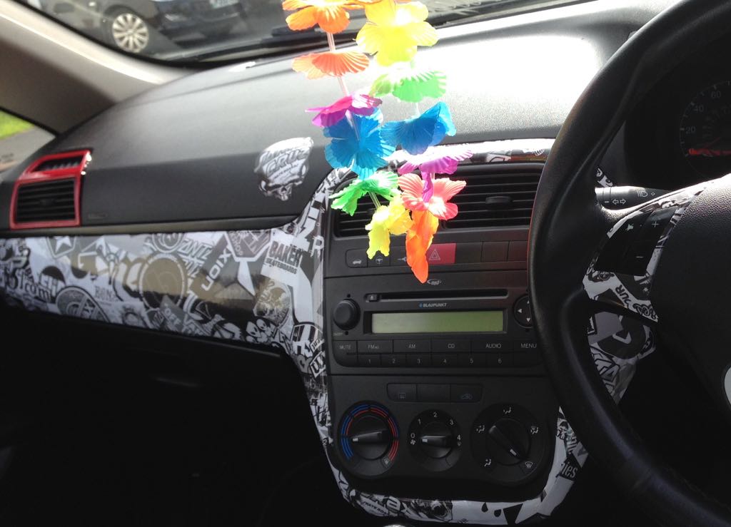

Nice job! I vinyled mine but it looks like this would have been a better idea.

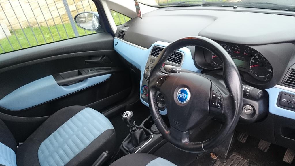

Love that blue vibe going on there, looks epic! Was it a lot of work to do that across the car?
Just noticed my dashboard console is actually grey not black... What other colour options were there when it was new?
Sent from my iPhone using FIAT Forum

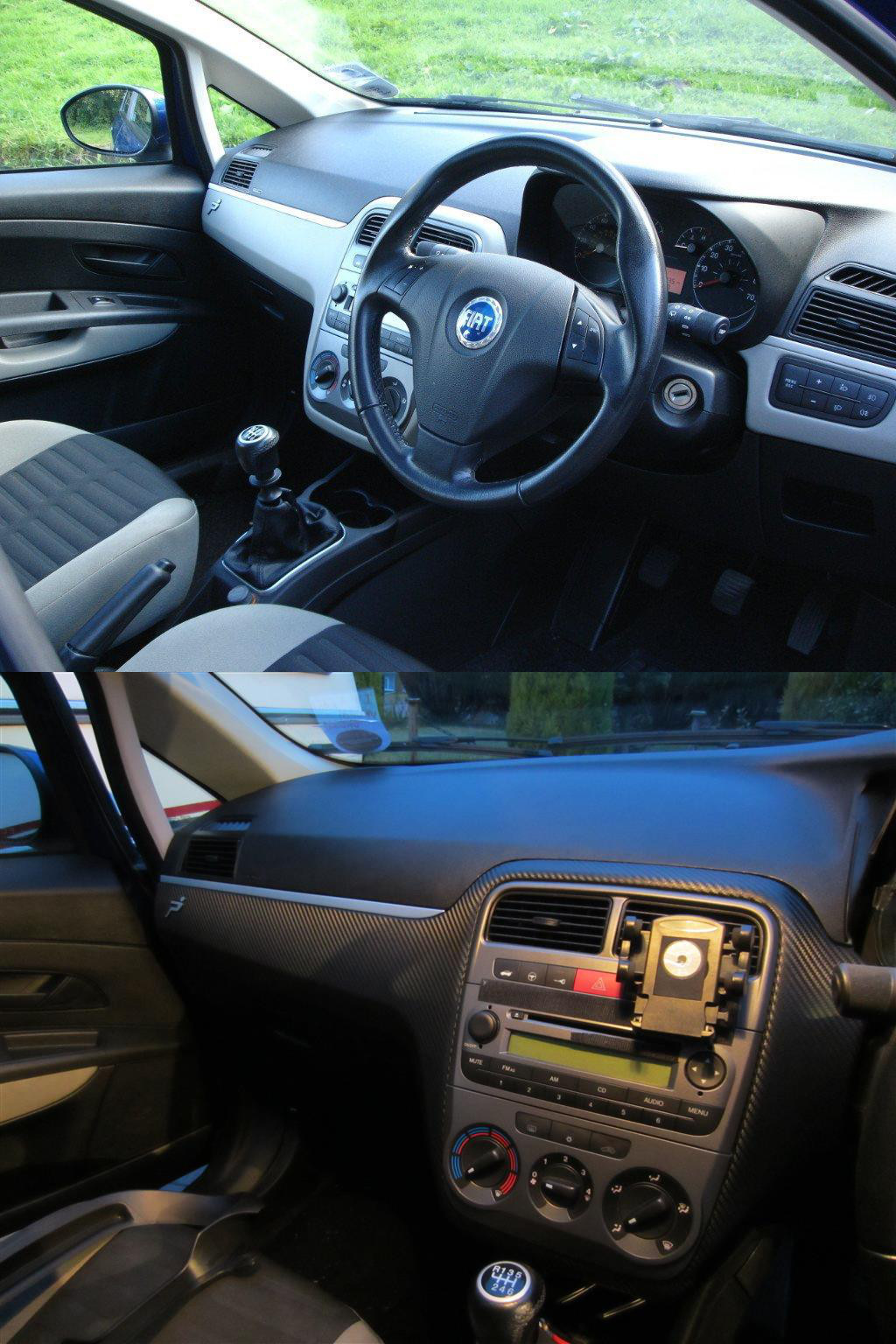

The blue was actually a factory option between 2006-2008, I think the choice was either that or the more common beige (with beige door card and beige seats). Both horrible colour choices in my opinion. Only the Sporting got a dark-grey interior which I think was rolled out to all models between 2008-2010, with 08-10 Sportings upgraded to carbon fibre style.
Mine was beige but I carbon vinyl'ed it to give it the 2008-2010 look.
